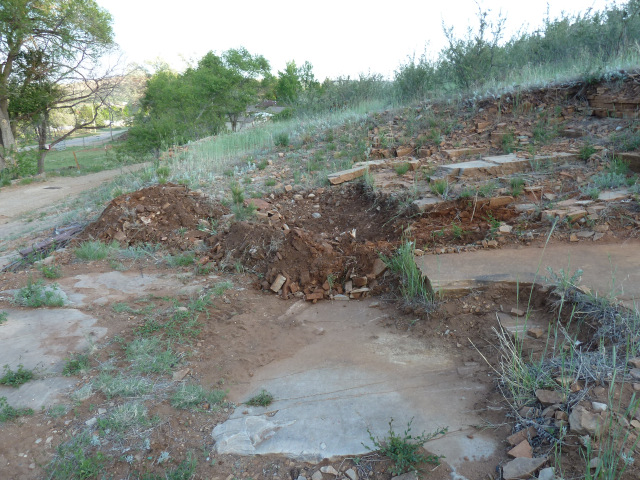

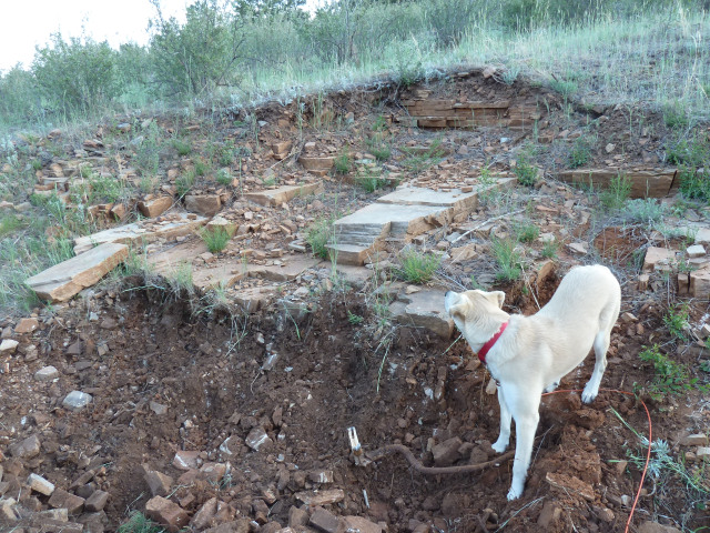

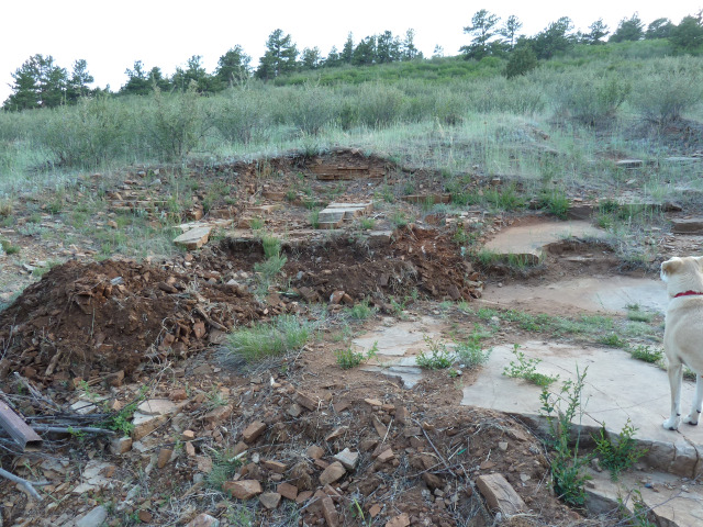

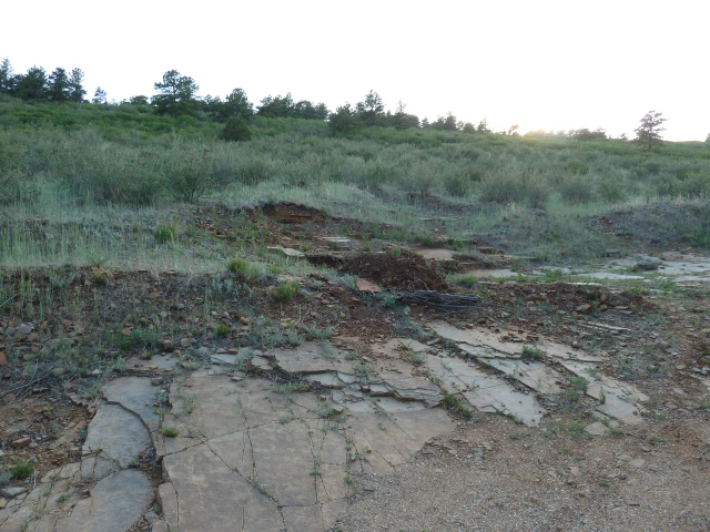

Just wanted to give a "thanks" to all for the input. It shows that there is a range of what people do/recommend. This makes sense.
One of the best things I've learned (from this and other threads, and from working on the backhoe) is that technique makes a lot of difference in how much and what kind of stress you put on the tractor. I seem to get a lot better each time I use the backhoe a couple hours. I saw a video of one guy lifting and dropping his FEL/tractor (with a bang!) with every backhoe pull at a stump - that just looked like a BAD idea! Due to bad technique.
I've attached pics to show some of the ground I am on; solid sandstone layers that have a slight curve to them.. a mini-quarry (aka our backyard :) ), with differing slopes between where the back wheels sit, and where the FEL sits (and no "give" to the ground). I'm taking the top layer of dirt/loose rock off some of this ground. I also want to pry up a some thick sandstone slabs for use around the property (I figure if I can do this with a pick and bar, it should be fine to do with tractor/backhoe, and a lot easier on my body! :laughing: ).
