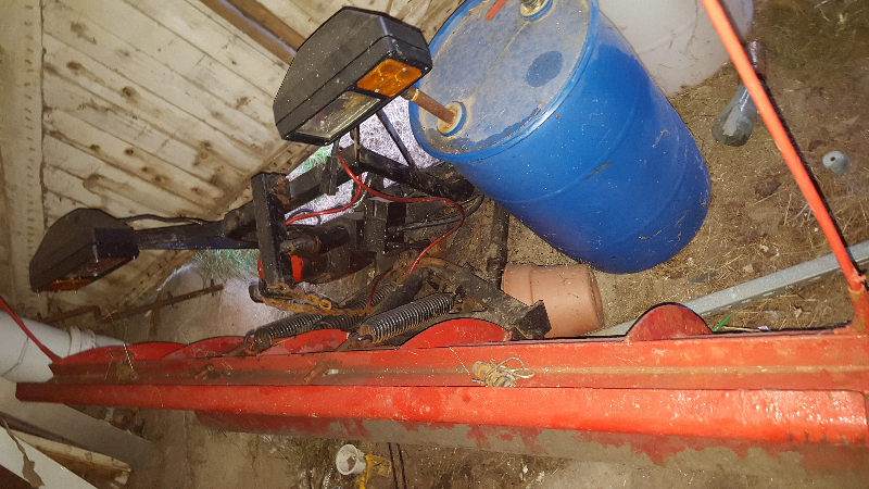

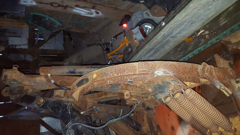

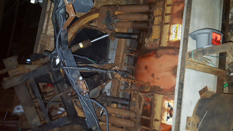

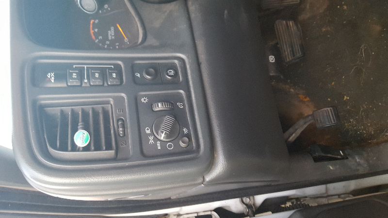

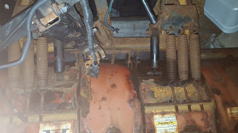

OK first thing first... I know this is probably the wrong category but you guys have lots of knowledge at what I need.
I got a 05 2500 duramax for plowing. I'm going into the business. I am right now with the truck and 2 plows for it. I'm looking at putting a headache rack on with lights and lights near the tailgate
This is what I need-
Best type of lights
How to turn the lights on
Flashing light
I am looking at putting $1200 into the truck but this budget is $500 max
Any ideas? ?
