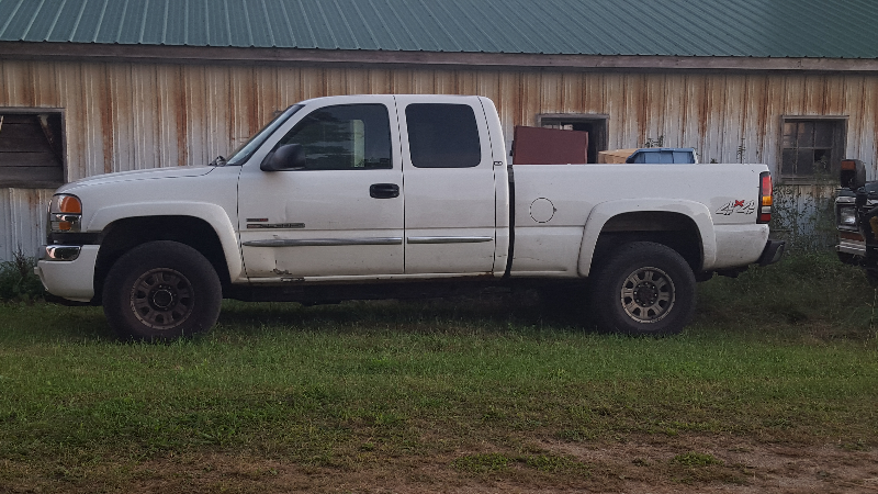

This is the truck. And the fog light switch

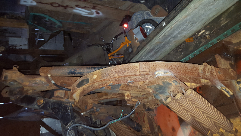

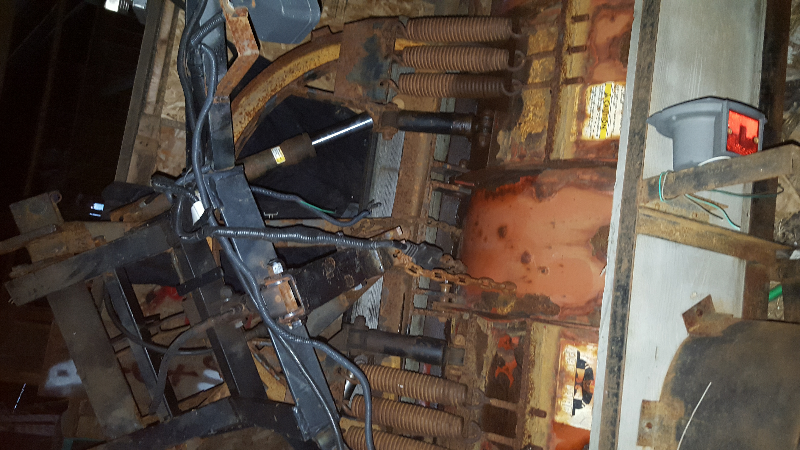

This is the little 7.5ft plow
This is the 10ft plow. Yes it is heavy but not nothing more then 700-800lb maybe 850lb.
