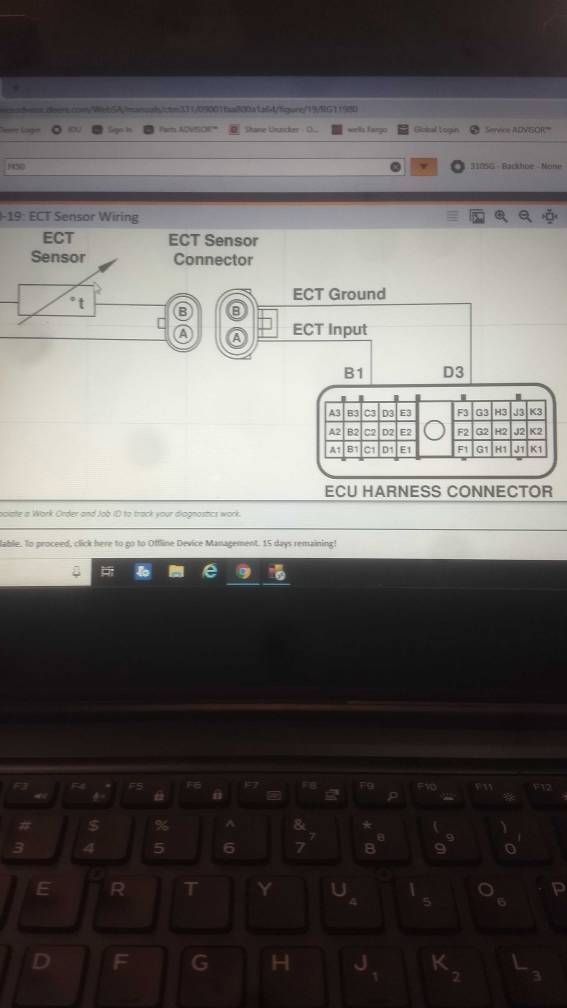

OK, an update just to satisfy any curious readers. The JD tech came up in his magic service truck and found the old ECU was bad but gauge panel was good. Thermostat and sensor also good. So the 310 got a new generation ECU put in and programmed. Plus a new main hydraulic feed hose, filter, and hyd. oil. Tech said it was just about the nicest old SG he had ever seen & a definite keeper. I think so too.
The new ECU works, new hose doesn't leak, and overall good time was had by all. Everything else works good; it needs nothing. The old 310 even seems to run even better than before if that is possible. A good visit by the mobile service tech.
I do plan someday to make up a patch cord - if I can find the proper connectors - and move the ECU away from the engine compartment and into the cab.

Good to hear!!! Had many service call that sounded the same as this one was. Glad to see it's fixed.
In regards to the relocation of the ECU I'd be careful with that. The CAN wires are very touchy with any added resistance from splices. I'd leave it where it is. If anything just move it to the left side frame rail off the engine and vibration.

Thanks for that warning. I'll reconsider. Yes, this is a later model 310SG with the ECU is mounted on the outside of the left side frame rail.
So are you saying that earlier in the 310SG model run they mounted the ECU on the engine!?
Where it is now does look like a decent mounting position, but something caused it to fail....and that made me think that in the cab would be better yet. Part of that thought was because scuttlebutt is there is/was a harness kit available from JD to move the ECU to the cab? Does anyone ever do that?
Heeding your warning, I'll probably leave it as is. If the new one lasts another 5K hrs. I'm pretty satisfied...
