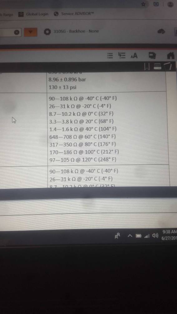

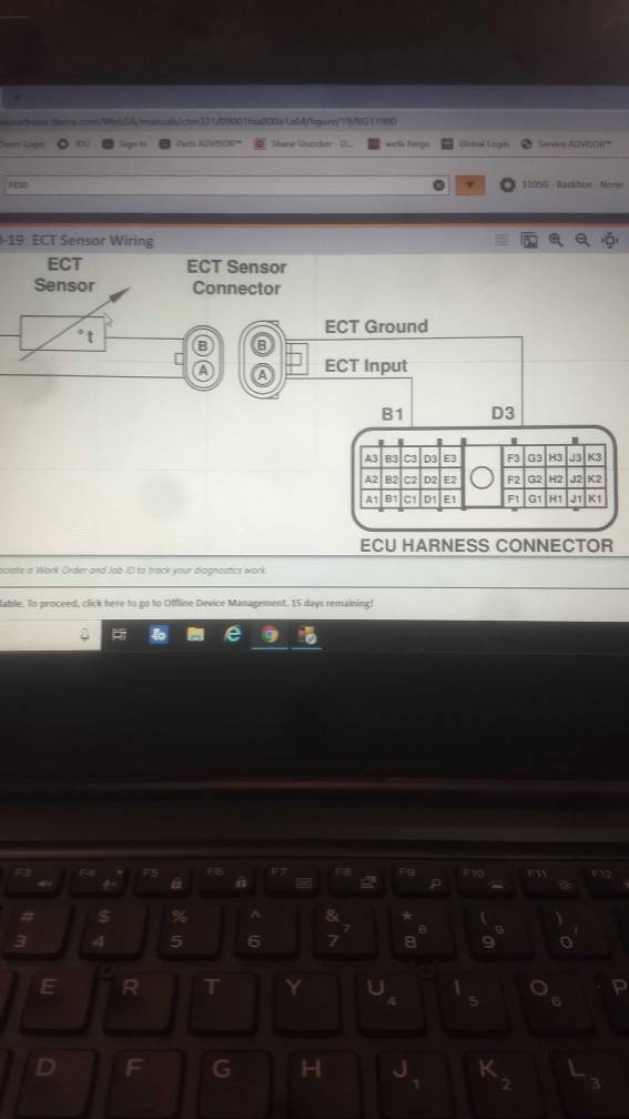

Check continuity on B1 ecu connector and terminal A of the cool temp sensor. And D3 ECU and B of temp sensor connector. Should have close to zero ohms. Please don't force DVOM leads in the terminals of any connectors. It is very easy to do if you don't have the right test leads. And don't over torque the 1/4 is boot that holds the connector on the ECU itself. 1561646401867.jpeg1561646533713.jpeg

If those wires and terminal are good. The ECU is bad

Good info, thanks. So to check...., I'll take the ecu off the block, remove the end connectors (1/4" bolt) and check between the inside of the ecu connector and the other end of the harness where it plugs into the sensor. Correct?
