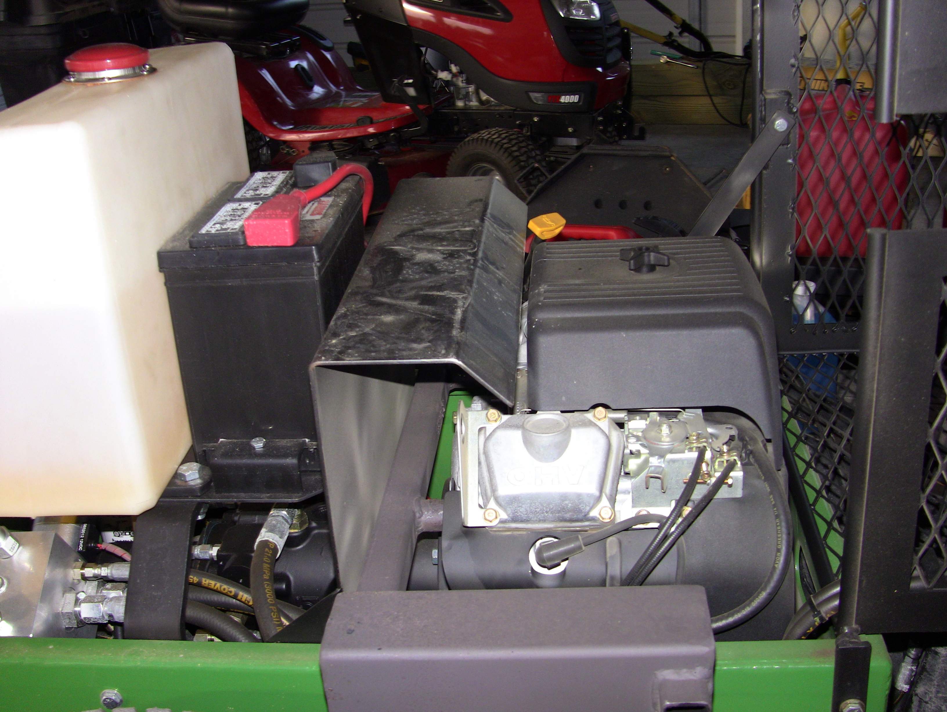

/ Service bulletin for improving Robin engine starting #5
Actually said:
Tim,
The battery that came with my new PT 425 is 2/3 size of a car battery-- should be sufficient and easier to fit. See photo.
/ Service bulletin for improving Robin engine starting #6
I put an Optima yellow top in mine. It's the same size that fits some Hondas. 450CCA. I keep it on a float charge. This will help.
/ Service bulletin for improving Robin engine starting #7
My PT425 has a Honda car size battery - maybe a Group 41 if I remember right. There is no other common automotive battery size that will fit the narrow space. I've looked at the higher tech batteries such as Optimus, but I haven't found a higher capacity battery that will drop in. I replaced the OE Chinese cheapie with a higher quality NAPA battery, but it didn't make much difference.
Heavier gauge cables might help a bit, especially if the negative cable attached directly to the starter mounting bolt.
