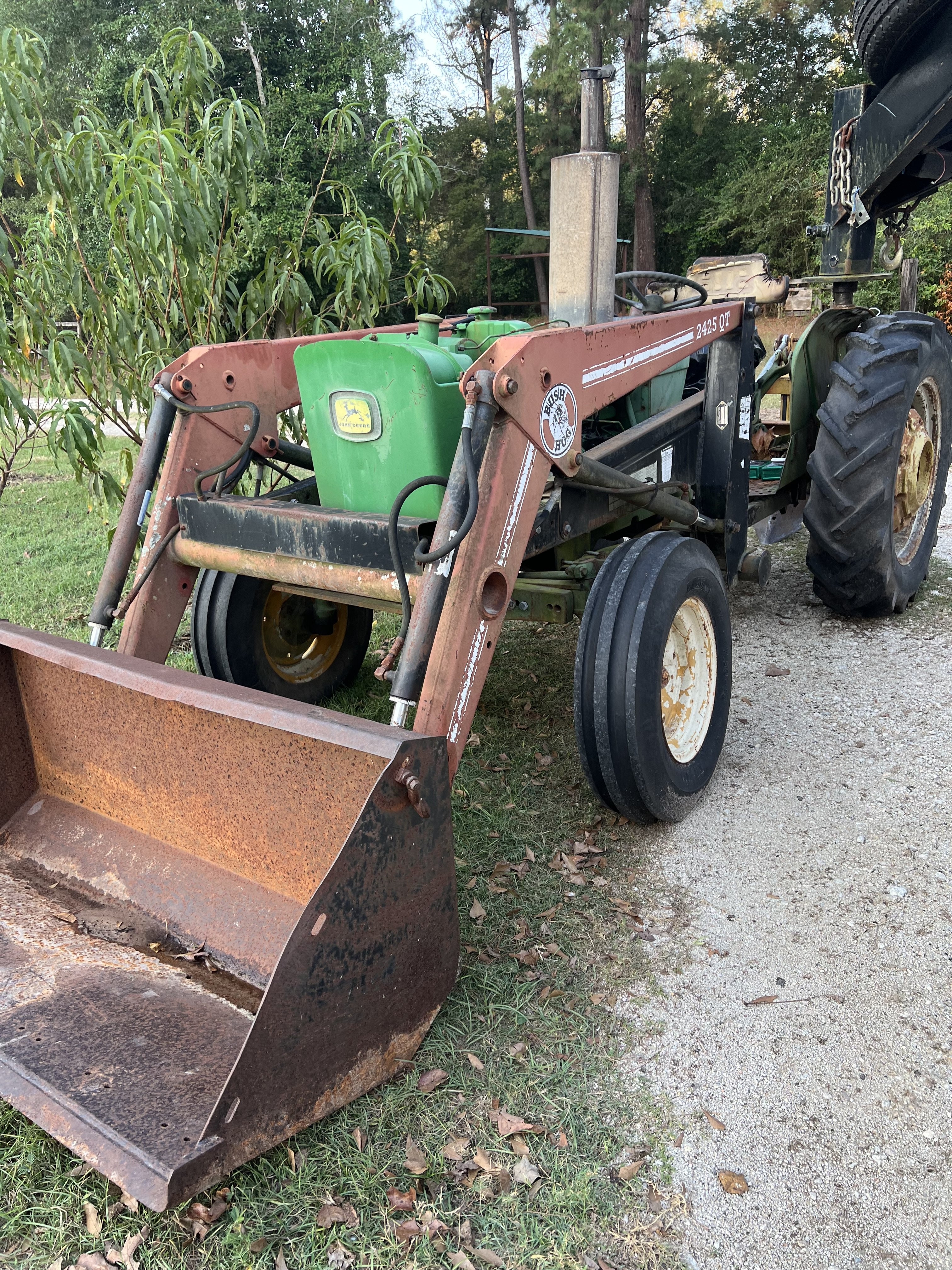

I've recently acquired an old JD Tractor from an extended family member who's dad (the previous owner) passed a few weeks ago. Having a hard time decoding exactly which model it is since it has no hood. I do have a picture of the serial number, but no luck in decoding the Model. It is diesel powered with a Bush Hog 2425QT loader attached.
Picture of plate
Could someone give me a hand and inform me of what model it is?

This is the only one I have at the moment. The tractor is still up on his farm about 1-1/2 hours away. I inspected it briefly after the funeral, and am awaiting a good time to go get it.

There haven't been that many Deere's lacking a front grille, so that's your clue. Trouble is, that one doesn't look like any of those I know (eg. 2510, 4040, etc.).
/ Serial Number Decoding #5
Your tractor appears to be a 1968 model 1020.

I'm steering towards a 1520 or 2020. Serial number, from what I can see, indicates it as a 1968 2020. I only got brief look at it and for the life of me do not remember how many cylinders I saw.

Also think a JD 1020 from Dubuque and pic confirms it is a 1020, to me. 4 cylinder diesel. Curious if that is a molded weight added ahead of the grill.

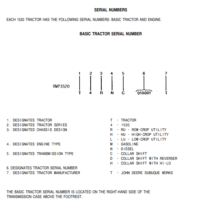

Explanation of 1520 serial# tag is shown below. I'm guessing that tractor in your post has a 3 cyl not 4 cyl engine.

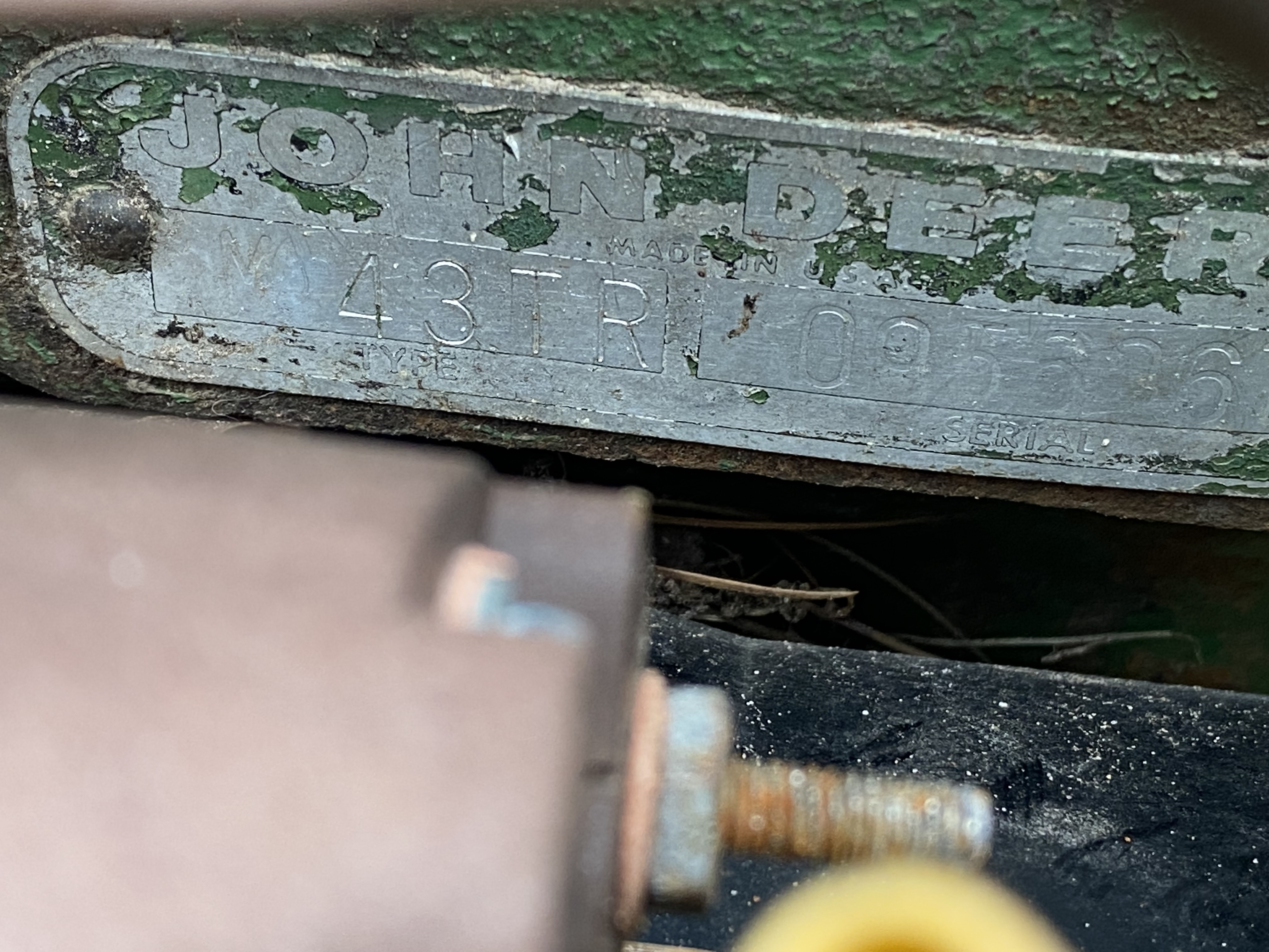

A little update…here’s the motor data tag

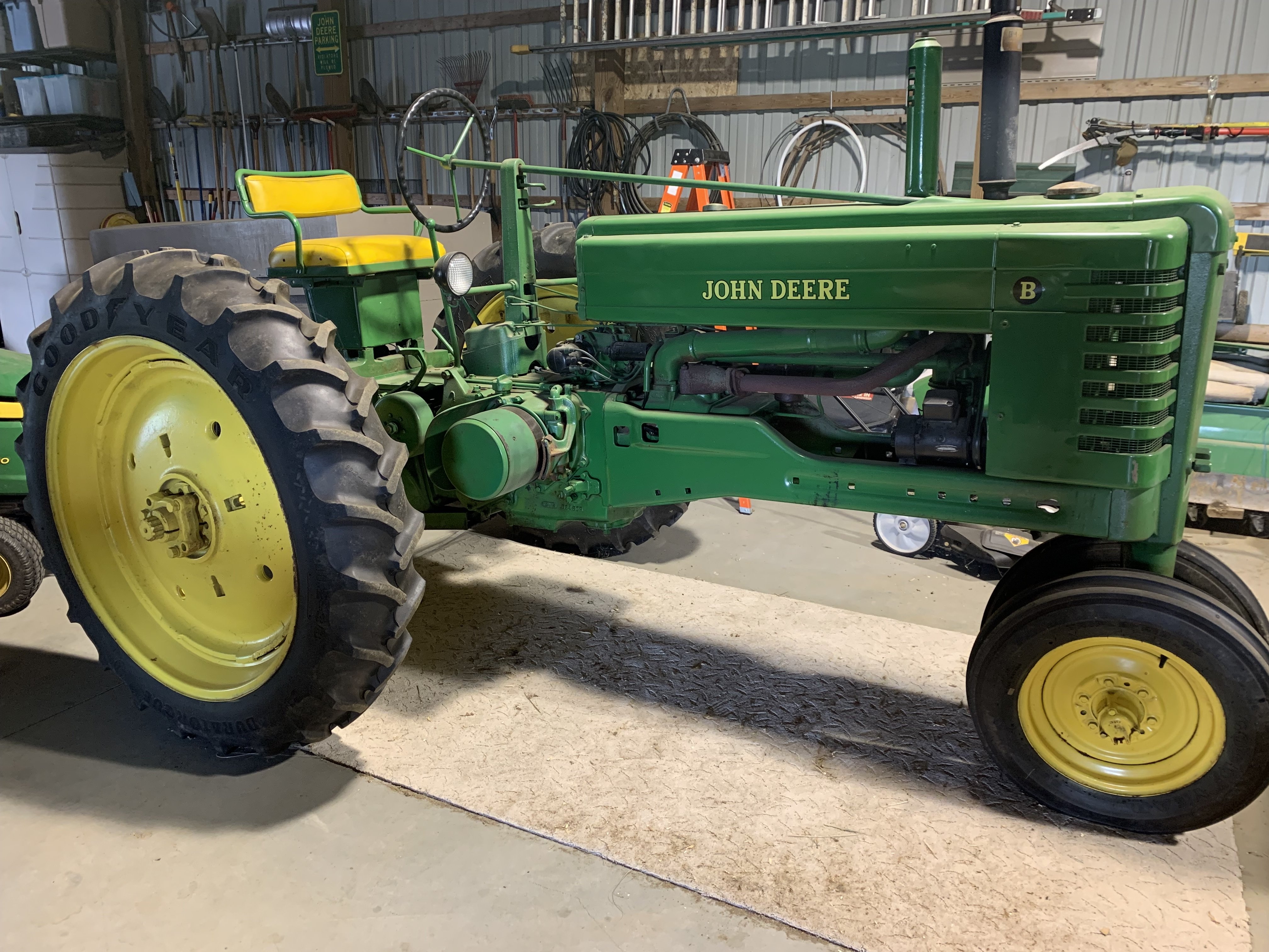

Congratulations on being able to figure it out. I have a JD B that we believe is a 1954. The SN tag was painted when they restored the tractor. I can’t figure out what the SN tag says and we’ve tried quite a few things to remove the paint so we can see it - so far, it hasn’t been successful.
/ Serial Number Decoding #14
You have a very nice appearing model "B". JD B is definitely not a '54 as last model manufactured was a '52. Model 50 replaced model B.

So, then this is an older tractor than what I was originally told. The tractor was my Father’s Uncle’s tractor that his daughter had refinished and I purchased it to keep it in the family (I can still remember when I was little and I could stand in the tires).
I’d love to get a serial # authentication through JD if I could figure out what it is.
