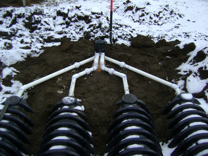

Should I go with a Distribution Box or the installer offered an alternative that doesn't use a D-Box but just feeds directly into the leach fields first line?
I am leaning towards a D-Box since it distributes the waste evenly among all 4 leach field lines, instead of just feeding 1 field and then overflowing into the 2nd field.
D-box. No question. Distribute the load evenly. Give the soil a better chance to keep up with the load, rather than wait for one to get overloaded, then overflow.
When I replaced mine a couple of years ago, I added a 4" PVC pipe up to the surface, topped with a clean-out. Now I can inspect, add chemicals, or whatever, as needed.
The other question is in regards to the backfill over the infiltrator chambers. It can be native soil (which is rocky and silty). I am considering putting down washed 3/4" gravel over the chambers which will help prevent silt from getting into the chambers.
No it won't. It will just slow it down, a bit. Only a bit. I'm currently putting in a French drain which connects to a recently installed French drain on my neighbor's property. It was put in by a ... not very good contractor who didn't use any filter cloth under the gravel, just some Cheapo weed barrier on top. That "drain" has been in place all of two, maybe three months, and when we opened it up to make the connection, we found the gravel is already well-infiltrated with silt.
And it's been pretty dry here until the last few days!
I will also put down landscape fabric/geotextile OVER the chamber tops prior to backfilling to also help with preventing silt from getting into the chambers.
That might help, but I'm not sure even that is needed. If you are going to do it, though, get the good stuff. 3.5 to 4 oz, not the weed barrier junk you get at the home store.
