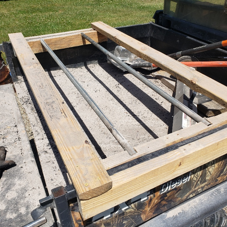

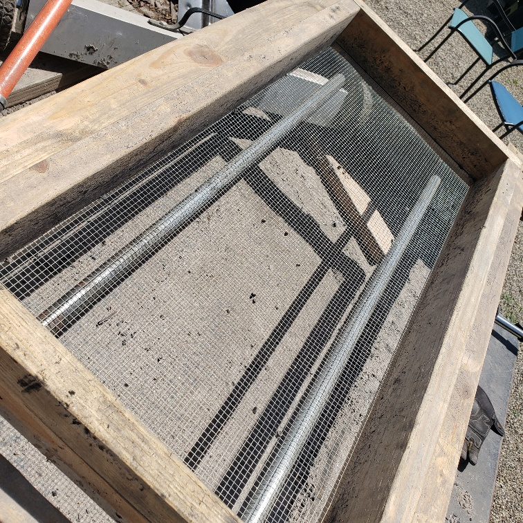

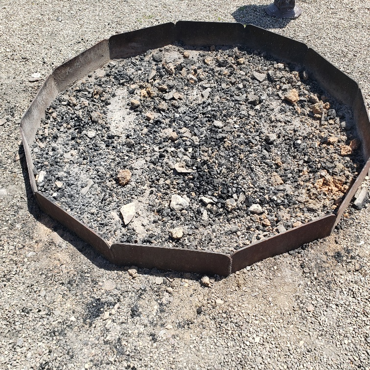

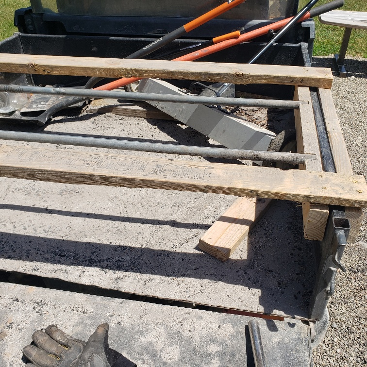

We have tons of bonfires and they usually involve pallets which means a ton of ash and nails in the fire pit. I wanted to try this and see if I could keep the ash as long as it wasn't much effort to remove the nails. The fire ring is built for standard pallets to help contain the mess. I built the whole thing with stuff I had from pallets and an old garage door torsion tube. I did have to buy a piece of 1/4" hardware cloth for the screen.

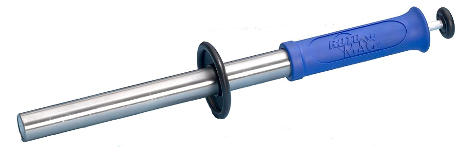

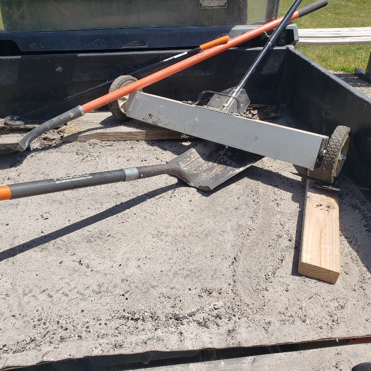

You basically shovel, shake, remove nails with a magnetic wand, and put the charcoal back in the pit. The next process was taking shovels of ash and passing the shovel under my magnetic floor sweeper as a final check for any rogue nails. The nails fly up and stick to the rake right through the ash. The magnets I have just from working with metal in the shop. Doubling and offsetting the screen may reduce the amount that made it through the first sift, but I would probably want second pass anyway just to be sure. I already run the rake around the pit to try and keep any stray nails out of the path of feet and did that when done in case anything fell off when going from pit to sifter.
I ended up with two tubs of clean ash and about 35+lbs of nails. This was a very easy process and didn't take too much time to do.
I made the frame to fit the RTV so it would slide forward/backward but not move much side to side. The tube works really well when sifting as the sifting box slides very easily and nothing gets caught on the round bar.

Yes. I will be using the final product in plots and some other plantings around the house. This is why it needs to be 100% nail free. It will get added to what we burn inside the house that never sees nails or anything other than clean firewood. I have also heard of people using old pillow cases to help remove the nails from the magnet which seems like it would work well. The wand grabs the nails and then you just pull up on the plunger and everything falls off and repeat. Wouldn't have bought that for this project, but it is easy if you have one.

I am definitely going to add a second or third layer of screen and try to offset them to catch more nails in the first sift. Smaller nails will go through the 1/4" cloth. Most framing nails size will get stuck as the head is too large to pass, but you do find many nails hanging through the cloth by the head. I would feel much more comfortable if the second sift was purely for insurance and I found next to no nails. I ordered a 50' roll as it is a few bucks more than a 5' piece at home depot, so I can play until I get it right.
