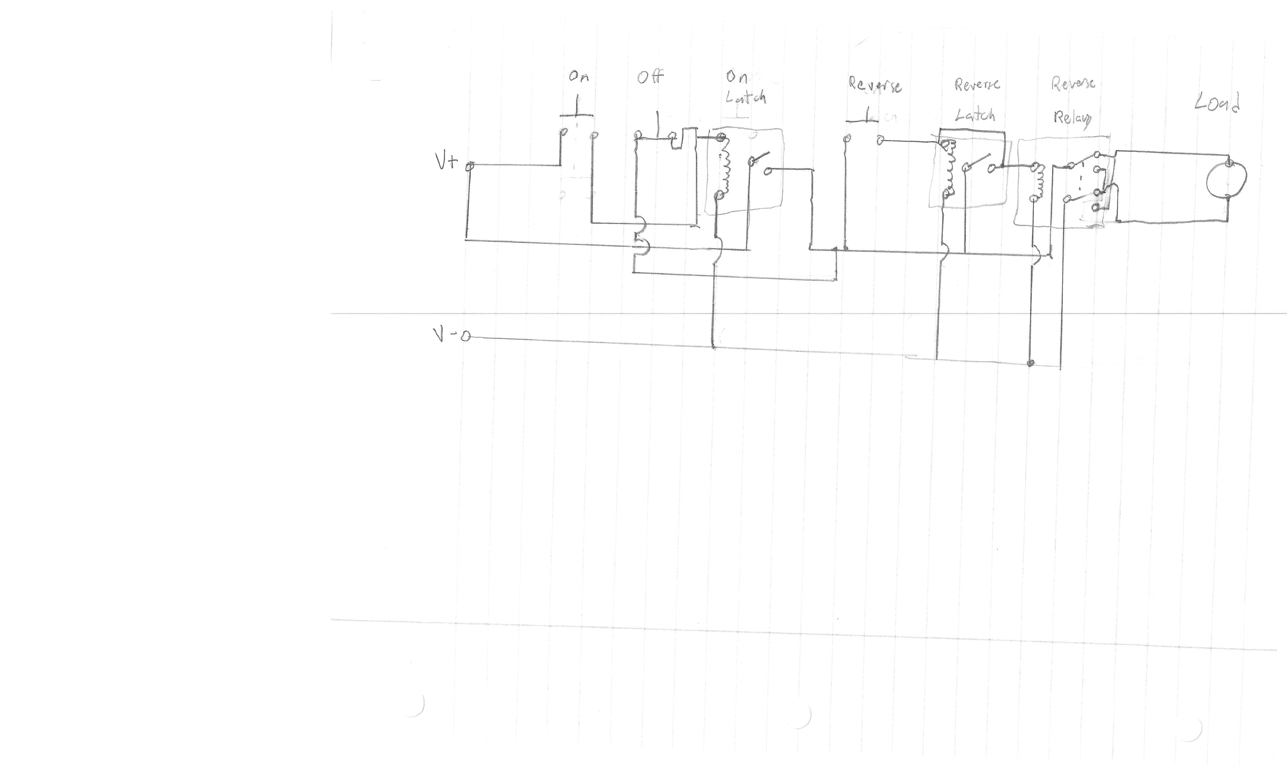

ok, so I can simplify the circuit a bit by using the dpdt relay. It sounds indeed Like I'm not too far off. I'll spend some time today trying to get this down on paper and wrapping my head around it. This indeed stretches my limit of knowledge to the max.. and beyond. Thanks for the help so far.
oh and good wine does indeed come in a box :)
/ Semi automatic wine corking machine #22

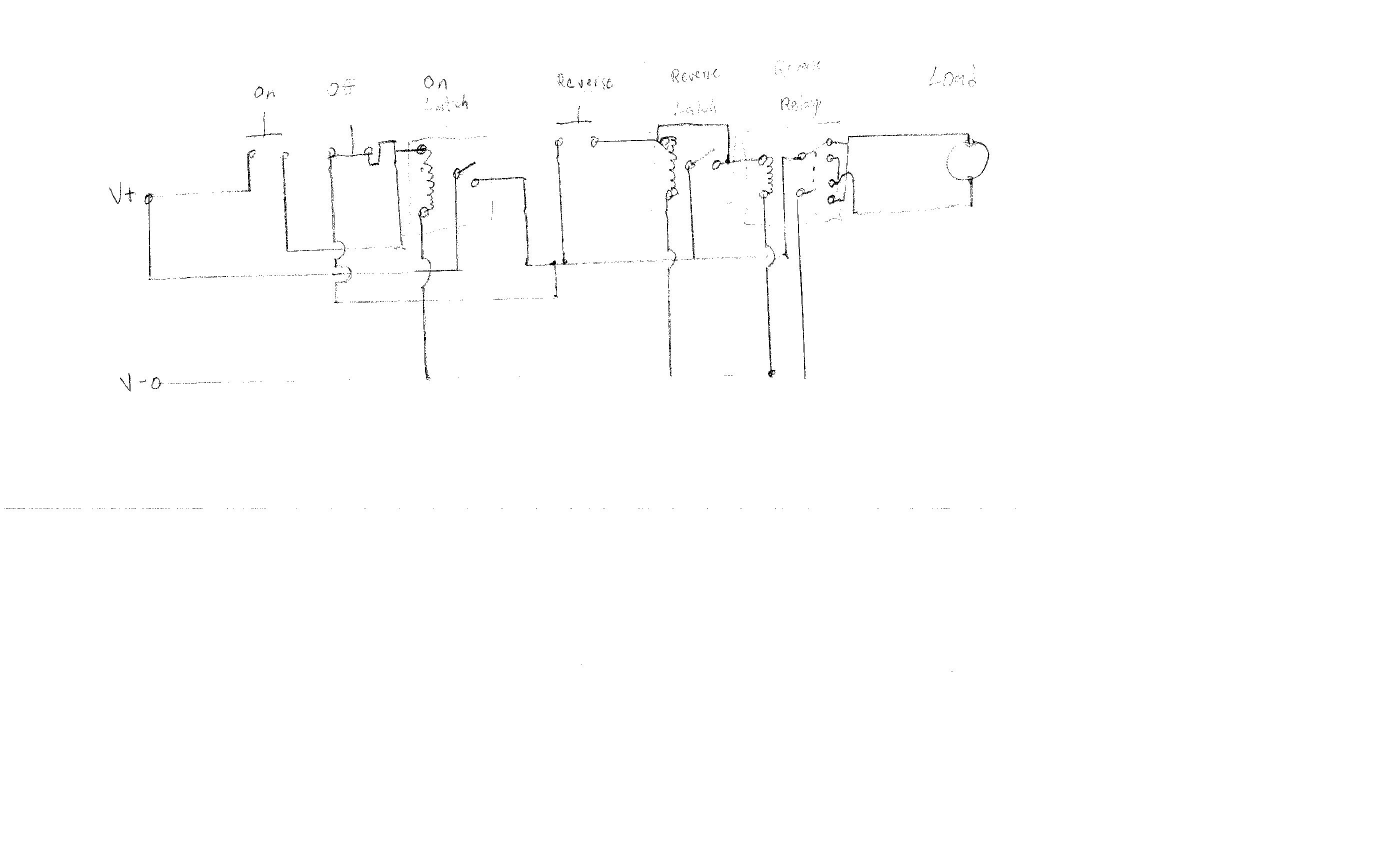

Here's a diagram, I can't figure out how to upload in higher resolution. For the relays I recommend this part:
Multicomp 40A Automotive 12V Relay | CMA31-DC12V-A (CMA31DC12VA) | Multicomp
#23
cool, ill re-draw this up to make sure I understand what happening. Cheers.
/ Semi automatic wine corking machine #24
Here's a better resolution. TBN limits the size of attachments so I've been playing around trying to find the resolution that I can upload and still be under the limit.

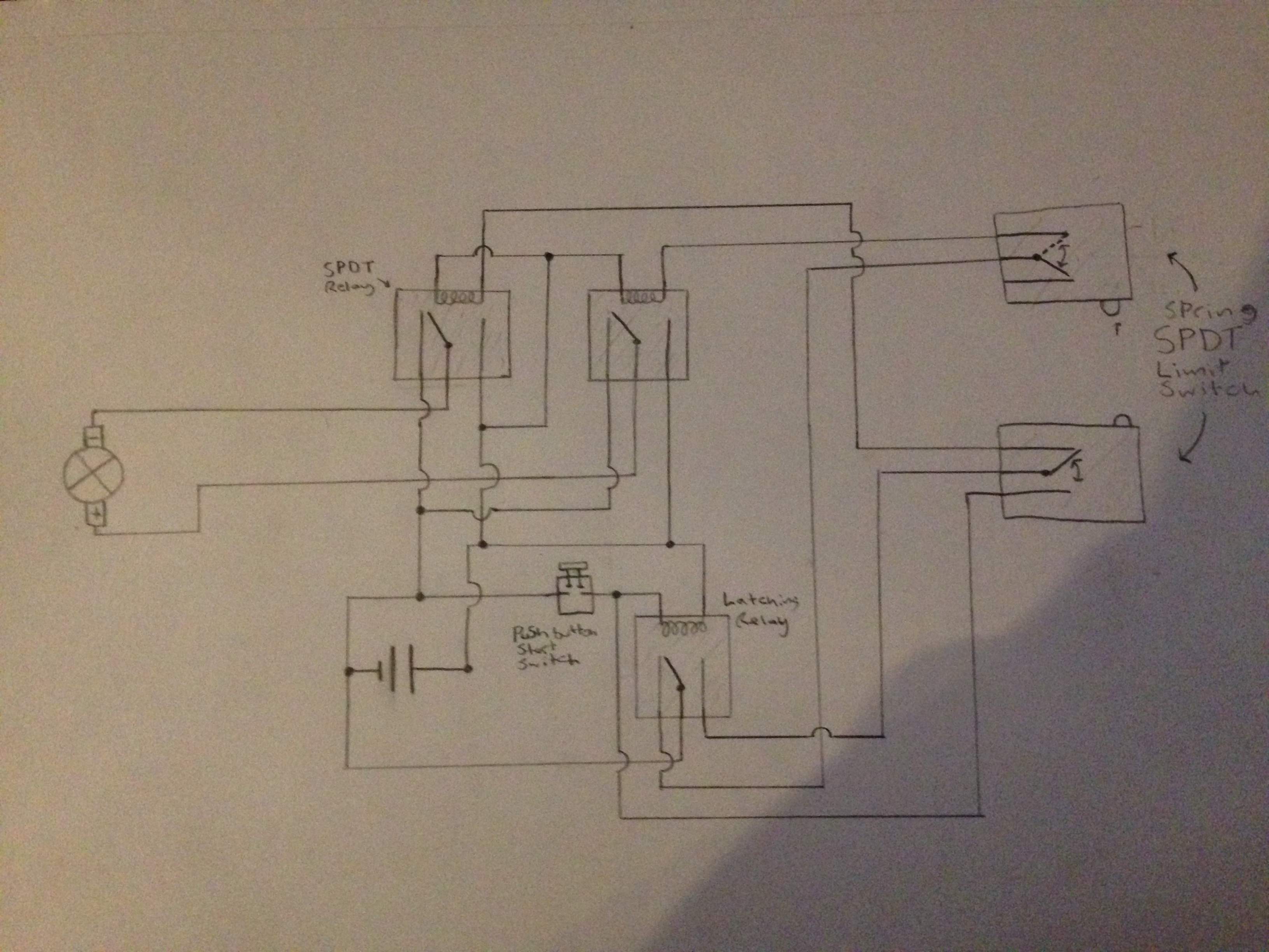

Yeah after your post last night I did some digging again and it seems that just make the screw caps differently than they used to, allowing for oxygen diffusion. There is SOME risk of contamination but it's basically nil, far better than corks. Combine that with the fact that there are a GREAT many screw caps on the market and you have a product that seems to be a great idea. Thanks for making me think about this again, it's definitely an area I'll consider seriously.

You could do it without a bunch of timers and pneumatics.
Feed the corks from a tube have the arm hit a limit switch to open motor contacts at "ram up" position. Swap corked bottle with uncorked bottle and press momentary contact running motor off of limit switch and it strokes in another cork.
A big version of this that stops after each cycle.
