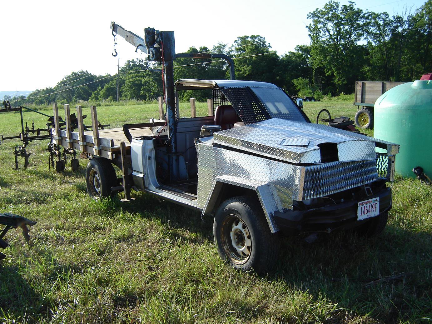

Since your in Ohio with snowfalls similar to where I live, have you considered finding a descent running old small pickup for cheap? The box could be scrapped and splitter mounted in its place.
I was assisting at a tractor club auction, and someone had brought this modified rig to sell.

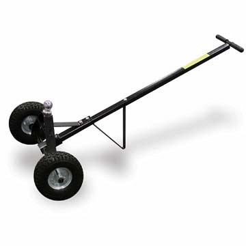

I have one of these and it works well to move from the shed to the woodpile. Might work for you if it's not hilly where you live.
