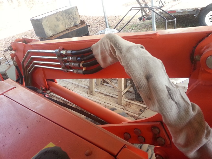

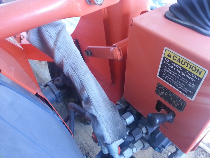

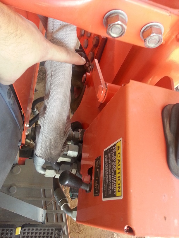

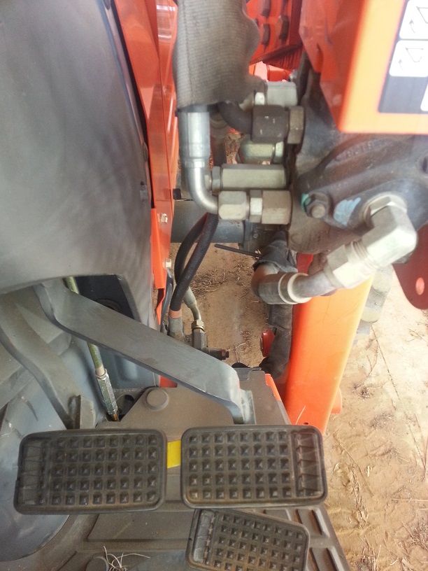

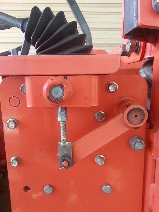

Ok guys, I went out and took some pics.
you can see the mechanical arms going into the spool loader control manifold, but nothing is hooked to them, the picture where you see me pointing to a lever should have a rod hooked to it, but I can not find where it would have attached on the bucket. As for there being another valve body mounted on the loader arm, I do not see any signs of where it might have been. There is a extended pin in the upper curl cylinder, my guess is that is where the bucket level rod went or maybe something having to do with the auto level. I just don't know.
Any thoughts, or is this how it is suppose to be?
thanks
MrC.

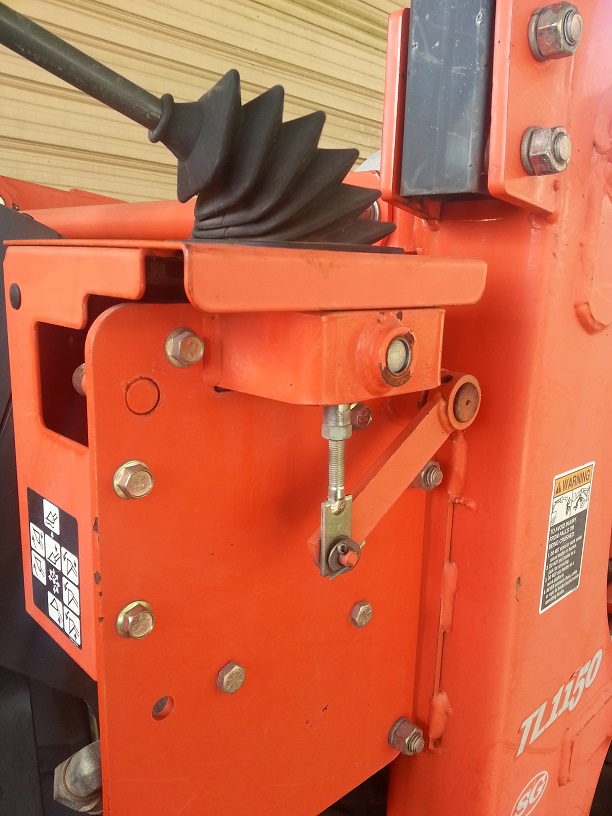

Has anyone seen a kit for an LA1055? Ordering individual parts is an option but would be quite expensive.
I gave you the information (post #9) you need to order the kit as wholegoods already for $599 right from Kubota. If you want to look elsewhere, it's your prerogative.
Wholegoods is NOT the parts department. It's the sales group that would sell you a tractor. They sell "kits" in Sales and will be cheaper than buying the parts individually from the parts department. The Parts Dept. will not give you wholegoods prices. Seems crazy but this is the way it is.
FYI... You generally will not find the item number shown in post #9 on Messick's or any other online parts seller as it is NOT sold as a PART. It has to be purchased from Sales.
Perhaps I'm misunderstanding your desire, so I apologize if I am.
Good luck!

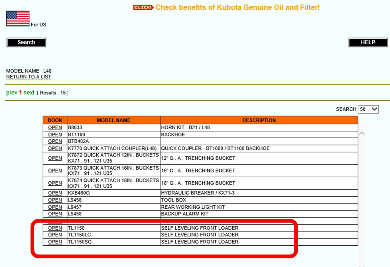

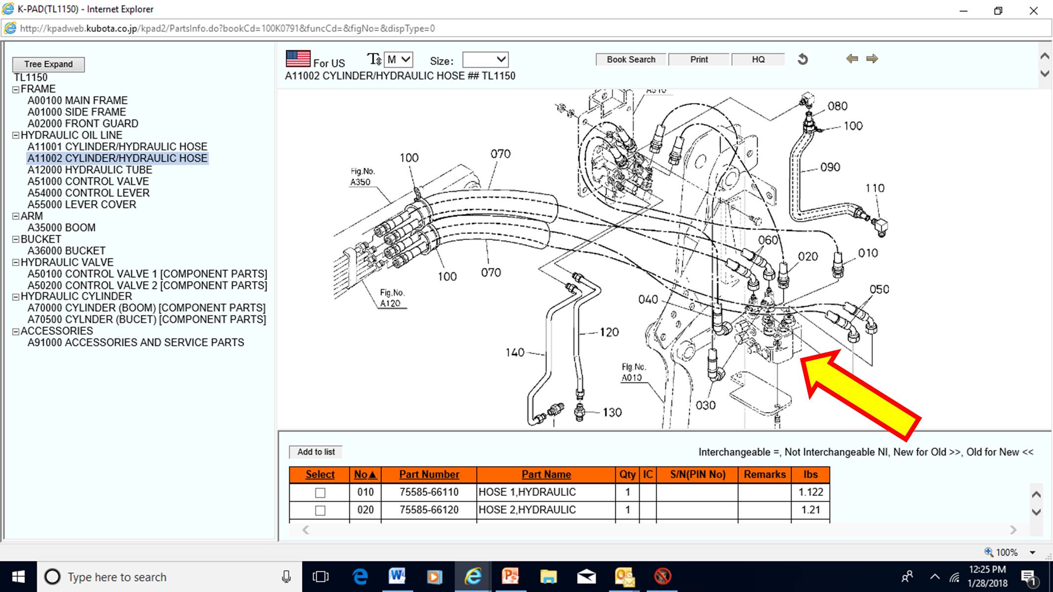

MrC. Perhaps to reduce confusion with what the OP is looking for, you should have started a new thread as the two applications appear to be different.
If you search on Kubota's web site under Illustrated Parts List, you're likely to find what you're looking for. Not knowing your Serial number or Tractor specifics, I ventured over to it and found the leveling valve and associated hoses fairly quickly.
Here are a few screen shots to get you started.
Self Leveling Valve
Hoses Routing
Hope this is helpful in finding the answers you seek.

Dealer quoted me a price of $610 with tax for the kit. He did mention the linkage used to activate the self leveling valve is fragile and can easily be damaged if caution isn't used when operating the FEL. I'd like to get a look at one to see if this will be a problem for me since I work in some pretty knarly locations. So far, all I have is the exploded parts diagram for the kit. In any case, I'm waiting until spring to order it since the tractor is used for snow removal now.
