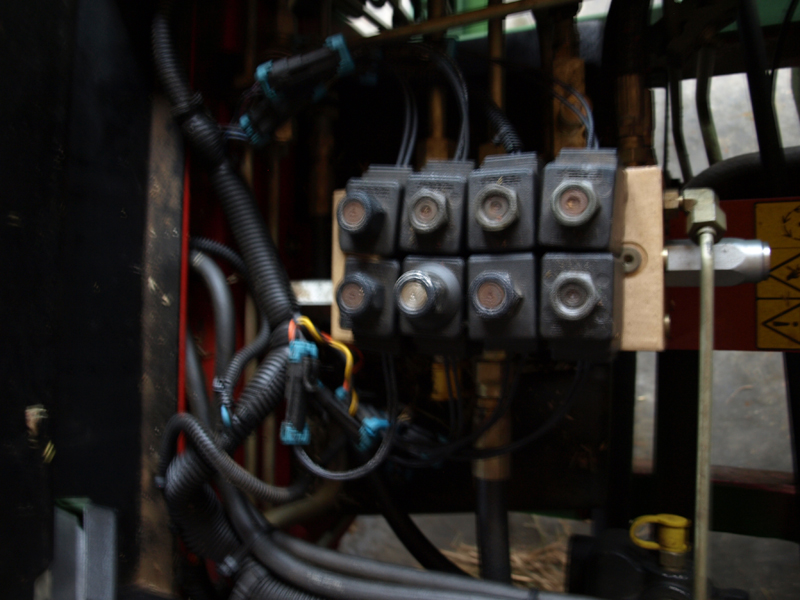

I am new at this so forgive me if some of my terms are off. I was wondering can anyone tell me how selenoid valves work in general, or point me to some books or websites to explain them. There seem to be sets of two selenoids per operation. Are there joystick controllers that I could run to them use them to run a backhoe for instance? I understand the manual 1 or 2 position valves.
Any help would be great - Thanks

I guess I don't understand what you need to know for sure:confused2:
Those are valves that you have now? There is no way I can tell you how they work from just that picture.

What appears you have in that picture is 8, 2 way valves hooked up in a manifold that from what I can tell would run 2 cylinders. That type of setup would much better be ran off of microprocessor (P.L.C.) than a joystick. Did it come off of a garbage truck?

Would it be safe to say them are more like poppet type valves AKKAMAAN,and can you run them with a proportional solenoid???
As kennyd said earlier....need more and better info....I just posted for about solenoid valves in general.....
It sure does not look like it is spool valves though....could be poppet valves....Or the pic just shows a an elctro-hydraulic servo unit, and the spool valve is placed somewhere else....
The symbolic drawing from "the book" would help as well....
Robert128: What type of equipment is that valve sitting on just now??

These valves are on a Toro Reel Mower. The (I think it is called a Subplate) has one high pressure line in. On the output side - lines run to 3 in-series hydrualic motors (Which have a proportional dial switch for speed control) the other line out goes to a set of 3 hydraulic cylinders that lift the cutters - Operated by a two way joystick.
I am just in the planning stages for this machine. I want to eventually add a rotary cutter to the front and I only have limited funds so I am trying to be creative on using the things that are already there. However, The wiring for the selenoid valves go back to a central controller box. I am just trying to decide if there is any way I can use these valves or if it might be better to take them out and use manual valves. Thanks for all of the information on selenoid valves. It helped.
