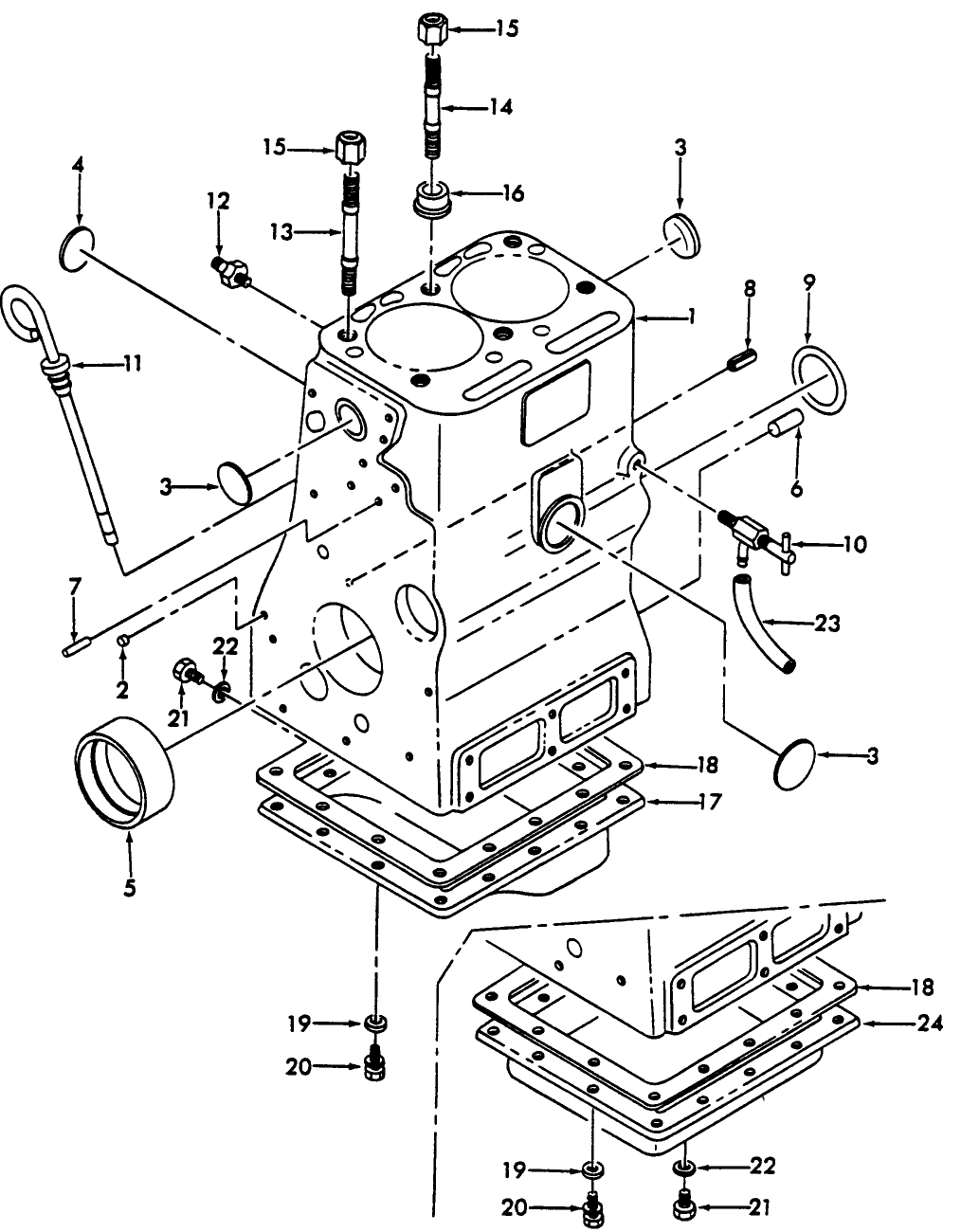

The drain plug for the block drain is seized on my 1900 Ford. Any tips here? I thought about putting some heat to it, but I don't know how the plug actually seals and didn't want to ruin it completely.

the best way is to use a 4 point socket or box end wrench if the drain plug is 4 point. anything else will just round off the corners of the plug.. if it's 4 point, that's just a regular plumbing plug, available at any place that sells plumbing supplies.. if this is it, https://www.svtperformance.com/attachments/blockcoolantdrainplug-jpg.1140736/ then you'll need a socket like shown.. BTW, coat the plug with anti-seize on the threads if you get the plug out, it'll make it much easier to get it out the next time!.

I use a heat gun and lightly heat the plug (lightly). I would spray some penetrating oil (WD-40) around the bolt and tap it gently with box end wrench, hammer or something before I try to loosen the nut and put torque on it. if you are going to replace the plug and not worried about rounding off the nut a vise-Grip would be my last go to hand tool.

Is this for the coolant?

Can't get a good picture as the loader is in the way and the tractors disabled at this point. But it's like the one in the picture with the hose but a little different in that the ears are cast and quit large. Looks handy, but not when it's seized. At this point we have it drained enough that the water pump came off with very little mess. The only reason I'd need it loose at this point is if I have to bleed it once everything is back together and filled. The drain on the rad was no problem, but that one looks to be brass.
