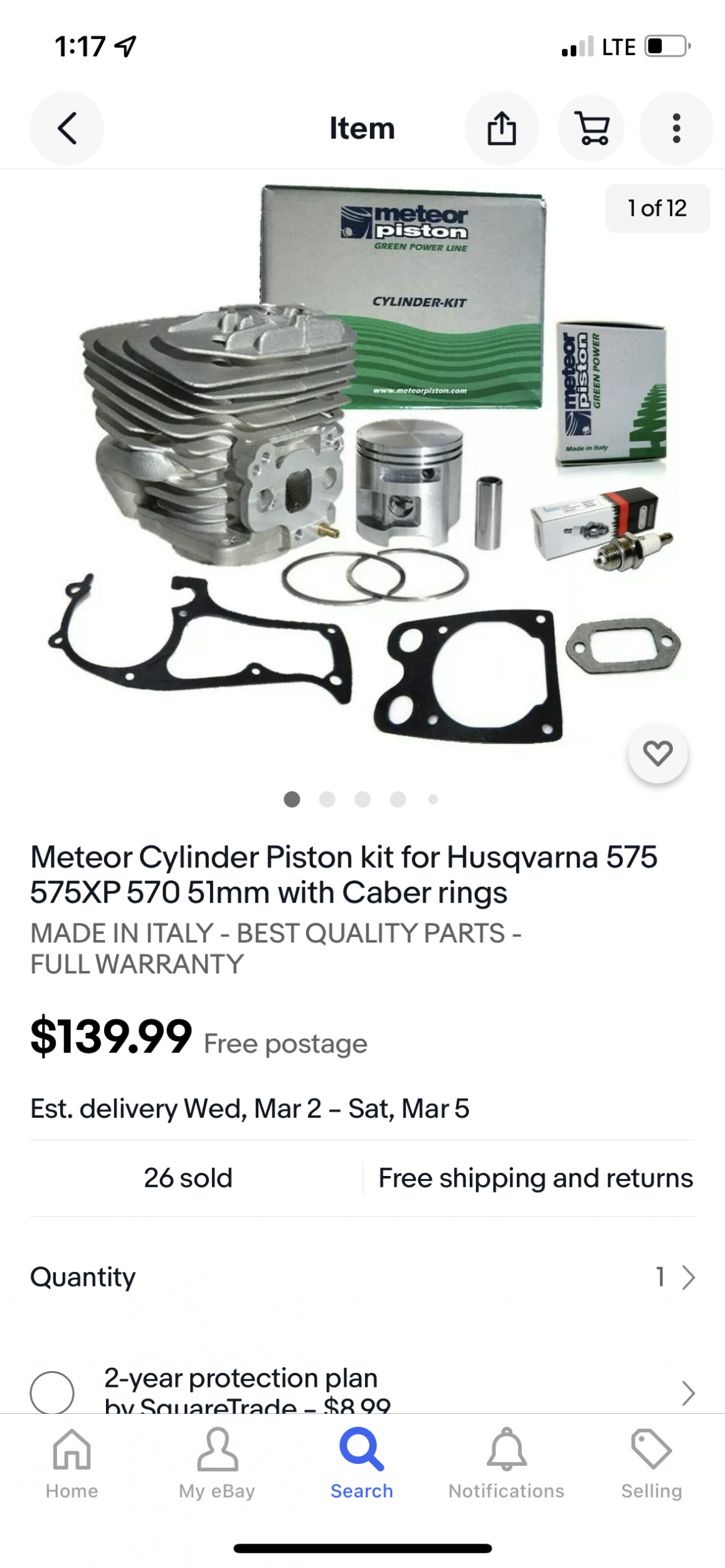

Now i'm back to the beginning. Checked compression again and it's only 30 psi. Could it be that some atf leftover in cylinder resulted in high compression in the beginning, but now when it's gone i lost it? Anyway looks like time to replace cylinder/piston assy
I used to be a Husky dealer and this is how I would fix your saw from eBay. I have a 254 Husky I have used every year for 34 years. Replaced the fuel line twice, rebuilt the carb once and two new ropes and that’s it. I have always ran 87 octane and 50:1 Husky oil only. Good luck.
