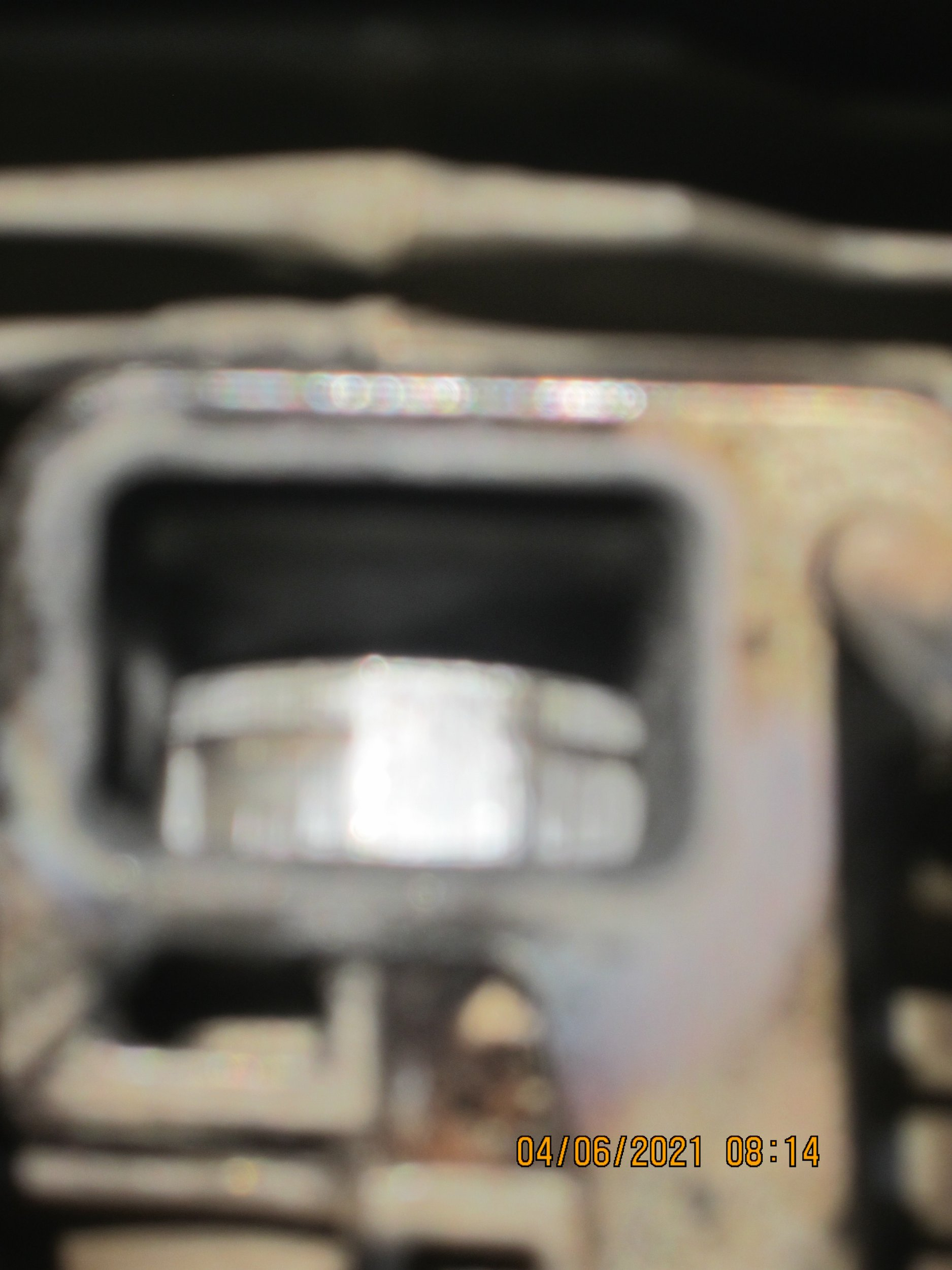

You had me fooled there for a bit. "No compression" means the piston moves but you get no pressure at the top of the stroke. You actually mean you could not even move the piston, right?
Nope. My neighbor and I are the kings of dull-chain sawing and we, also, have never seized an engine. Sooted up the mufflers, seized chains to bars, threw chains.......... but never seized an engine.
That's right. Piston moves but little pressure at the top-30 psi

I have never seen a saw overheat and seize up if running the correct 2 cycle mix. And I’ve been around chainsaws my whole career.
Saws can overheat and seize.
Causes? Wrong fuel air mixture, blocked cooling fins or cover, air leak, bad carb, etc.
Saws that are overheating should be complaining before they seize. If they just quit, likely oil.
What you look for is on the piston, did it score on the skirt? Oil. did it score at the top of the piston, heat. Wrong sperkplug can cause overheating but usually burns a hole in top of piston before seizing.
Oil seizure:
heat seizure:

Wish I could see the piston
