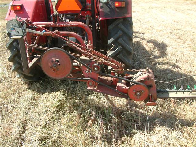

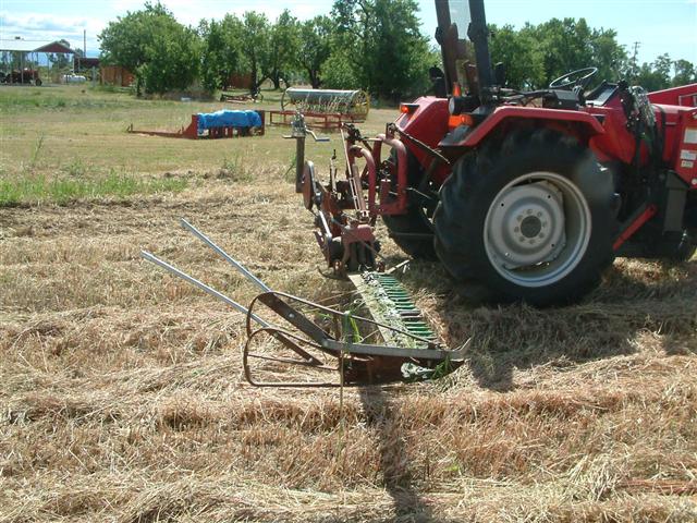

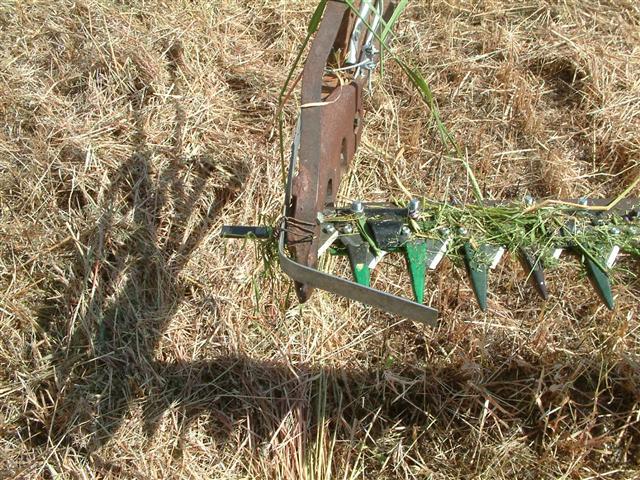

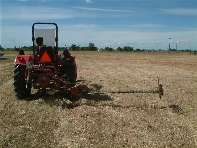

If you get into used sicklebars, you'll need to invest time and $$ to get it working properly. I bought a used 7-ft Massey Ferguson 31 sicklebar at auction two years ago for $550. Had to rebuild the cutting bar 3 times so far and it still isn't working perfectly. The sickle sections (the triangular parts that move) aren't that expensive ($1.25 each and that 7-ft sickle takes 28 sections). The guards/ledger plates (the stationary pointing things bolted to the bar) cost about $6 each and there are 27 of these.
DSCF0049 (Small).JPGDSCF0050 (Small).JPGDSCF0052 (Small).JPGDSCF0057 (Small).JPG
Some folks like sicklebars that have wooden pitmans to drive the sickle. I prefer the belt-driven variety.
28hp is plenty to drive a 7-ft sicklebar through a hayfield.
