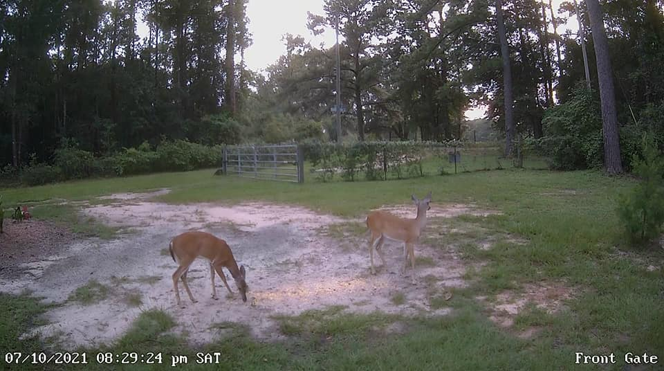

I have a couple of Reolink Argus Eco cameras that are wifi but also record to a micro sd card. Coupled with the solar panel supplied by Reolink the batteries have remained at 100%. You could review the contents on the sd cards with a laptop and USB adaptor if it doesn't already have a slot and later use the wifi feature. You would have to set them up at home on your wifi.
They currently have the black camera/solar panel bundle on eBay for $85. I didn't see it at their online store.
You have to add a SD card and I recommend the Samsung Pro Endurance.
Mine have got moisture in them a couple of times but I was able to remove the three little screw holding the lens in and dry them and put them back together. I recommend taping over the tiny screw holes to keep tiny spiders from inhabiting them. Amazing how big those tiny spiders look right on top of a lens. If you want audio don't tape over the tinyer mic hole under the top screw hole.
Here is a resized image from one that I have 410 ft from my wifi router in the house.
