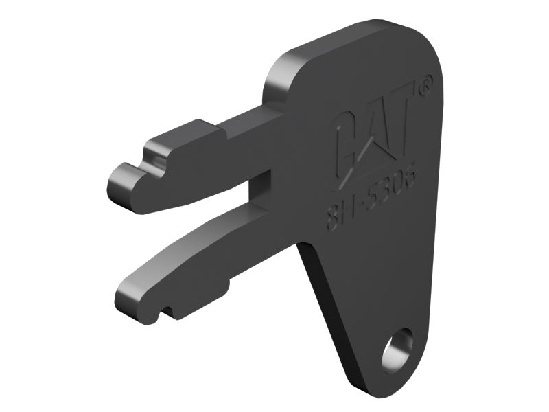

I don't know about Kubota, but my cat has a key'd battery disconnect switch. If this key is not in the switch, nothing is going to start it. It's not easy to override either.
I leave my mini at the cabin and I just remove the key and go on my way...
CM20180123-55177-37511
   / securing mini-x at remote location #9
Are they all keyed the same? If so it’s of very little value?
   / securing mini-x at remote location #10
No kidding, why would cat even bother if their all the same...
