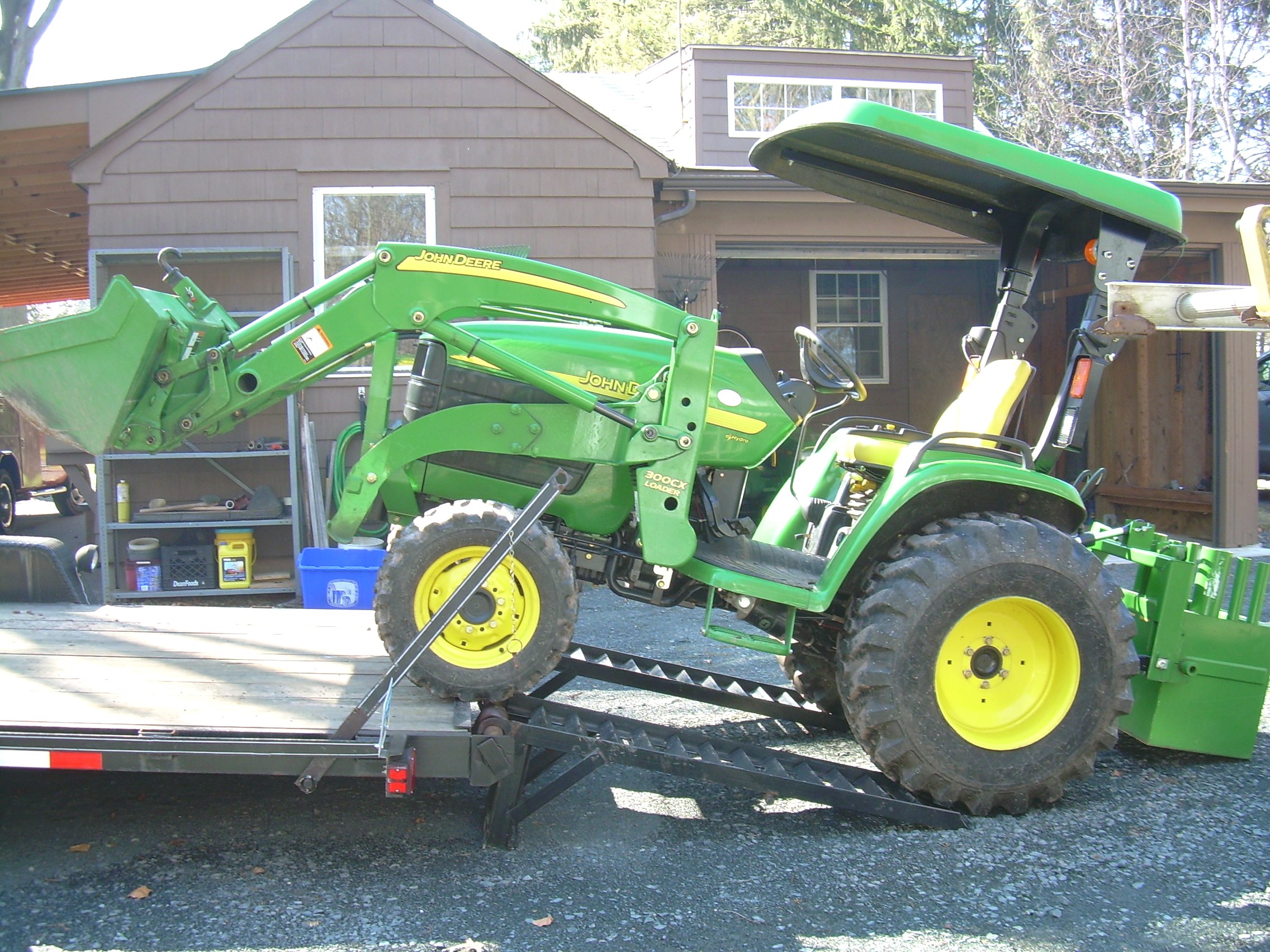

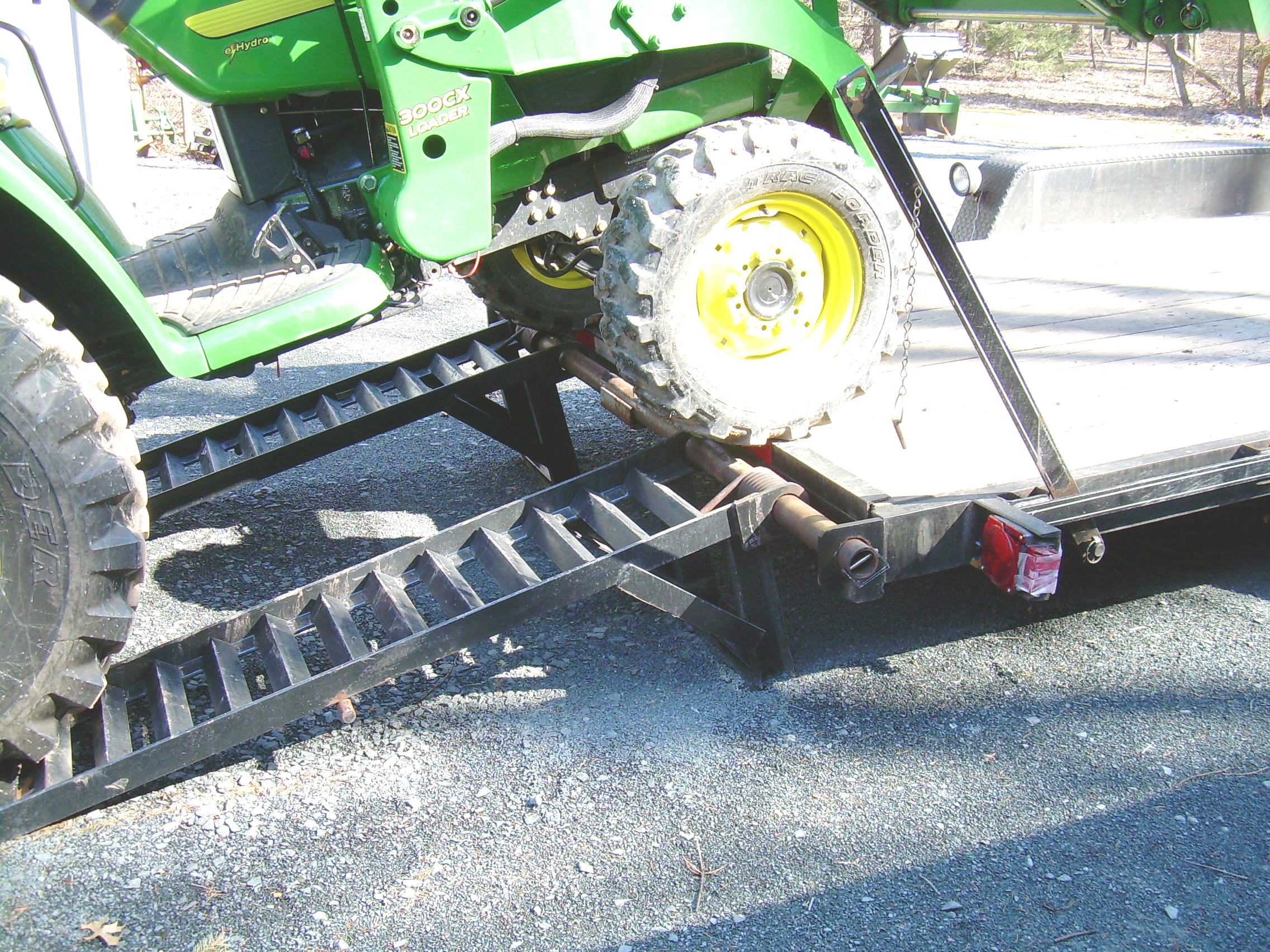

Well if I'm doing something dangerous I need to know, so I appreciate the comments/warnings by you and wwalkersd.
After looking at the pics again I can see one potential problem, after the back wheels get to the top of the ramp and onto the trailer, but still well before the front jack comes back down. with that much weight on the ramp brace/leg, even though that brace is angled under the end of the trailer, if there was some forward motion with the trailer, those ramp legs could possibly cam out which would cause the ramp to hinge on the pipe that holds them and swing up with some destructive /dangerous force as the back of the trailer dropped. Chocking the wheel would help to prevent that, so I will choke wheels if there is a next time.
The trailer would only drop about 6-8 inches, which would still leave the deck at less of an angle than the ramps are typically. Once the weight shifted back down on to the front jack I don't see any danger unless the front jack collapsed, which would leave the deck at a fairly mild angle.
Anyone see any other potential hazards?
I can't think of a real world reason to load the trailer uncoupled to the truck, I only did this to practice my binding and to take some pictures of the results.
I guess those additional jacks I've seen on the back of some trailers would be more stable than just the ramps.
