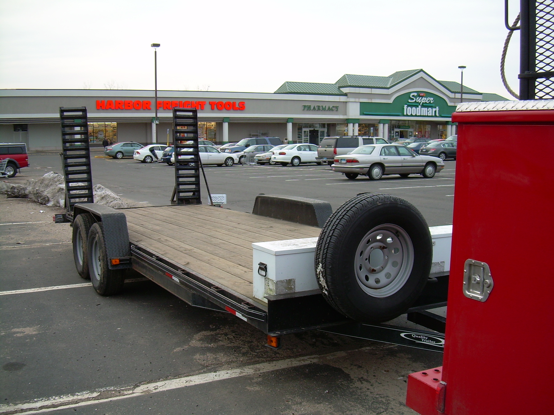

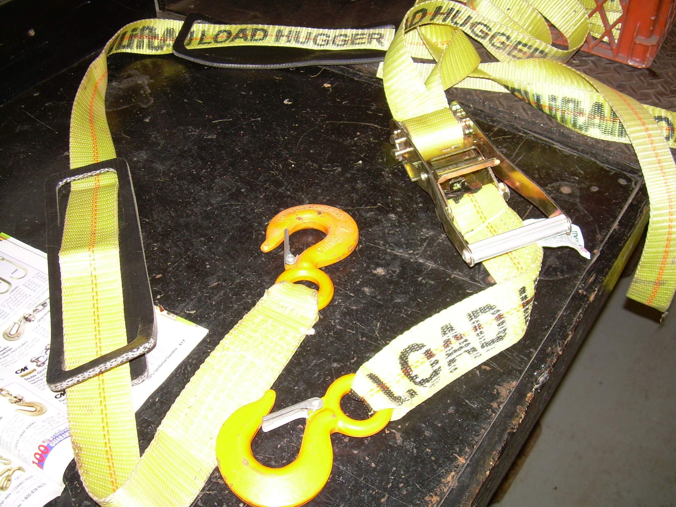

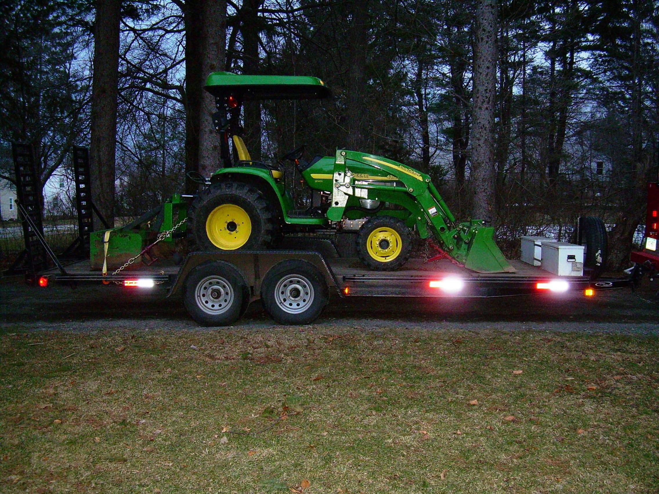

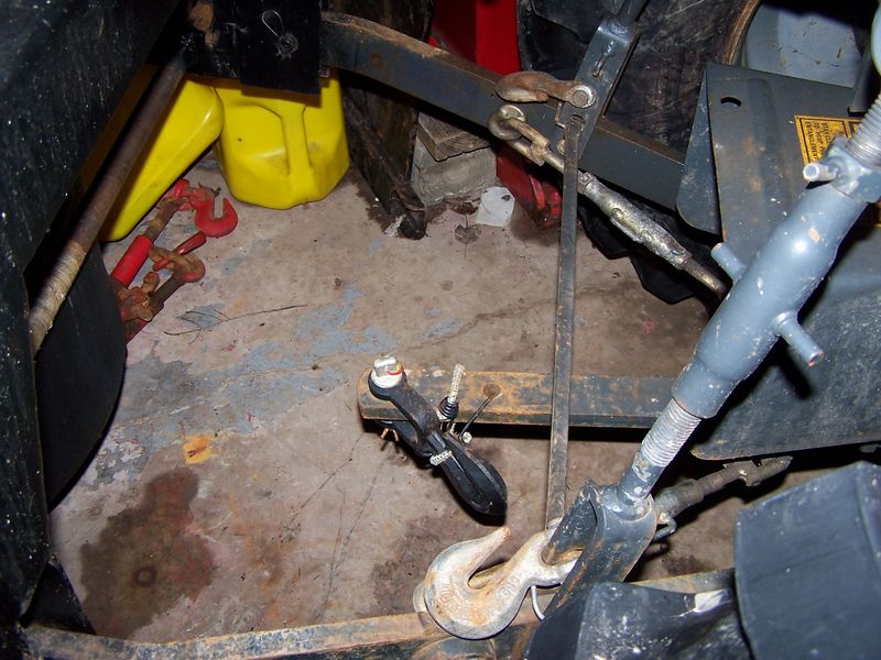

OK. Now that I finally got an Equipment trailer I need to learn how to secure loads properly. For now it's a JD4310 and a ford 1700.
I have moved the JD in my dump trailer but that was a hassle working with only 4 D-rings and the high sides in the way.
As far as connecting to the trailer, I have the stake pockets and rub rail, I think most will say drop chain thru pocket, come up underneath and hook on upper edge of pocket.
That's pretty simple and if it's the acceptable way of doing it, I can live with that.
What I would like is pictures of how you connect to machine.
I have plenty of HD 3/8 chain, 4 chain binders, 2 ratcheting web straps. just bought a couple hundred dollars worth of acs at AWdirect yesterday so I don't mind if it's overkill.
I've got a 20' trailer so there's no problem for fit, the guy I bought it from put a couple of tool boxes on the front of the deck and I would like to keep them there as they are handy for storing chains etc. the only problem is I can't pull the tractor up tight to the front, but since the trailer is so long I probably want to dock it back a little to balance the load. Should I bolt a pc of 4x4 down on the deck to pull the tractor up tight to or is that not necessary and the load binders will hold it in place with out stops?
Pictures help me get the idea quicker :) if any one has any.
I'm going out now to experiment.
Thanks
JB.

Nice setup. Depending on your length of chain, I would cut them to length so that you only have to unchain the tractor end. Crisscross them if you want but use a length for each corner and a binder for each since you have them. Use a large clevis on the drawbar for the back attachment and weight bracket on the front. This might change depending on you desired tractor position and resulting angles to the current stake pocket locations.
Cut the chains to a length the allows a loop to dangle about 18" below the binder after ratcheting tight and looping tractor end of chain around attachment and hooking on chain close to attachment point.
When I load with the BB, I drape chains over the back and squeeze the BB down to the trailer bed at the same time. Might want to use a ratchet strap to tie down the rake or blade.
Now with the BH I Just rode with the boom locked but after enuff bumps the lock plate (1/2" thick) began to stretch. Now I just curl the bucket up let boom all the way down to deck and snug up with a strap. Somebody probably has a better way for this. The big backhoes I see just put the dipper vertical and bucket flat on deck with nothing tying it down.
When I needed both rake and BB, the rake would be on the back and bb fit nicely into loader bucket then front chains locked in BB to bucket.
Warning you will scratch paint. The loader bucket just doesnt stick out far enuff to have both a forward angle on chains and locate chains behind bucket. If you dont like this you could rap chains around front axle but again you scratch paint.
Again depending on tractor/stake pocket location, It might be slick to add a heavy forged EYE bolts to the rear axle/rops bracket to get both a rearward angle and avoid scratching 3pt implements.
Also If that was my trailer, I would move spare tire to just in front of fender and remove one tool box, put the other on the tongue or pick up an angled tongue box, they are pretty slick. I would have those boxes demolished if left there.

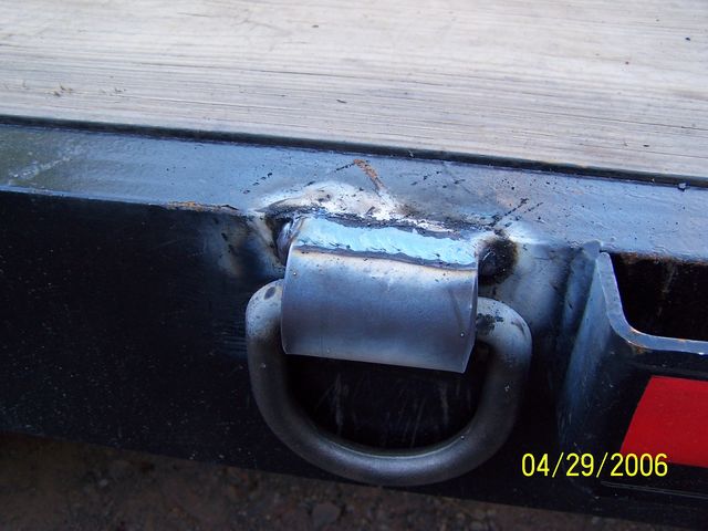

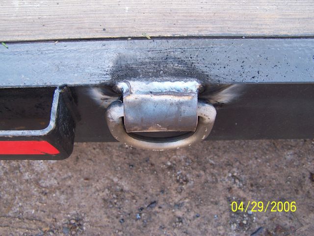

Using the pockets as you described is the correct way to hook a chain. If you don't have D-rings then the pockets will work fine.
I use 5 - 3/8" chains and ratchet binders to secure my tractor. 2 front, 2 back and 1 for the bucket. I used the side pockets on my trailer when I first bought it. Once I figured where I needed to place D-rings I welded them (6) on the sides and back of the trailer and use them now. Originally I would wrap the chain around the front loader support bracket. Later I welded 2 D-rings to the bottom of my loader support bracket (see pic). On back I installed 2 grab hooks to the rear lift arms (pic) Other pics are D-rings on trailer.
Bolting a 4x4 to your trailer will make sure you get the tractor parked in the same place each time you load it but is not needed. I use my trailer for hauling cars and trucks among other things so a 4x4 would be in my way. I pull mine on the trailer in 4WD low, set the brake, then lower the bucket and shut it off. Then I connect my rear chains, then front, then one over the bucket. No pics of it loaded right now since I don't have to take it anywhere and its raining at the moment.

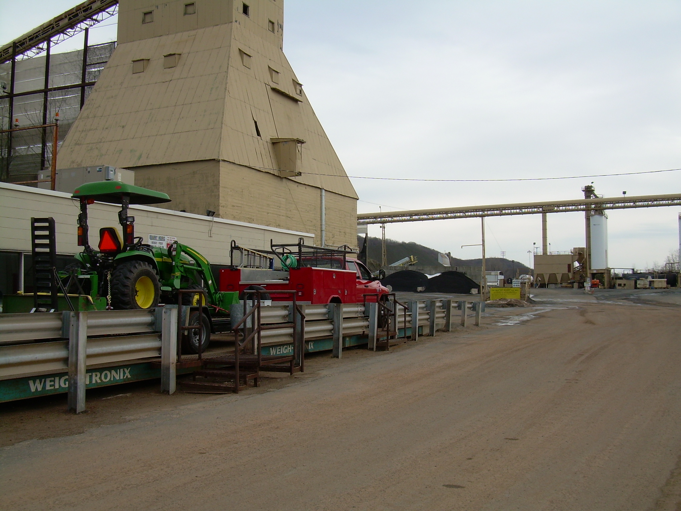

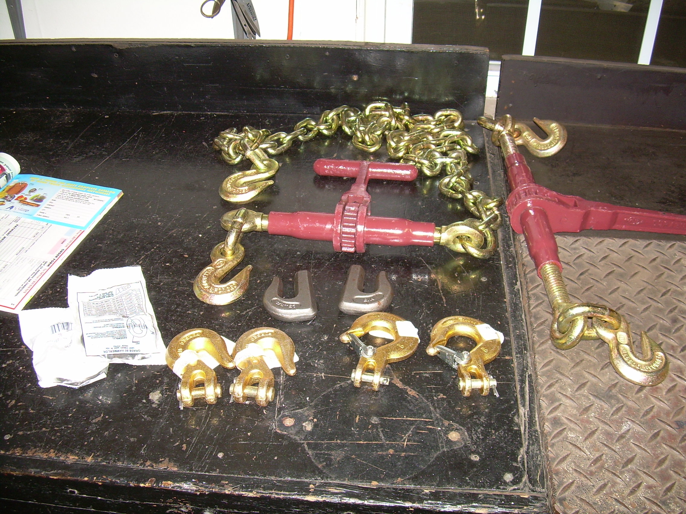

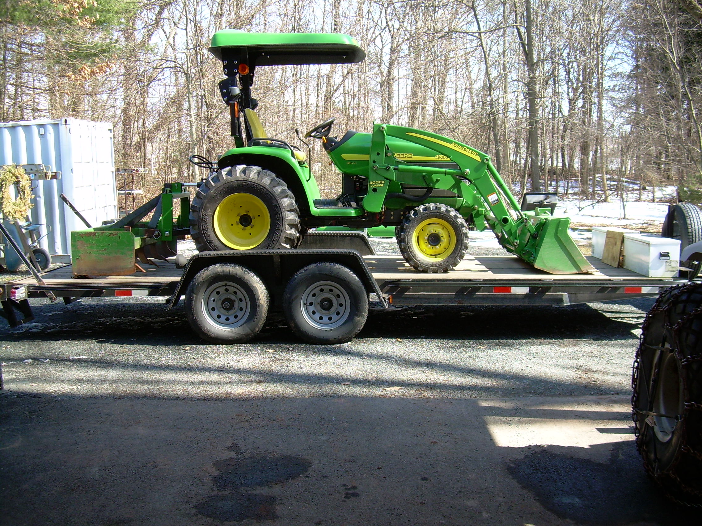

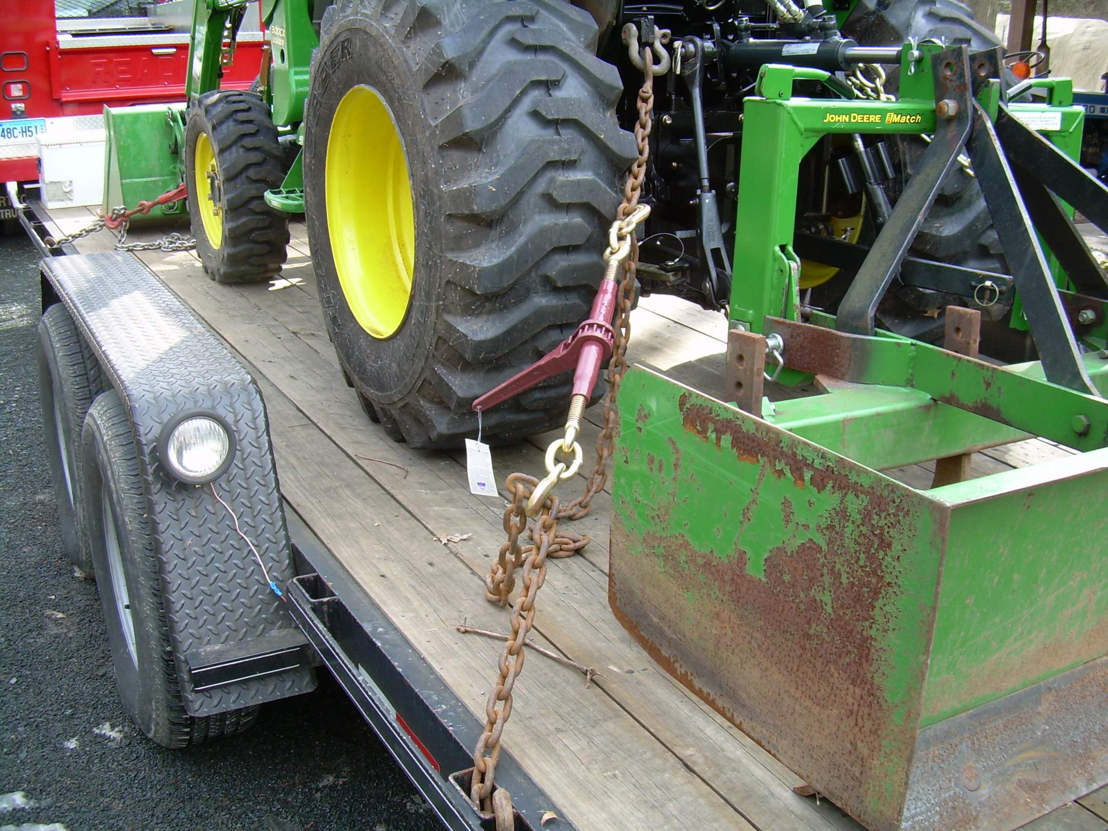

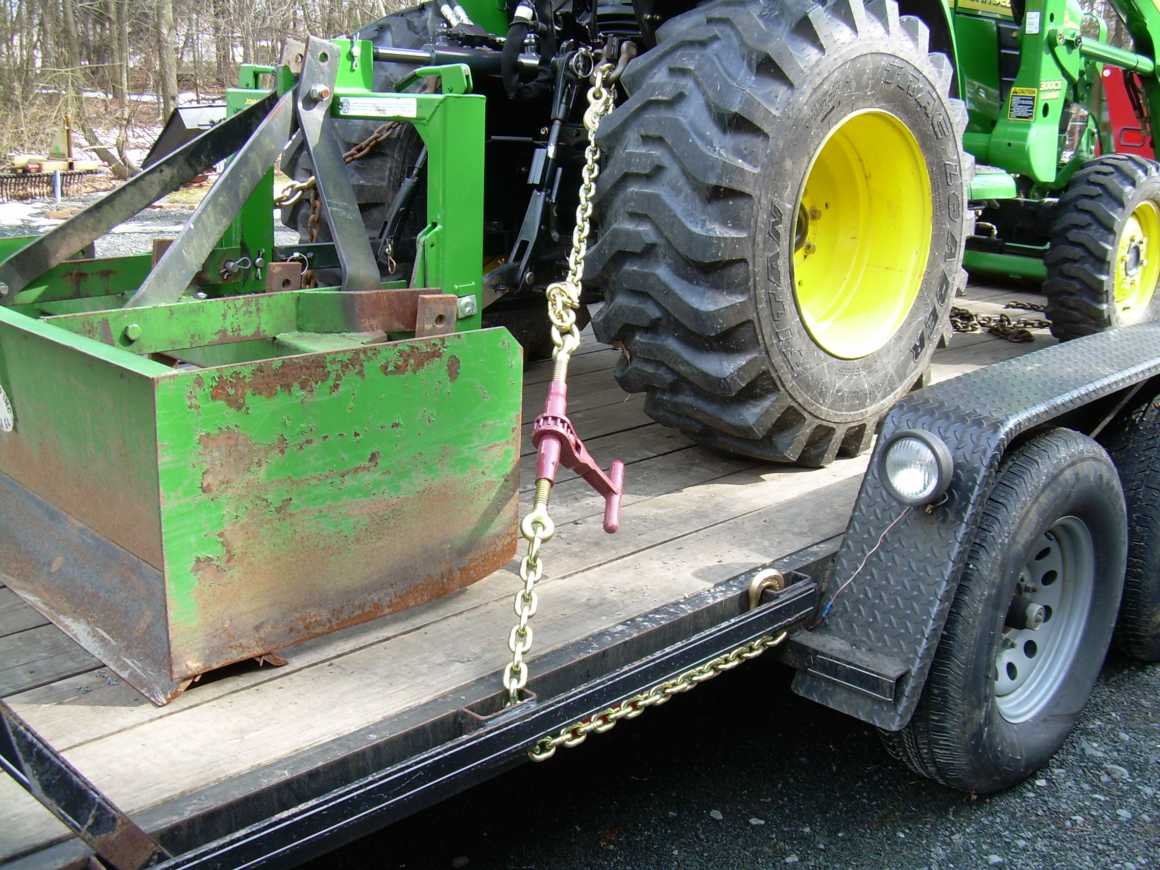

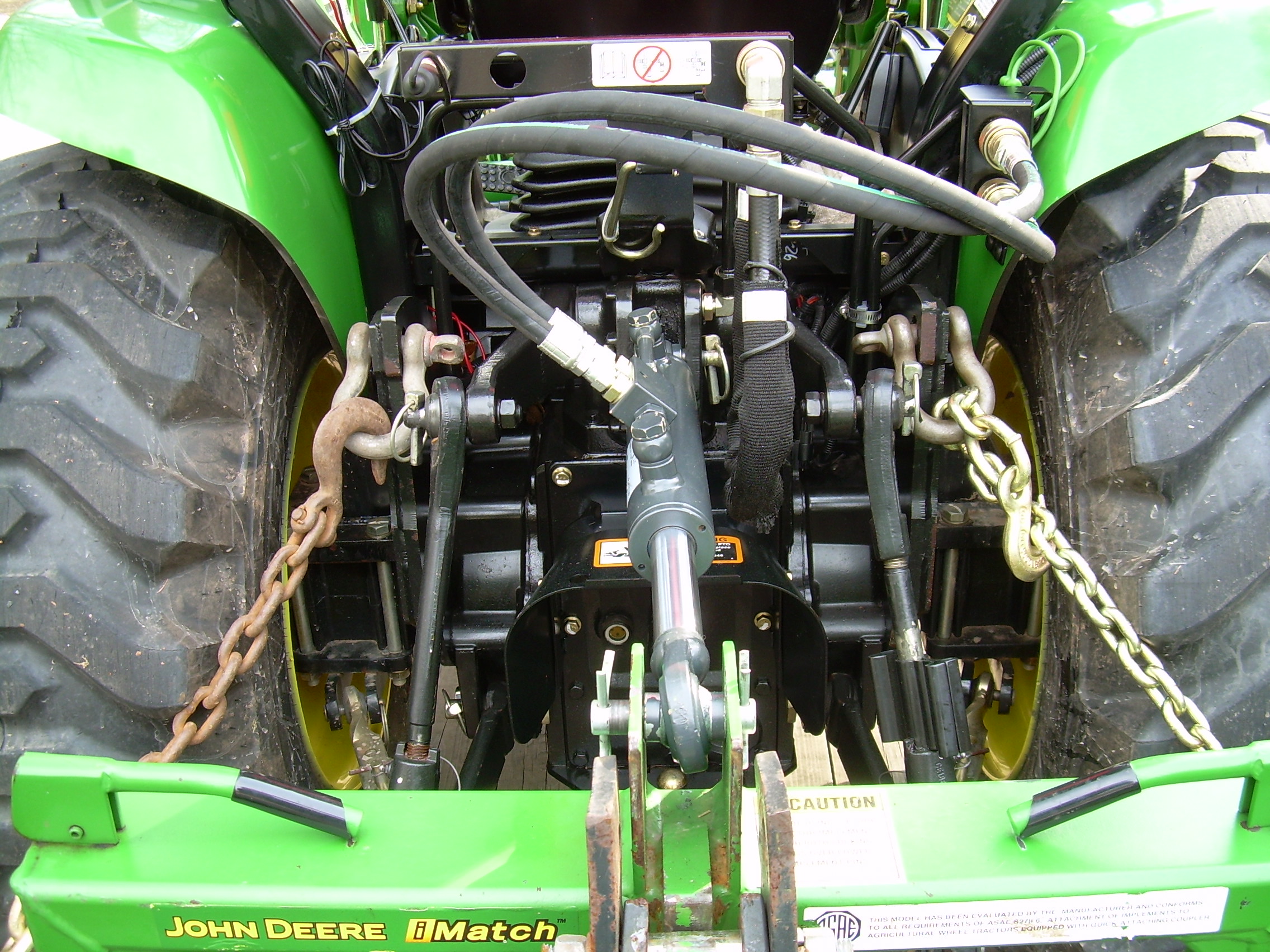

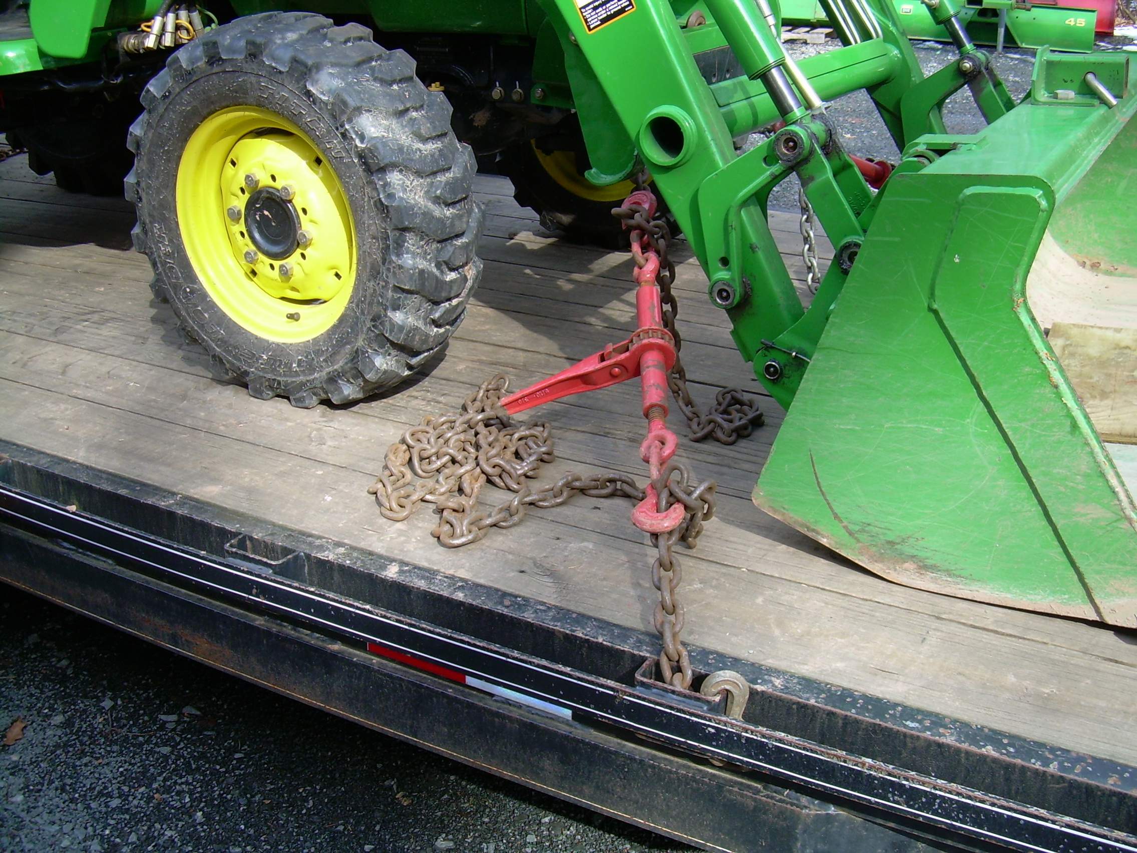

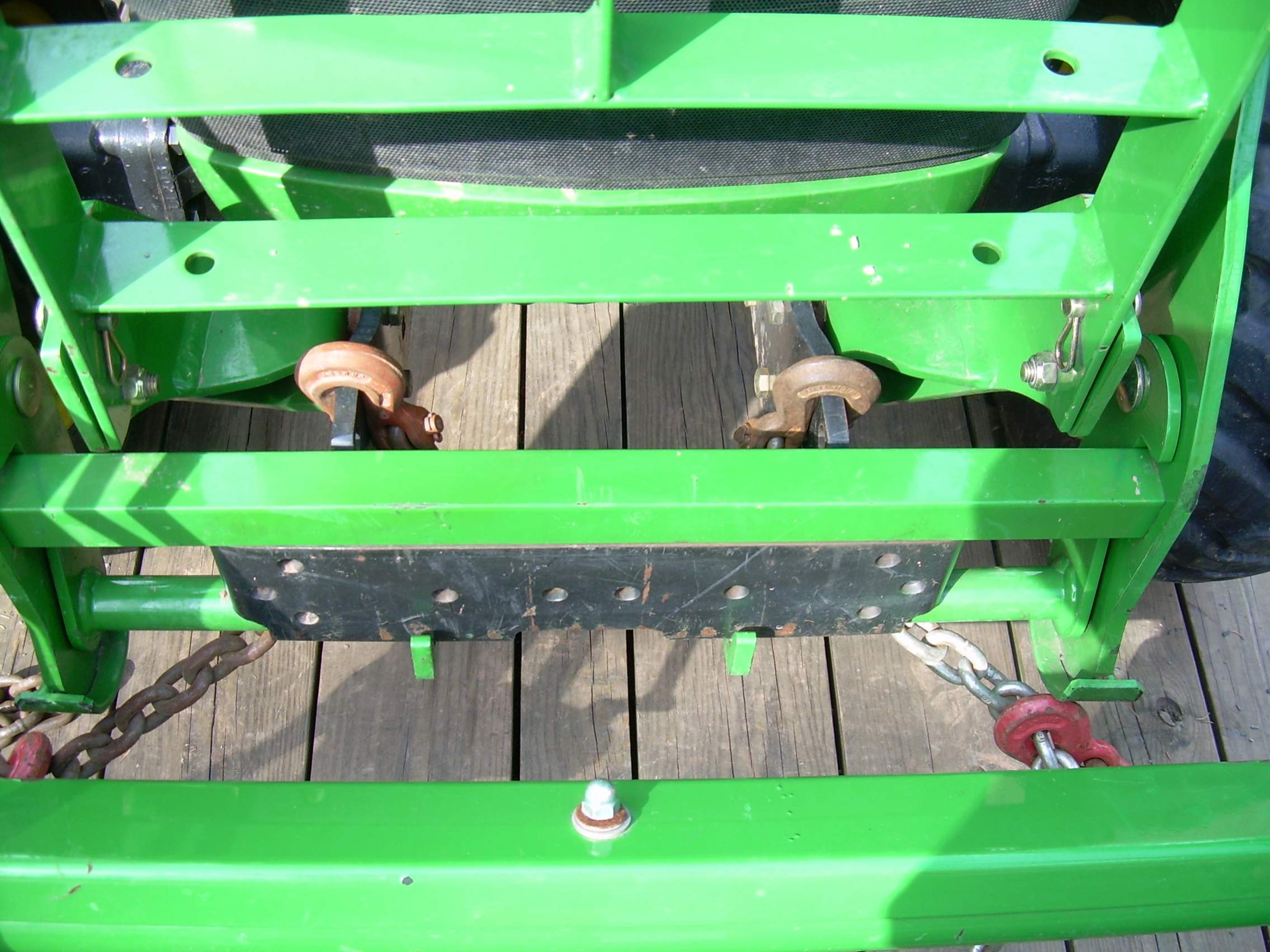

Thanks for all the replies,
I fooled around with it this morning, thought I had enough hardware but I need more hooks, got a bunch of HD chain so I should be good there. I am gonna do all 4 corners with separate binders and 3/8 chain, it's a little overkill maybe but leaves little to worry about. Put a 2 ton ratcheting web over box blade just for the heck of it, didn't realize it's required, I didn't put anything on the loader :eek: thought about it but didn't think it was necessary since the tractor was so well secured, so I guess I'll use my other strap for the loader.
I think I found some sweet connection points on tractor without scratching anything, I bought one new binder with chain attached but now I realize it's better to be able to just crab the chain wherever you want with conventional binder. I was using 2 pcs of chain instead of one on 2 binders, don't know if that's OK, but when I get more hooks I'll make up one pc 6-7ft chains for all 4 corners.
Those shackles in the BH holes are pretty solid, gonna get slip chain hooks with latches for those 2 ends of the chain. grabbing that front frame extension seems solid to me also?
I just kinda went by feel as far as balancing load, as I was driving on the trailer I could see when the weight went back down on the tongue, went a little past that point and locked the parking brake.
Went to the quarry to weigh it, they weren't open but the gate was open to allow security in and out so I drove up on the scale and sure enough I could see the electronic read out thru the window as I suspected. Weighed just the trailer connected to truck but just trailer wheels on scale (6,680lbs) the truck and trailer together came in at 18,500 lbs.
Look at the pictures and let me know if there are any problems waiting to happen.
Thanks, JB.

That is a good system you have going.
In our state though, you need to toss a chain over the emplement. Some will tend to move from side to side and being way back in the trailer it can give a whiplash effect. Especially if you have to dodge something in the road. I know most tractors now days have the swing chains on the liftlinks, but they do tend to slack off a bit.
/ Securing Equipment on Trailer #8
Remember to locate the tractor so you get ~10% of the weight on the truck. One fairly easy way to determine that is with a tape measure. Measure the truck's rear bumper height with the empty trailer attached. Now, you know how much you weigh, so get onto the trailer and stand with your weight on the ball hitch. Measure how far the truck dropped. If you are like me and about 200#, you will want the truck to drop 3-5x that when loaded. It's typically about 1.5 to 2" of bumper drop with a nicely balanced trailer.
If the truck is too much like a dog dragging it's tail, you need to get a weight dist hitch.

Yeah maybe I need a little more tongue weight, since this set up only leaves me 1320lbs before I reach 8K axle rating, if I take off the box blade and put my BH on it's gonna be cutting it close.
JB.
