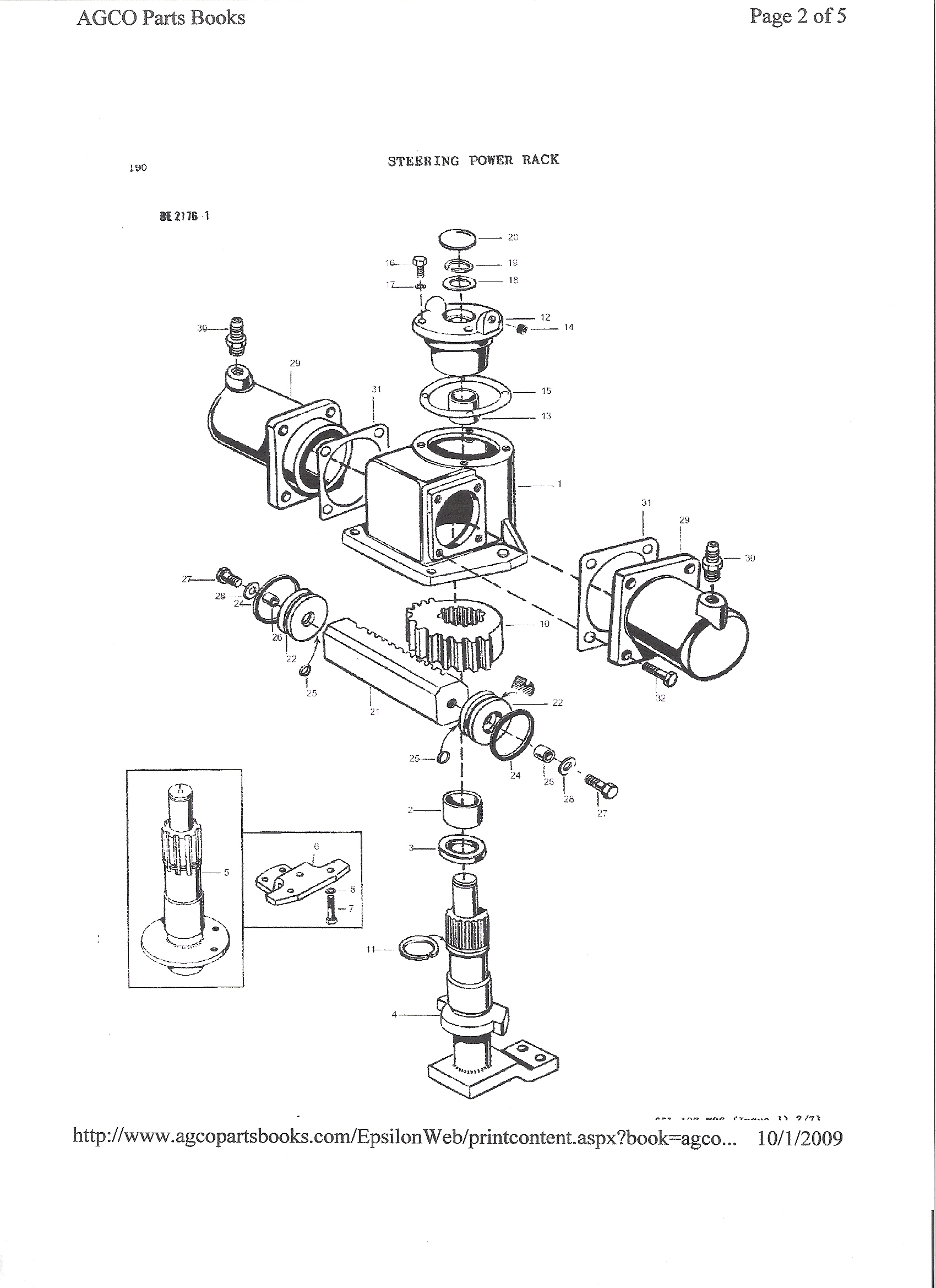

Here is a exploded view of the Power Rack steering used on the 180's. Not sure what other models this style was used on.

/ Second Question: Now only left hand turns...
Guess a better explaination is in order:
I can make left hand turns under power requiring less work than a Farmall A.
I can turn the wheels back to forward without issue.
The steering wheel just turns and turns when trying to move the wheels to the right and nothing happens. No more difficult to turn to the right than to the left. Both simpler than the Farmall A, both harder to turn than an F-250 pickup.
/ Second Question: Now only left hand turns... #7
Look at the diagram from DJ54, you may have lost some teeth on the gear or rod that are in the steering box. That diagram looks just like the steering unit on my old MF85, if it is I know the tractor graveyard where it still resides.
