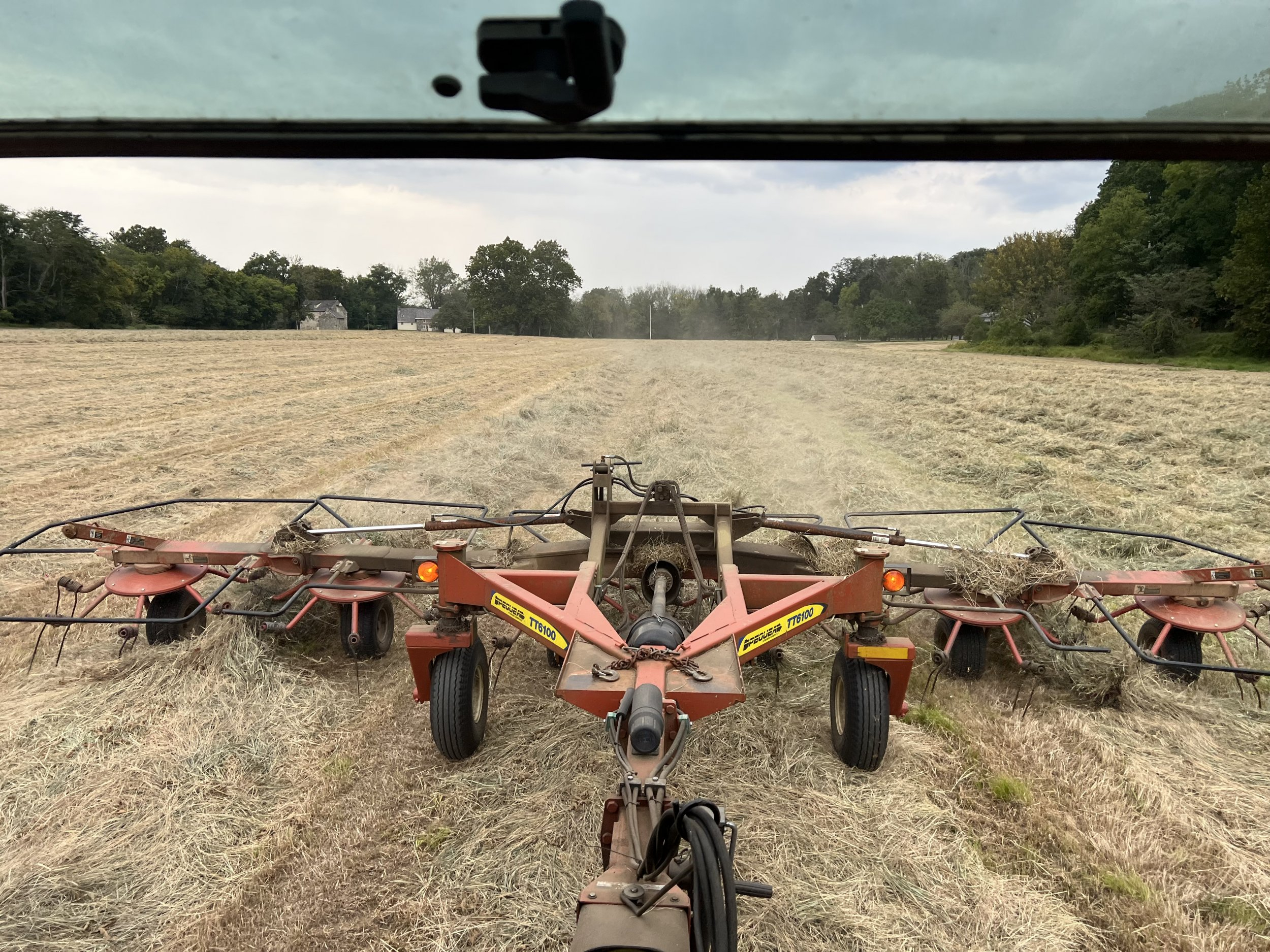

I’ve been baling some “pre-washed“ the past couple of days.
Tedder is getting quite a workout.
/ Second Cutting? #5
I could never figure out the purpose of a tedder. Doesn't it just 'fluff' the hay around dislodging the leaves in the process? Doesn't a rake do the same without such drastic flinging off of the leaves? I had always thought the leaves were the best part of the hay. I am probably missing something........
/ Second Cutting? #6
Once hay gets wet it needs to be tedded to fluff it up and get it up off the wet ground,
that will allow the ground and the hay to dry out.
Some of the older side delivery rakes could be set to ted hay, if raked into a windrow while wet on wet ground it would never dry and cure. Just be a moldy mess.
Yes' the leaves especially on alfalfa have much of the digestible protein and nutrition.
Tedding has too be done with care.

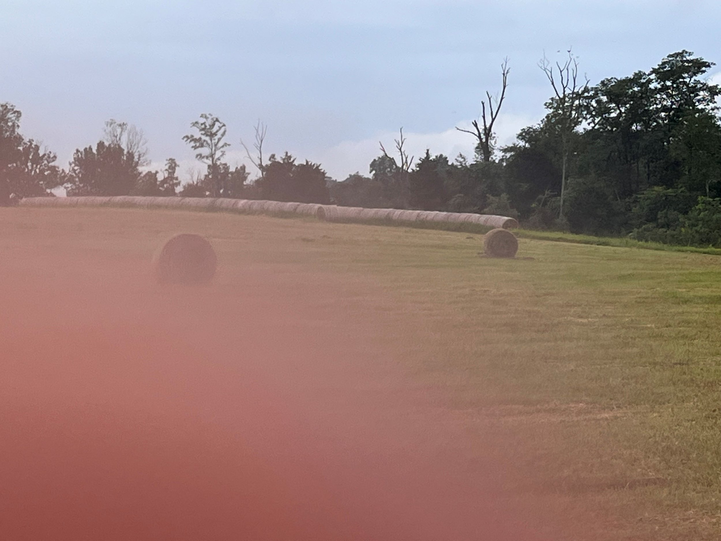

A tedder, if operated properly will not damage the hay. Idea is not to tedder too harshly or when crop is dry. It’s designed to dry out rained-on hay, just like the rained on rank hay in your picture

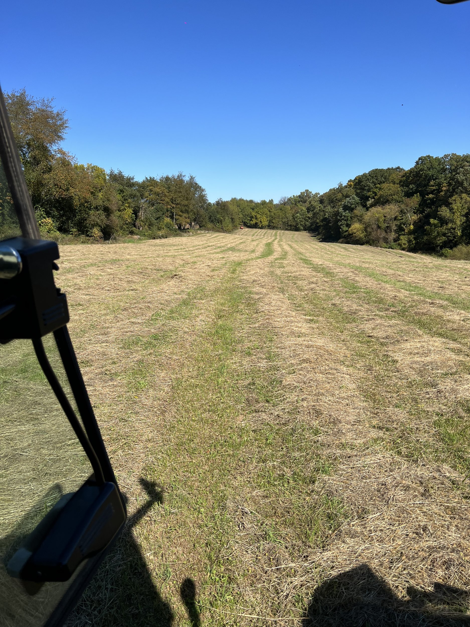

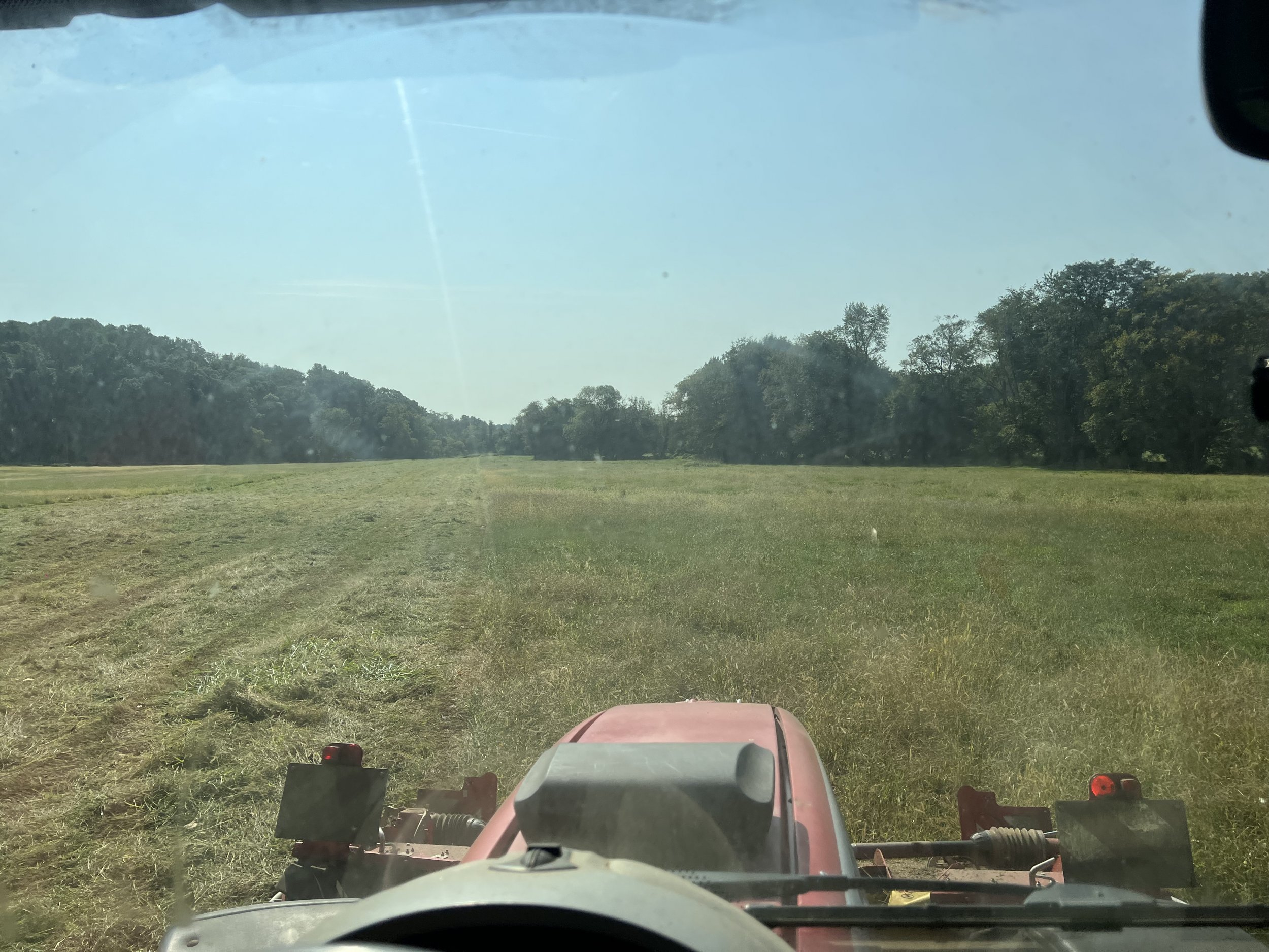

Ripped the lid of this 40 acres today.
Hot & sunny!

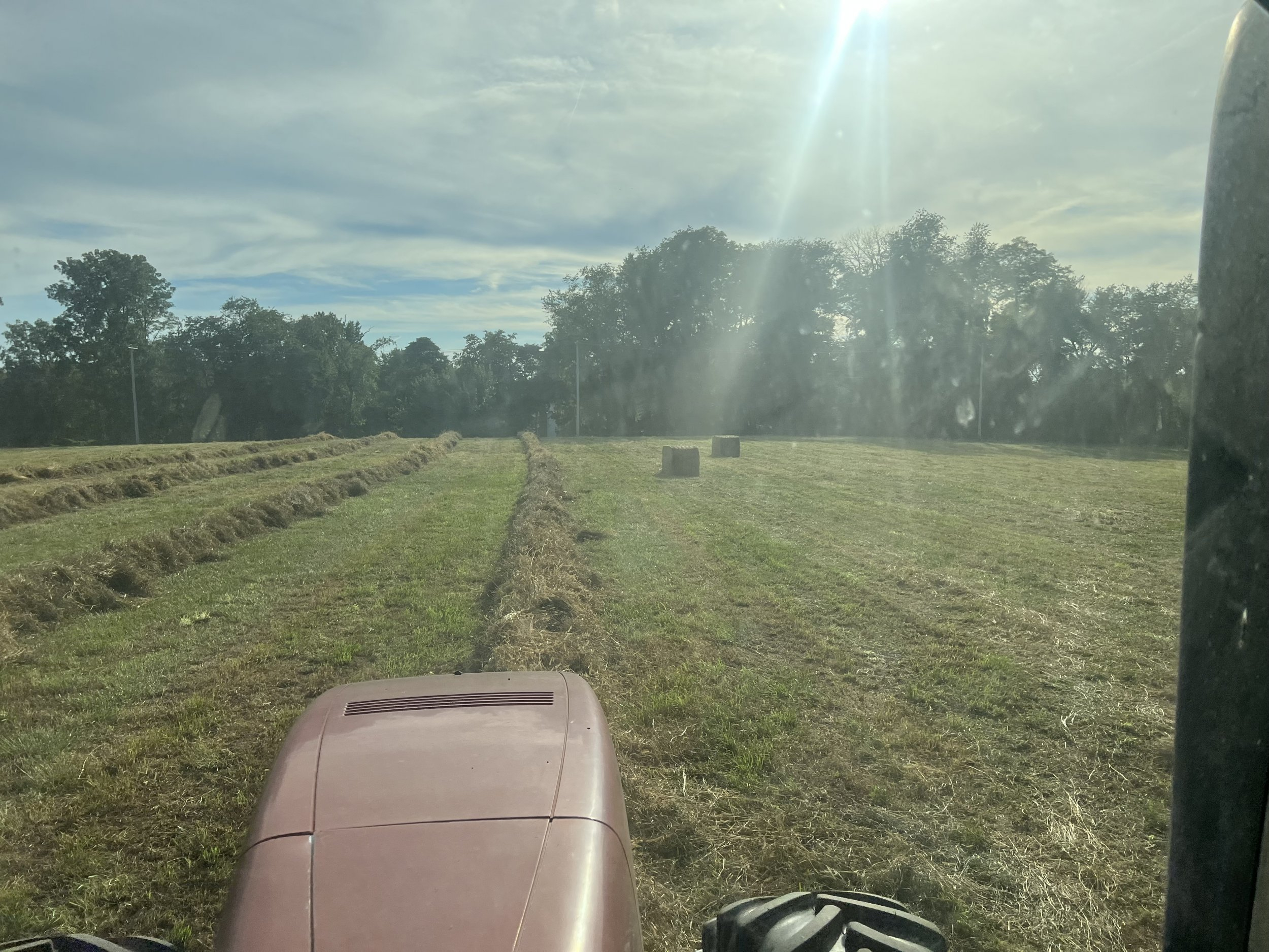

Teddered a bunch today.

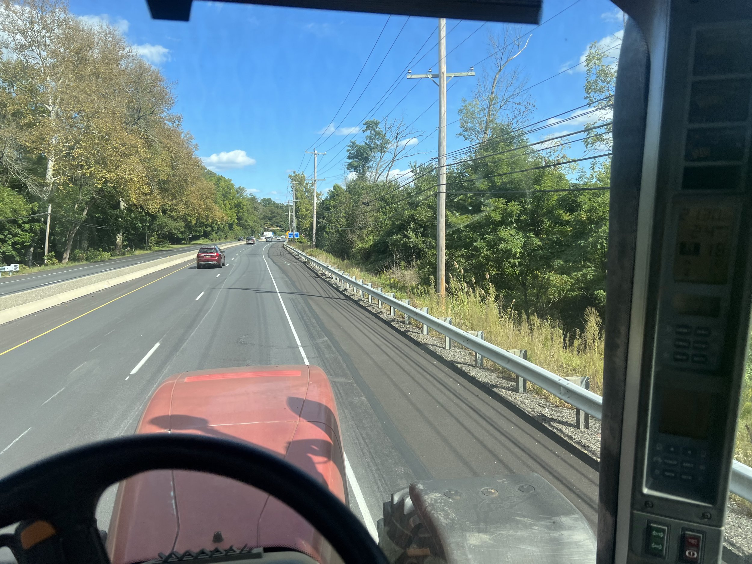

Heading home afther a day of baling in the Magnum with the Krone baler in tow.
She tops at at 24 as you can see in the A pillar, but I wouldnt want to go much faster on our junk roads.

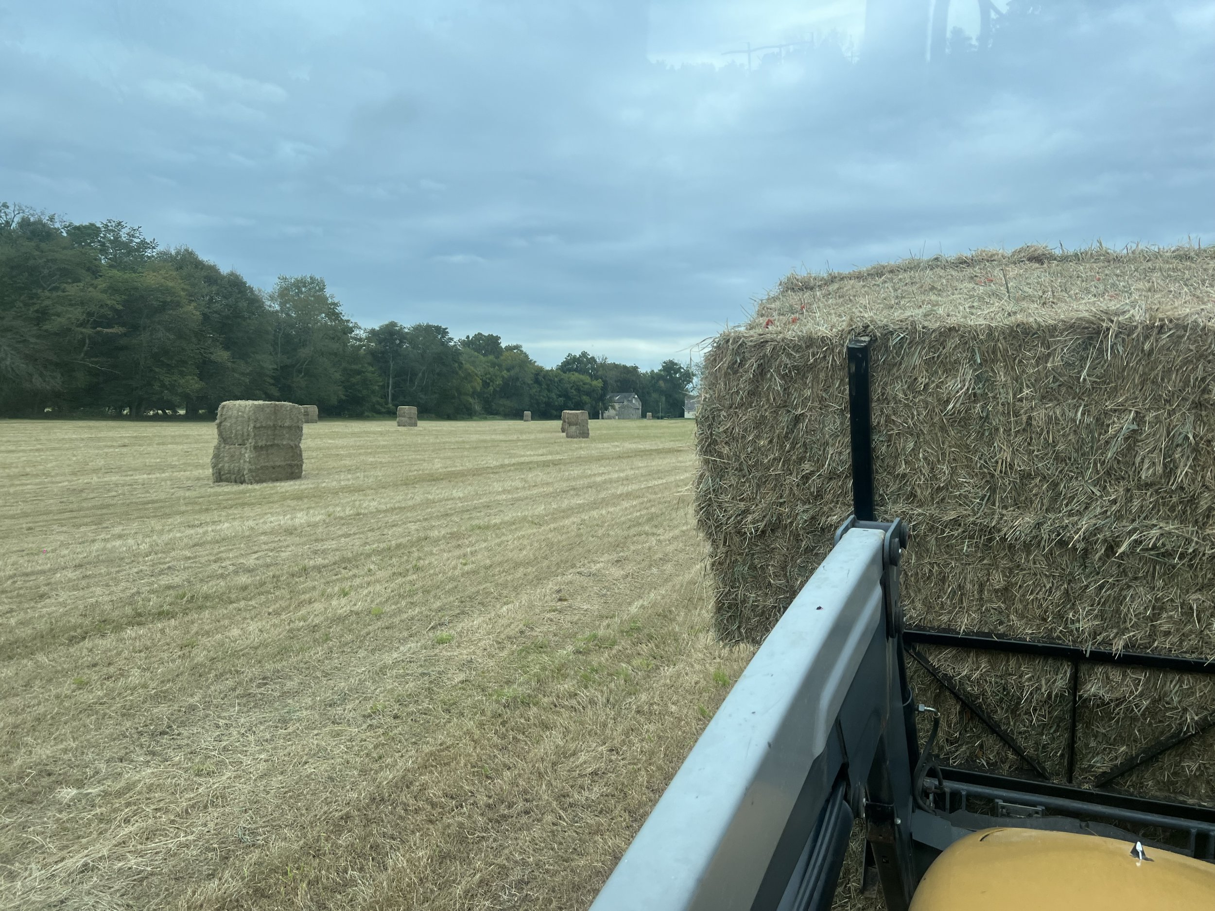

Stacking double 1750 pound blocks ahead of some early afternoon rain with the Challenger. She handles 4000lbs easily on the bale spear and no need to use 4WD anymore.
Weight is your best friend on a Tractor with a loader.
