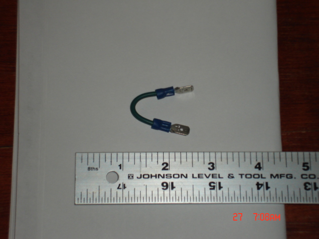

I'm also a lightweight, and also had trouble with the switch when it was quite cold this winter. I made a jumper about 2" long with 1/4" male spades on either end. I keep it handy, hanging on a nail in the garage, and when the switch is having "issues" I just plug it in to the feed from the tractor, then remove it later. Takes about 1 minute.
/ Seat switch on 2310
Thats a great idea, I used it and it works, thanks.:D
