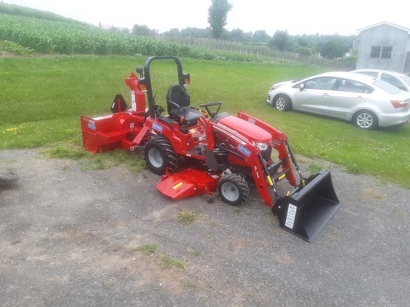

I'm replying here instead of the other thread. The tires in question are Carlisle Tru Power.

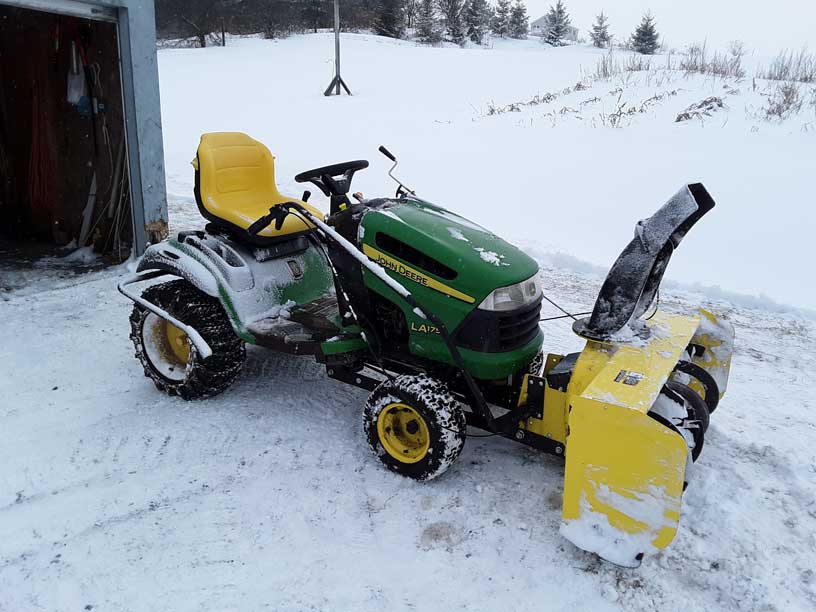

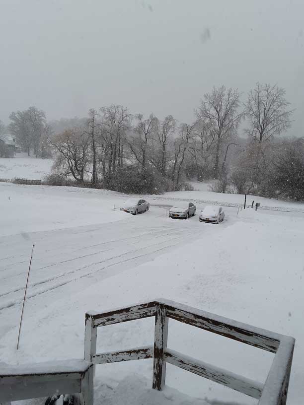

Since your interested in tires for traction on hills, this was one of the reasons that I wanted AG tires on my tractor. I only have 1.5 acres and it is all hill with the exception of where the house is sitting and about 15 feet behind the house that needed to be leveled (cut out of the hill) to put the house in and an area at the back of the property that hired a guy with a bulldozer to cut out of the hill and level off in order to put in my solar panel array. From the road to the back of the property the average angle is 15 degrees (not 15%). There are places that are less, not many, but there are places that are more, some approaching 45 degrees. I mow on slopes that would make some people pee themselves and I've been doing this for 20+ years. My driveway is also pretty steep.
Below are some images I have that can give some idea of the slopes on my property. The JD tractor is what I used to use. The JD had filled tires because without being filled it could not make it up the hill without spinning the turf tires and even with it filled tires and ladder style chains it would spin all the way up the driveway in winter.
I don't know how steep your hills are, but if they are anything like mine I would recommend AG tires. Or I would say to go with something like Versa Turf R14s discussed in the other thread.

I am actually a little bit jealous of those Versa Turfs, which are also by Carlisle. The lugs are at the same angle as an R1 but they thicker and the gaps between the lugs are wider than and R4. The groves across the lugs would improve lateral traction. My only question about them would be how hard the rubber is. R4s are generally harder than R1s because they are meant to last longer on harder surfaces, but this is also a factor in why they have less traction in some conditions, not just the tread pattern. I'm going to have to see if any of the ATV places around me have any of these that I can look at or maybe try to find more information. I'm sure that the tires I have will last me several years, but depending on what I find I may replace all 4 of them when the fronts wear out.
If you don't get a lot of snow and your not concerned about tearing up anything then I think you'd be happy with R1s. Like I said in the other thread, the only thing I find wanting is lateral traction in snow on the front. To be honest I have not seen where these tires tare up my lawn, but I guess that depends on the lawn.
