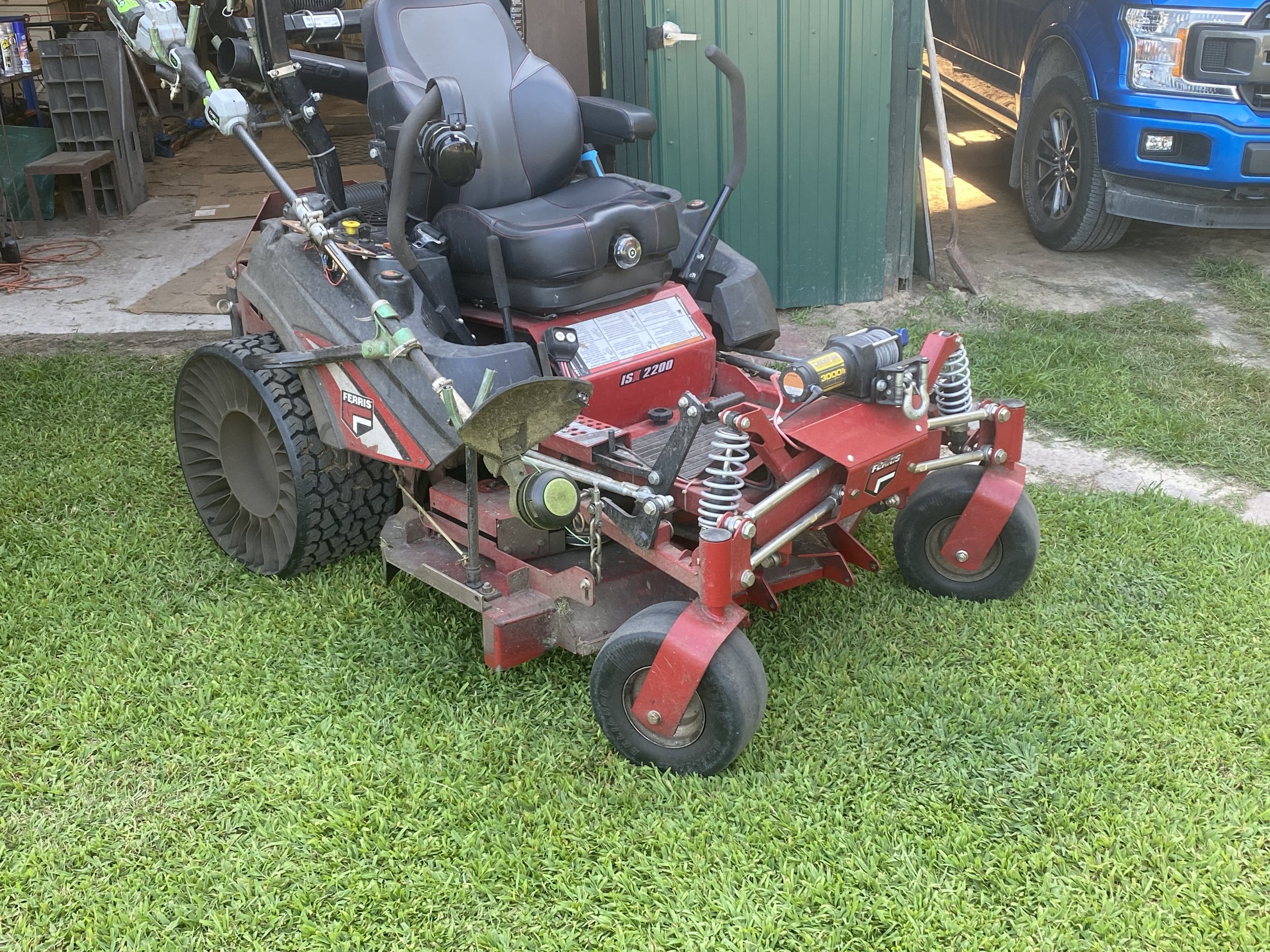

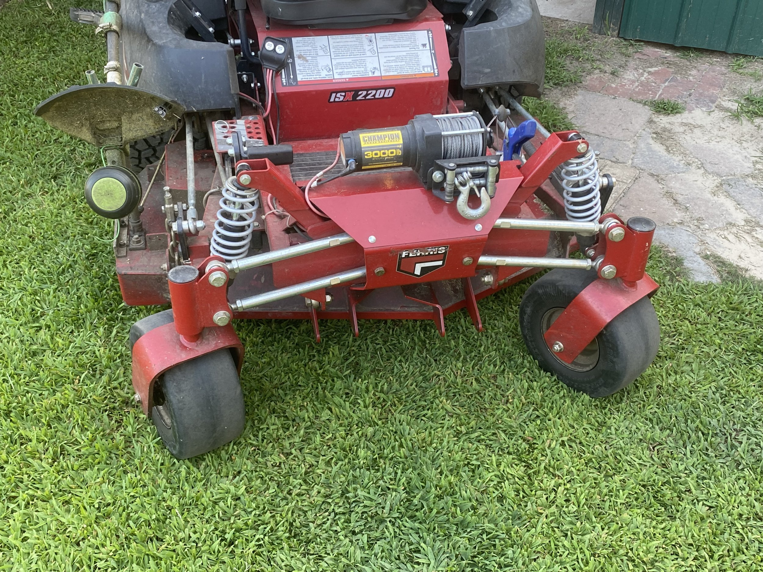

I have a Ferris 2200. Michelin Tweel tires on the rear, no flats on the front (don't have to worry about flats). I had tractor lug tires on the previous, but I get very good traction with these, probably because of the larger footprint. Note the shocks and springs on all 4 wheels, and independent front suspension. The seat is spring loaded, with a dial in front where you dial in your weight. I can go full speed (10 mph) on most terrain and be quite comfortable.
