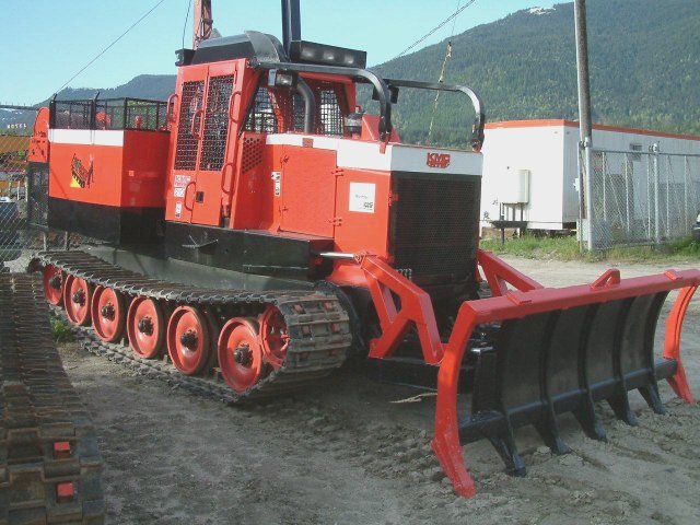

Well Now , If you want to talk " Fighting " the fire , my vote goes this route :
4 speed auto trans similar to the old APC M113 carriers but at a slower top speed of 14 mph. ( nothing like being inside one of the old M113's and hitting a tree at top speed . Crammed all 8 of us into the space that the front 2 were sitting at . )
1300 gallon tank ( No dozer can compare )
And the list is longer of other goodies .
Fred H.
I have never seen anything like that. Do you know who owns it?

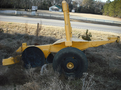

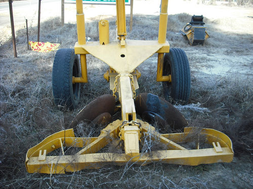

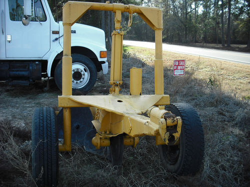

Just came across this on E-Bay. Nifty looking implement and not to hard to build if you have access to the parts.

The machine in fredh's post is a KMC, predecessor to the FMC. A high maintenance, high speed steel track machine originally back in there heyday designed for skidding logs while offering very low ground pressure, or that was the theory anyway. After operating a couple of them for a few years, They are better suited to setting around waiting for mop up on a fire in my opinion.
Older models were powered by 653 Detroits, newer models powered by 5.9L Cummins. Operated both and the cummins power models were equal in power and less noisy, less oil leaky..... did I mention less noisy.
They are built in British Columbia, Canada. See a few set up like that around here and different parts of Montana.
They look real cool, but believe me not so cool when one throws a track or gets high centered shoulder to shoulder to a fire or in front of one, or pull a track in half trying to build fire-line.
They make better mop up machines with there water ability. Let the high track D-4, D-5 dozers with there 6-way blades build fire-lines, routs and roads for crews and the kmc.
