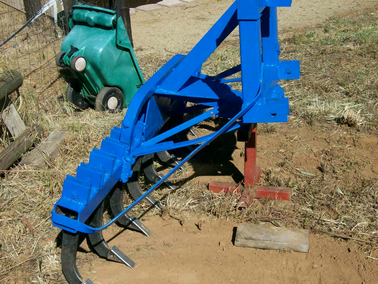

Then/or I use my K.K. 6.5 foot angle frame disk . Notched blades front and back with 500 lbs. of weight added to it . Most of my lines are around 10' , 1 full pass , then half over to complete .
Fred H.

The scarifier FredH shows looks pretty good. You would have to match it to the horse power of your machine. A flail mower is a waste of money. You want to remove the fuel from the advancing fire, not cut it down and let it dry out. The best thing is probably a D-7 with a Rome Plow! Aside from that I would check with an experienced interface (wild-land /urban) fire officer for the best advice. I'm sure there is a good forum for that somewhere on the internet.

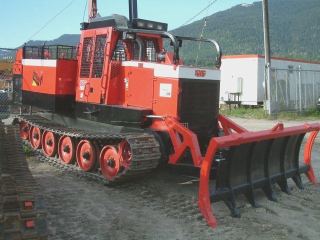

I'm with a few others on a good, heavy disk on more 'primitive' type ground for a fire line tool for a tractor.
BUT, after fighting a few forest/wildland fires the best tool I have used is a machine with an 8 to 10 foot wide 6-way blade..... in prevention and hand to hand combat.

Well Now , If you want to talk " Fighting " the fire , my vote goes this route :
4 speed auto trans similar to the old APC M113 carriers but at a slower top speed of 14 mph. ( nothing like being inside one of the old M113's and hitting a tree at top speed . Crammed all 8 of us into the space that the front 2 were sitting at . )
1300 gallon tank ( No dozer can compare )
And the list is longer of other goodies .
