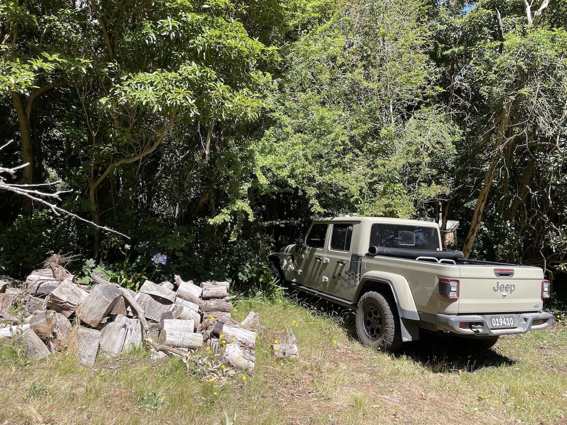

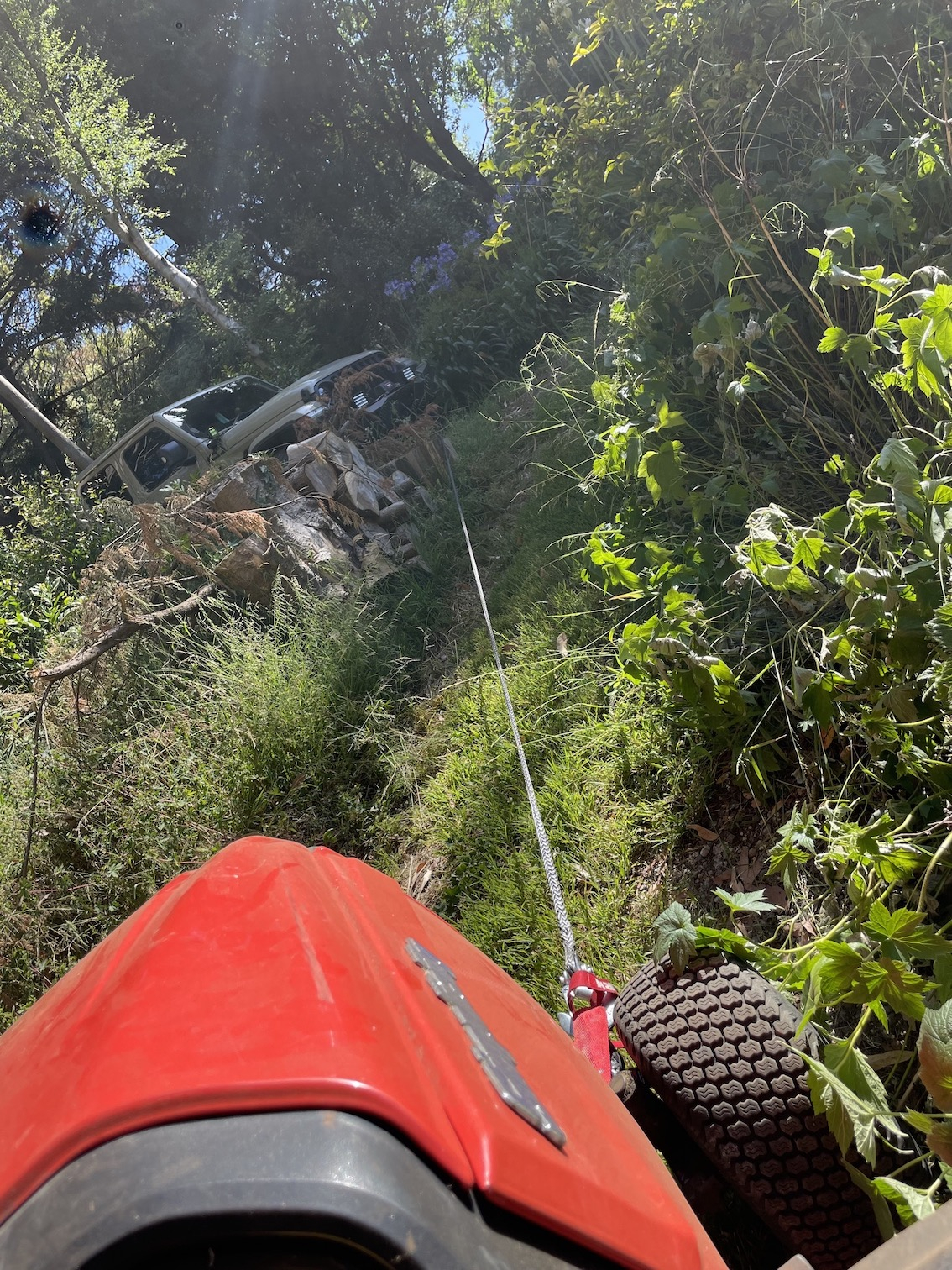

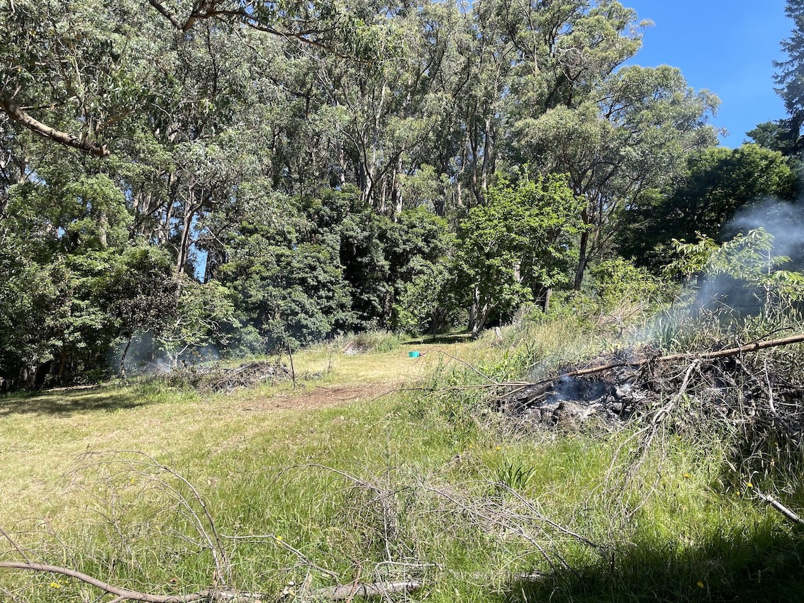

Thanks @Slowpoke Slim @MESSMAKER Yes I'm coming to that conclusion re the slope, 4WD and some weight and I'm golden. A zero turn... you're not wrong but none of my neighbours use them. They complain about slipping downslope when grass is damp, clearance and comfort over rough ground (like exposed tree roots). I expect I'll take the belly mower off when doing tractor stuff and we only have to mow six months of the year.
Here's some pics of the land in case you're curious and a funny one of a shovel I found when clearing it up, and yeah that's me having to winch my mower up to the driveway after my gravel path washed away recently. That was the final straw!

I'm thinking a lot of the areas in your pictures are such that you won't want to run a finish mower over them. At least not the first few times anyway. Belly mowers are like finish mowers in that they don't tolerate cutting down a lot of brush or skipping the blades off of rocks or debris. If your end goal is to have all of it finish mowed, you may want to start off in some of that rough stuff with a brush mower instead of a belly or finish mower. Once you've cut it all down a few times, then it should lesson up in the brush, sticks and twigs, give you the chance to dig out any rocks etc and eventually you'll just be mowing grass.
