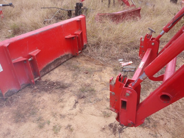

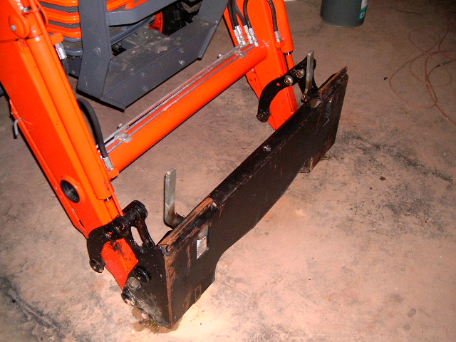

View attachment 439041View attachment 439042
Not sure why you couldn't make the torque tube stronger ?
My QA is strong enough that I welded a chain hook to mine and can use it for lifting at full power and not bend or twist the QA.(these are older pictures, hook was added later)
This is how the SSQA on my JD SS was designed, it had a very beefy steel plate between the loader arms. You would have bent an loader arm before twisting the "timing" plate. I have bent the rather weak rod on my L45 a few times, I now tie down my QA locks with bungee cords to keep them from getting knocked open.

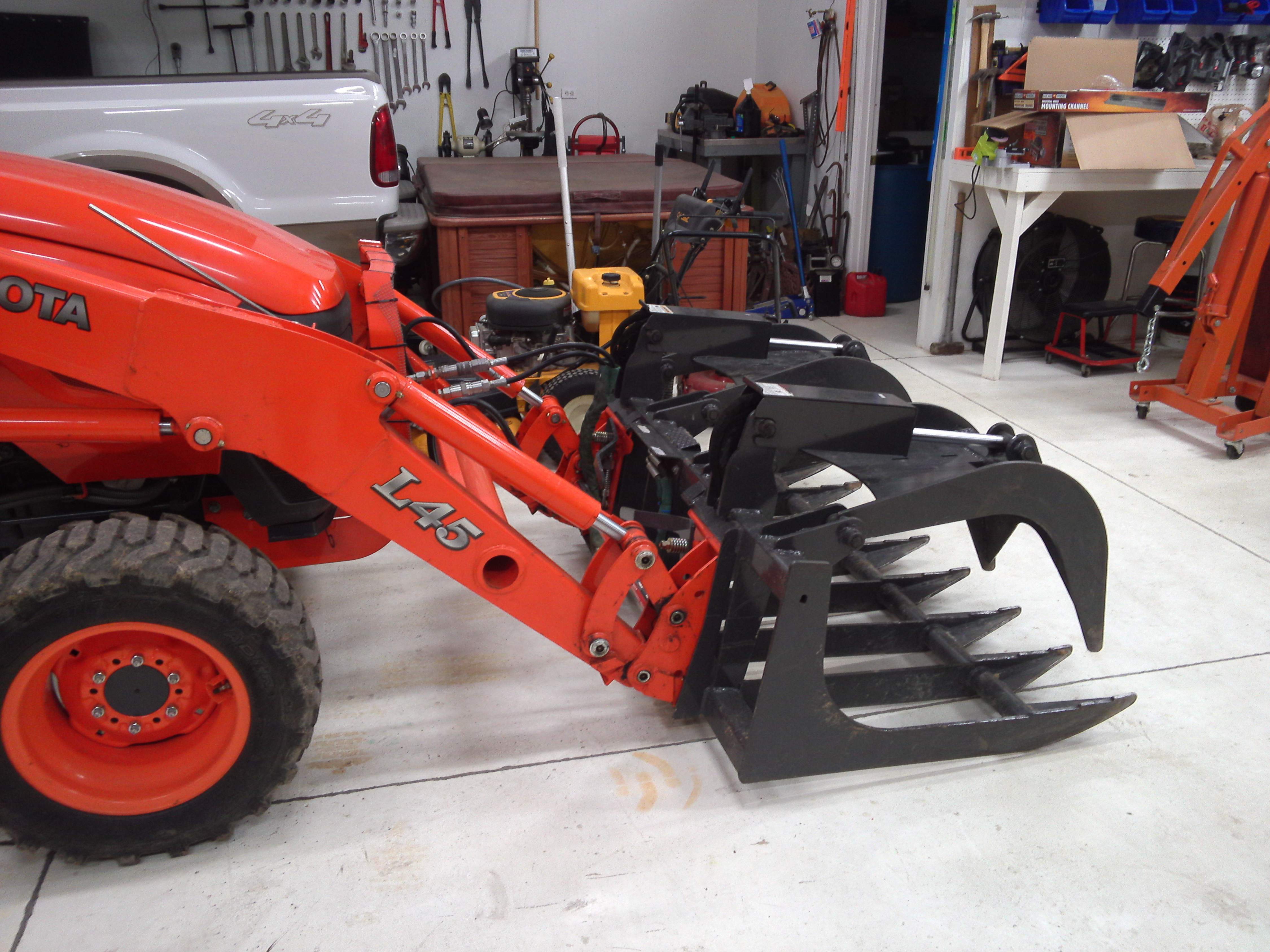

Pretty sure most SSQAs cam over and lock into place by spring pressure, never seen one pop open but when using my root grapple which is on my L45 99% of the time, I have seen limbs stick thru the grapple, hit one of the levelers and pop it open since there is nothing to keep it from hitting the levelers like my JD SS which had a solid plate between the arms. Not a great picture but you can see what I am talking about.
