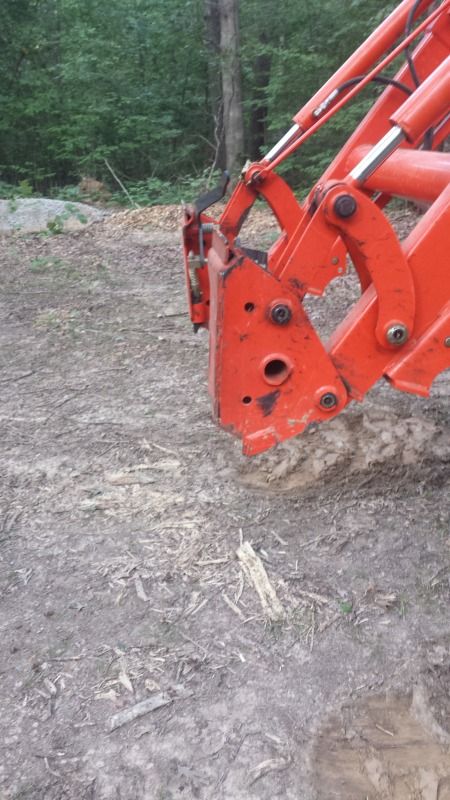

You won't know for sure if you have more "tweaked" parts until you put the loader bucket back on and see if it sits flat. When digging my first pond I tweaked one loader arm and now the left bucket corner is about an inch above the ground when the right corner is flat on the ground. If this is the case, try pushing it straight against a tree, while tractor is in gear.

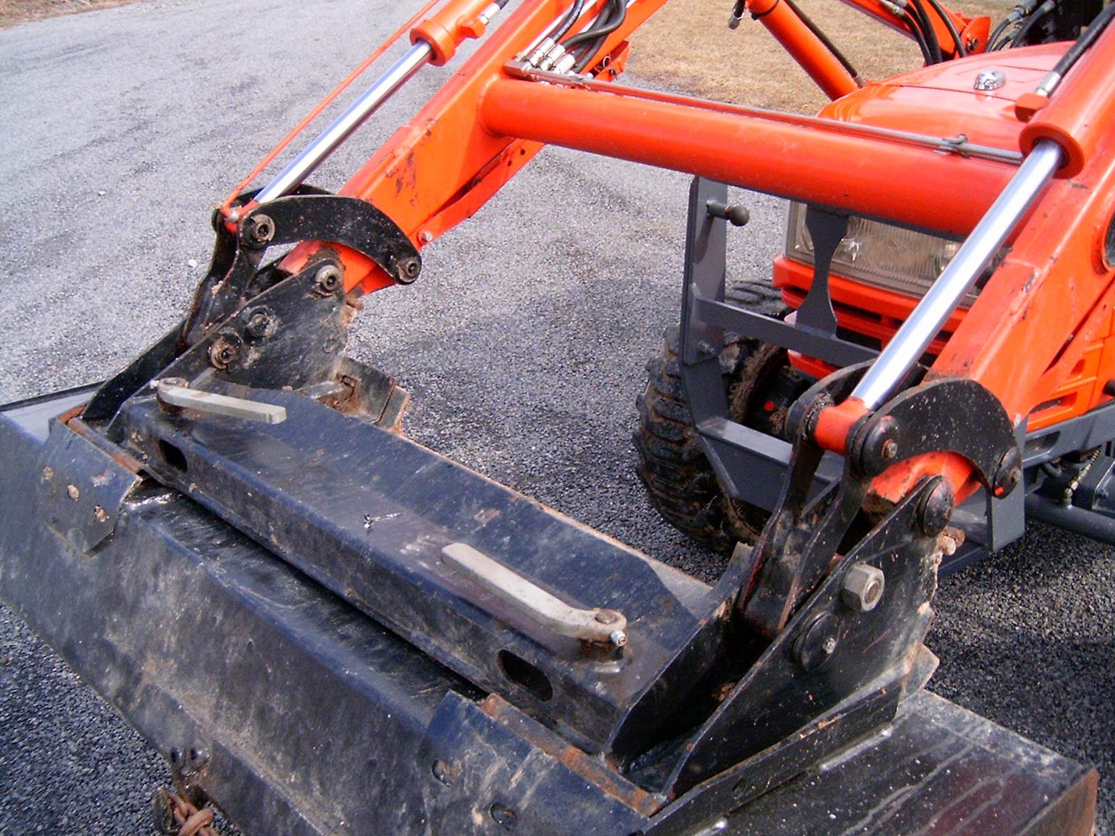

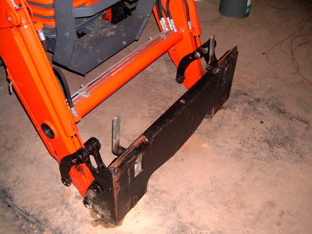

View attachment 439041View attachment 439042
Not sure why you couldn't make the torque tube stronger ?
My QA is strong enough that I welded a chain hook to mine and can use it for lifting at full power and not bend or twist the QA.(these are older pictures, hook was added later)
This is how the SSQA on my JD SS was designed, it had a very beefy steel plate between the loader arms. You would have bent an loader arm before twisting the "timing" plate. I have bent the rather weak rod on my L45 a few times, I now tie down my QA locks with bungee cords to keep them from getting knocked open.

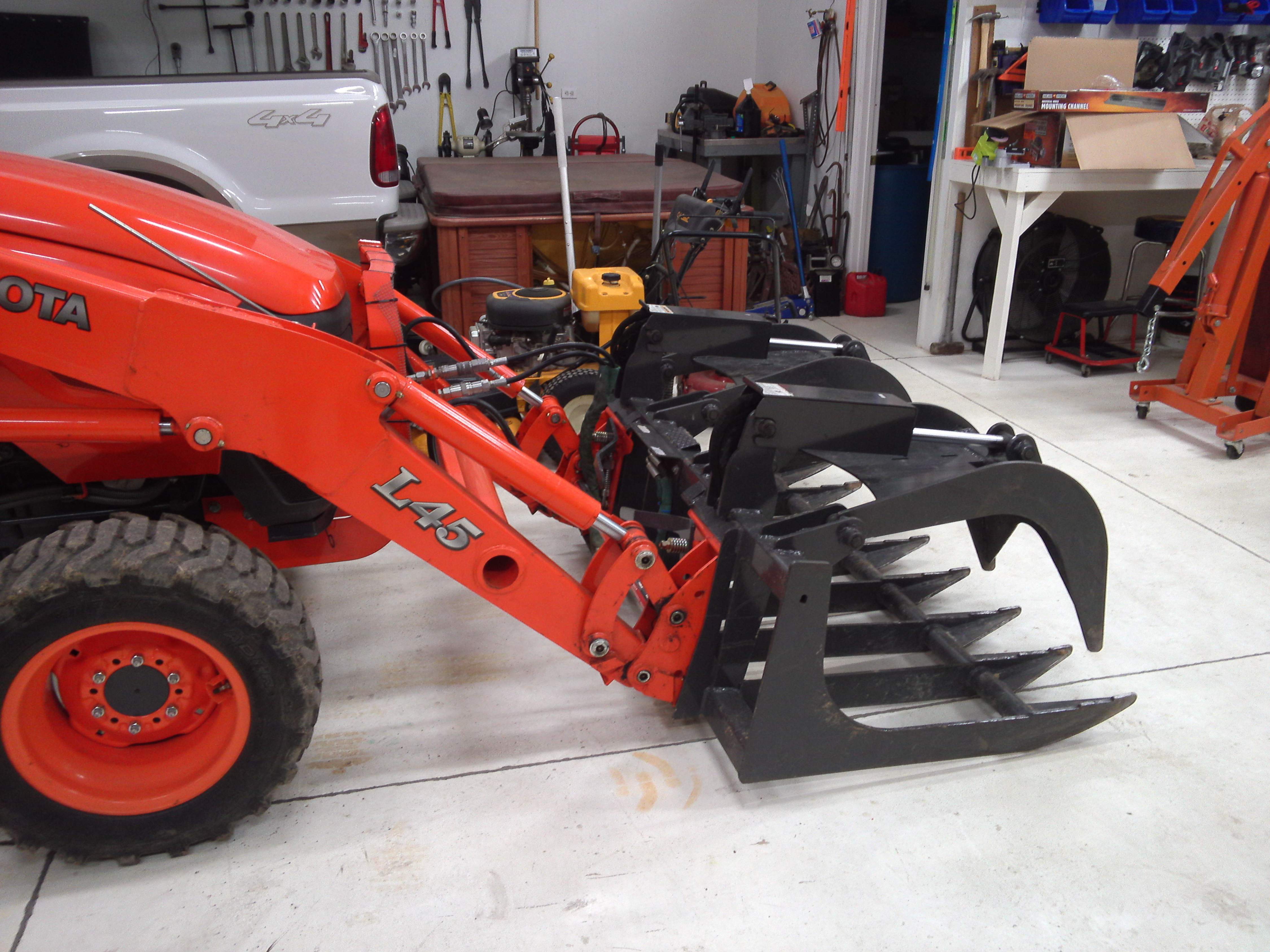

Pretty sure most SSQAs cam over and lock into place by spring pressure, never seen one pop open but when using my root grapple which is on my L45 99% of the time, I have seen limbs stick thru the grapple, hit one of the levelers and pop it open since there is nothing to keep it from hitting the levelers like my JD SS which had a solid plate between the arms. Not a great picture but you can see what I am talking about.

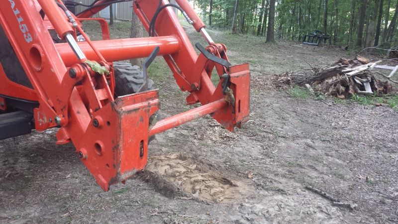

I've got it lined back up....almost. It needs to be twisted just a bit more, but try as I may, it doesn't seem to want to go that last bit. I can use the grapple, but the right pin will not stay position all the way down. Creeps back up.
Thought of putting a large pipe wrench on the torque tube, add a pipe to it to give some leverage to torque it back a bit more. Don't have a large pipe wrench though. Thoughts?

Sure--get a long enough lever on that sucker and you can twist it right off. Your tube can be straightened, but there's no going back on the steel's memory of the event. It'll be more susceptible to taking that same twist again if the conditions occur again. If the QA is that subject to popping off on you, make sure you correct that. The bucket/grapple/forks should tie everything together pretty good, stressed or not. The tube's meant more for keeping your arms positioned than strengthening--strength in the loader runs vertical. Glad you avoided paint removal/rewelding, etc.!
Our skid steers at work are the same way.
We wrap chains around the QA torque tubes and lift/pull with them all the time.

Yes, it's occurred to me, that even IF I can get it twisted back right, the tube is weaken.
What's everyone thought to welding a .... say 3x3 section of angle iron to the tube once I get it right?
