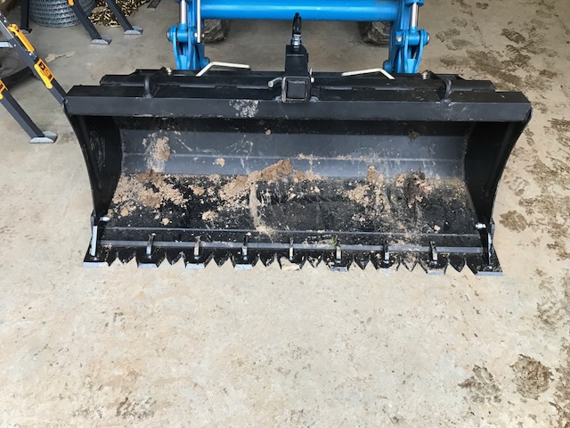

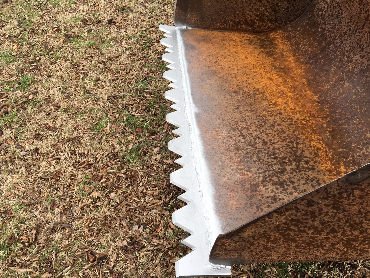

We have a great scrap yard. No telling what treasures you can find. They have selection of steels, SS, aluminum, copper, exotics, bolts and hardware. Sorted and price accordingly. High carbon steel is more valuable, priced higher and they know their material and market. Steel is quite variable in its use and physical characteristics.
A bucket edge is very demanding of the material. All the force from your tractor’s weight, momentum, lift can be transferred to a single tooth.
The Piranha bar is usually sold as a bolt in tooth bar. They made a special weld on bar for my application.
When they make a bolt in bar, they have to bend the bar blank into a U while welding on the tabs the clip to bucket cutting edge so the bar is straight after welding. Spray weld transfer to get the penetration. Just few of the many engineering design and fabrication techniques developed that created their product.
