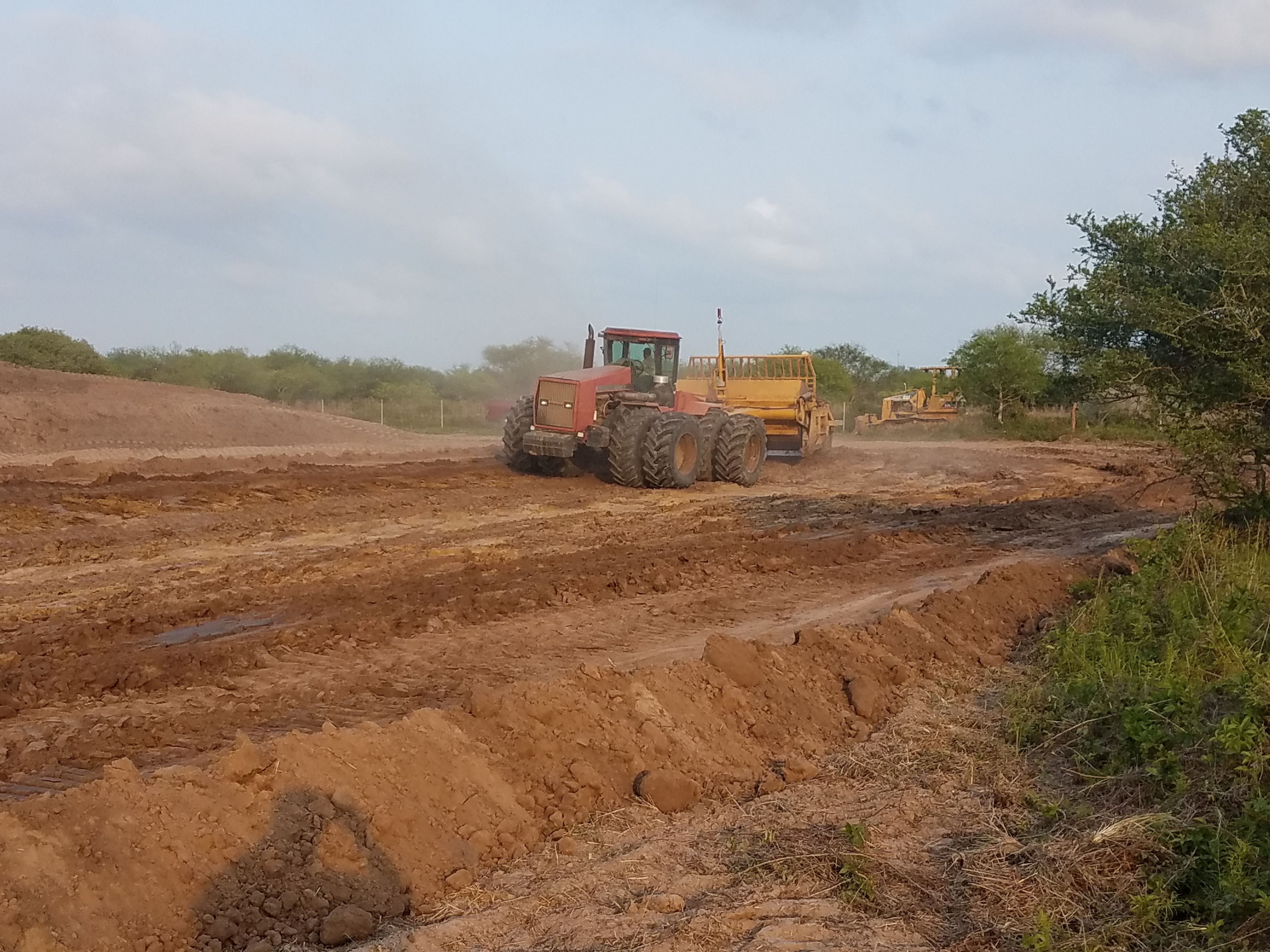

I have a land plane (your second photo) works great for the gravel drive but will not move much dirt. I believe that was speaking of the box blade as the one that will move dirt. We built up the area for our house and shop 18 inches and hired it done. It took two weeks a Cat and the below outfit. We moved a LOT of dirt. Can't imagine moving that much with a smaller tractor. Hoping you do not need to move that much.

I can see where that could be manageable. Our pad for the house and shop was quite a bit bigger due to how we did things. Raised it around and between the buildings so we could control the water better.
