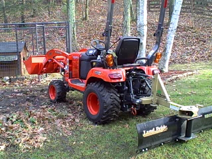

I run a 5ft Land Pride on my BX 25 with no problem. I think you got the same HP on your tractor as mine--23.
