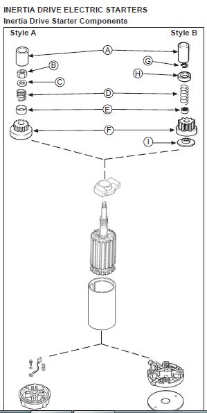

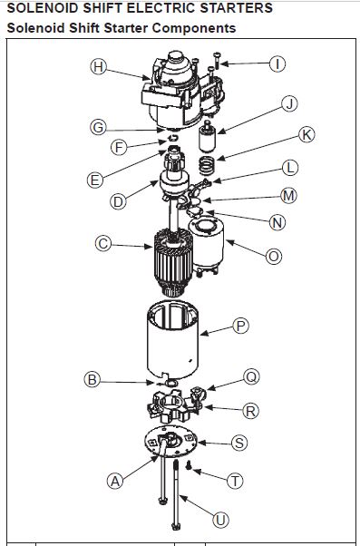

Which starter type do you have?
THIS?
OR THIS?
Richard
