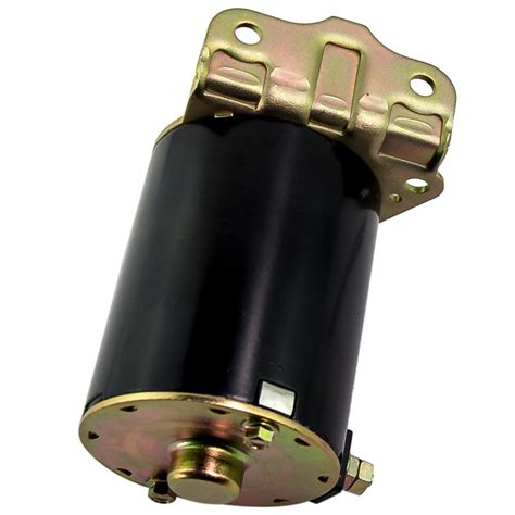

ONE LAST QUESTION or POINT... the 'new' (and old) starter sit on the right side of the engine and
are connected by two torx bolts (I forget the exact MM size, but it has a good head). So the, as
sitting on the side of engine looking at starter, right hand bolt sits almost behind the starter cog.
I was able to screw in very tightly the 'left' bolt, good access, but this right hand bolt is almost
impossible to see or access... ANYONE with a Scotts 2548L have any experience with this starter
location and accessing that last bolt (right now it is not in, starter very solid but want both
bolts in)... I have attached a pic from 'behind' the start so you can see the offset of the bolt
holes... I tried putting the difficult on in first but it was also just as hard. Anyone do this?

No experience with the Scotts itself, but that is a very common starter mount design and issue.
Anyone that has done much mechanic-ing has often encountered bolts that you can not see, can not reach and are just a PITA!
Patience! is the name of the game.
Try getting the first bolt in and snug not tight starter should still be free to pivot but not flop. Then perhaps using your torx bit in the bolt head (sometimes taping them together helps keep them together. Wiggle the starter to get the second bolt and hole/threads aligned. If using a ratchet based torx bit, an extension may be helpful.
