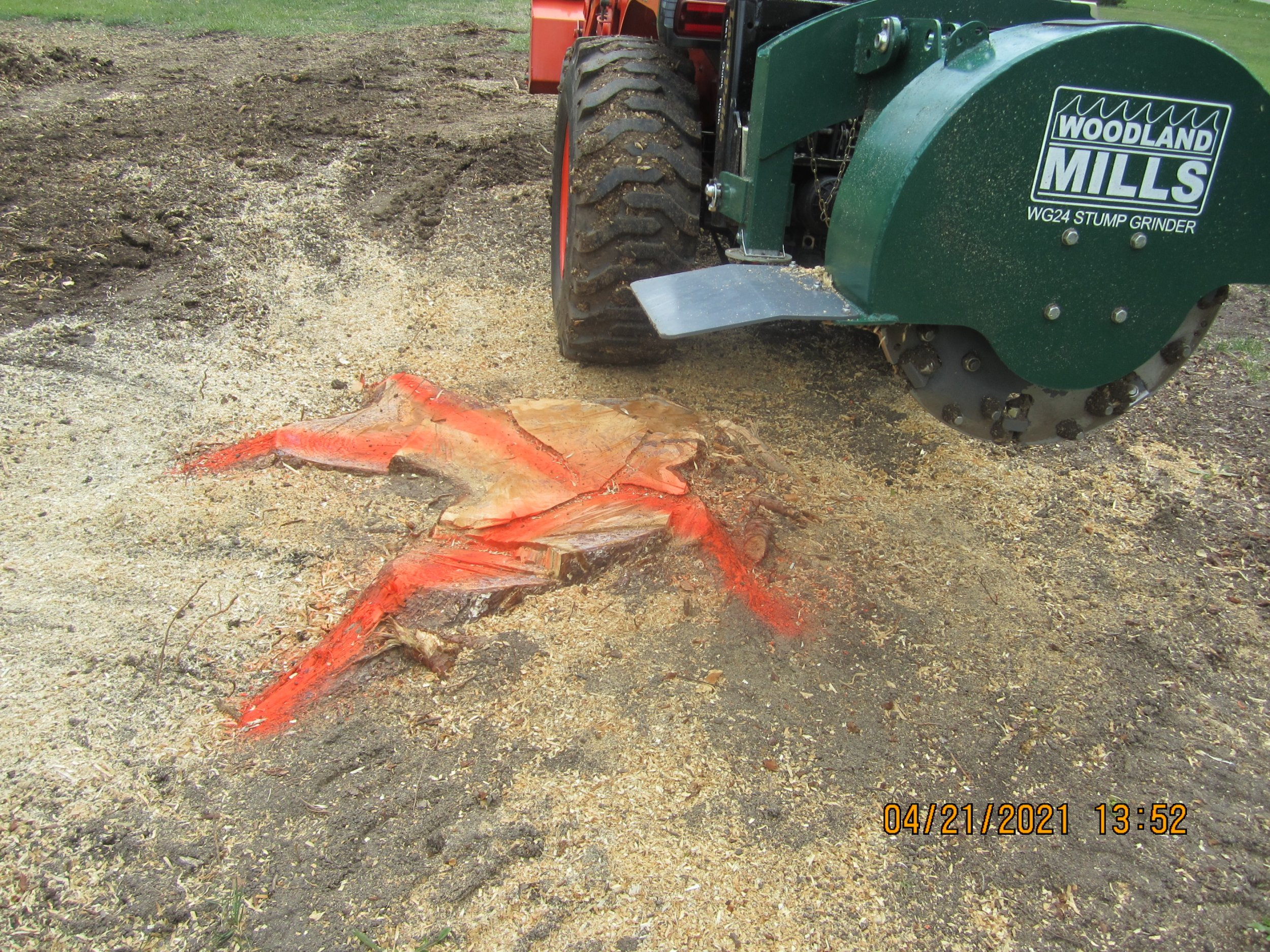

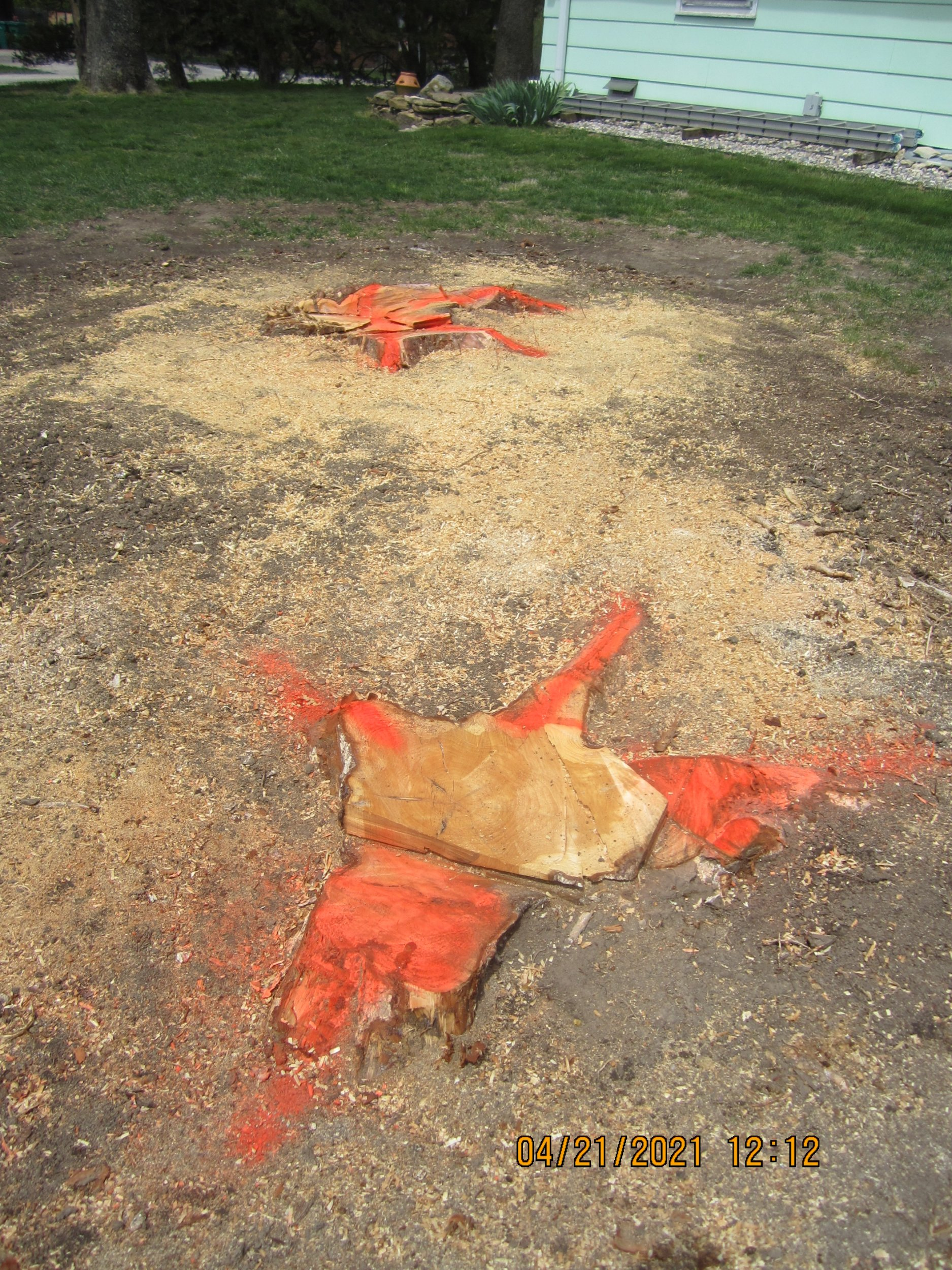

I too let them rot (my 3 acres) if they aren't in the way. Otherwise they get the Stump Grinder treatment.

If that grinder took care of your problem, I should be in pretty good shape (whenever it gets here). Those are some pretty big stumps you grew. I'll have one maple about that size then a bunch of poplar around 16 inches.

I've done eight Lombardy Poplar. They were piece of cake. Also have done some
Redbud. Russian Olive, a couple Apple and several species of Pine. ... around 40 total in all over the past 4-5 years....IIRC
Never did the scoring as mentioned in the title. I'd have to agree with 4570 Man on that....now that I think about it.
