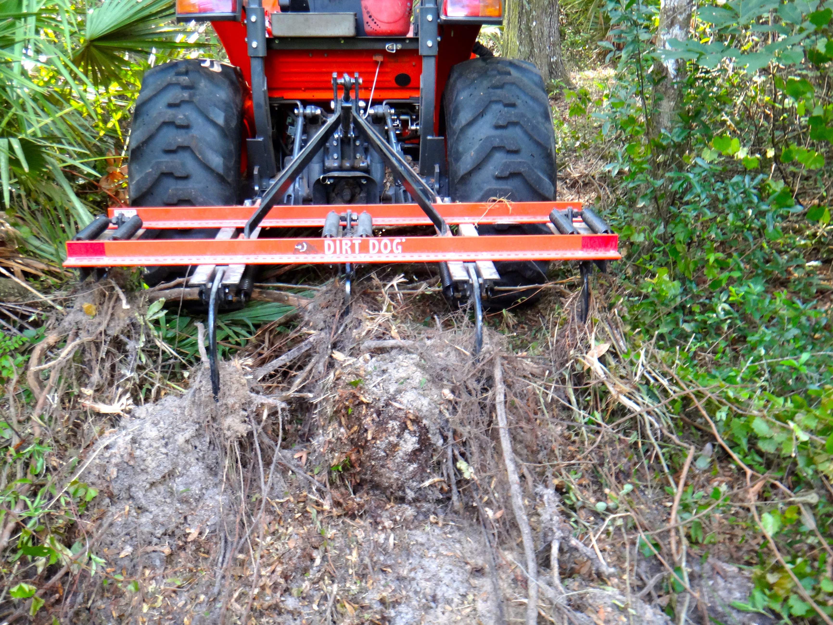

Three Point Hitch implements have at least two widths: 1) overall width and 2) operating width.
In most cases you would want implement operating width to be at least as wide as rear tire spread or a little wider.
My tractor rear tire spread is 60". In order for my Field Cultivator to scratch out rear tire tracks I had to order 66" overall frame width.
Some adjustable implements, like Disc Harrows, have varying widths depending on how aggressively the gang angles are set. With a Disc Harrow doing field work you would want the minimum operating width (when the gang angles are set as aggressively as possible) at least as wide as rear tire spread.
