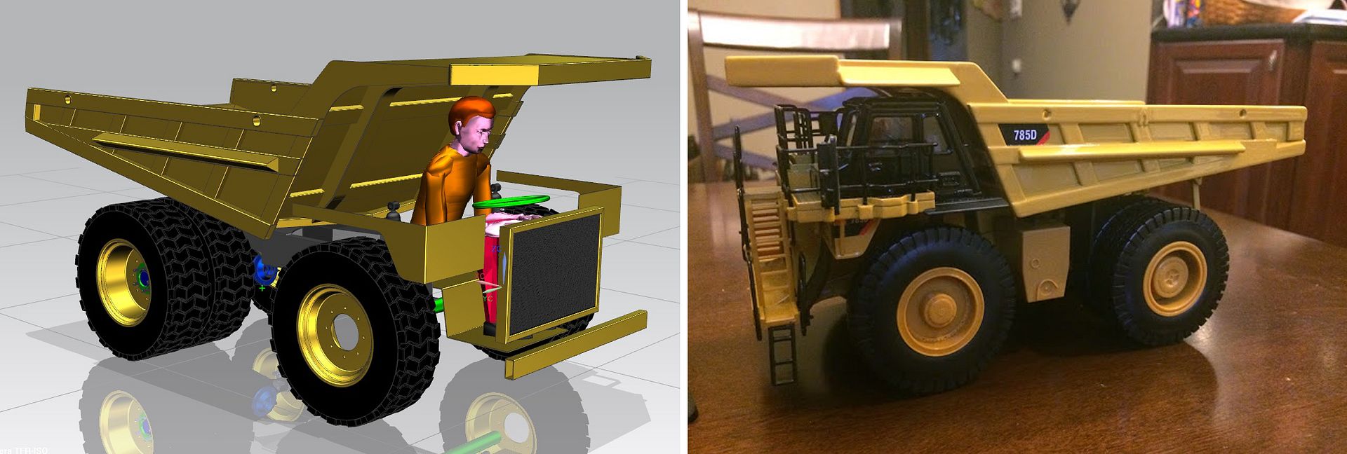

It's been a little while. Been busy with two kids. Speaking of which, I can't build a dozer for the one boy and not build something for the other.
So I've started on this.
I still have some design work to do but I can only get so far until I start buying parts so I can model them properly.

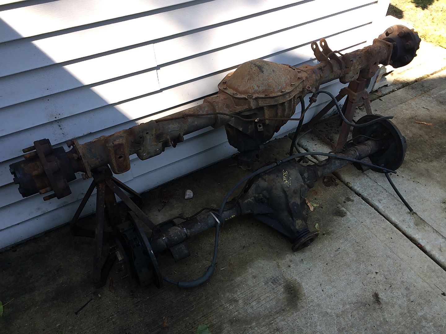

First up? Some axles. One is a GM 14 bolt full float axle and the other is from a 2wd S10. I have a plan to graft them together and will show more detail soon.

Still probably a few weeks before I can start making sparks or chips in the garage. I have a pretty good idea how I'm going to meld the two axles together. In the end, it should look like this.
The center section, axle shafts and a few inches of tube will come from the S10. The spindles (and a portion of the tube) and the hubs will come from the 14 bolt.
