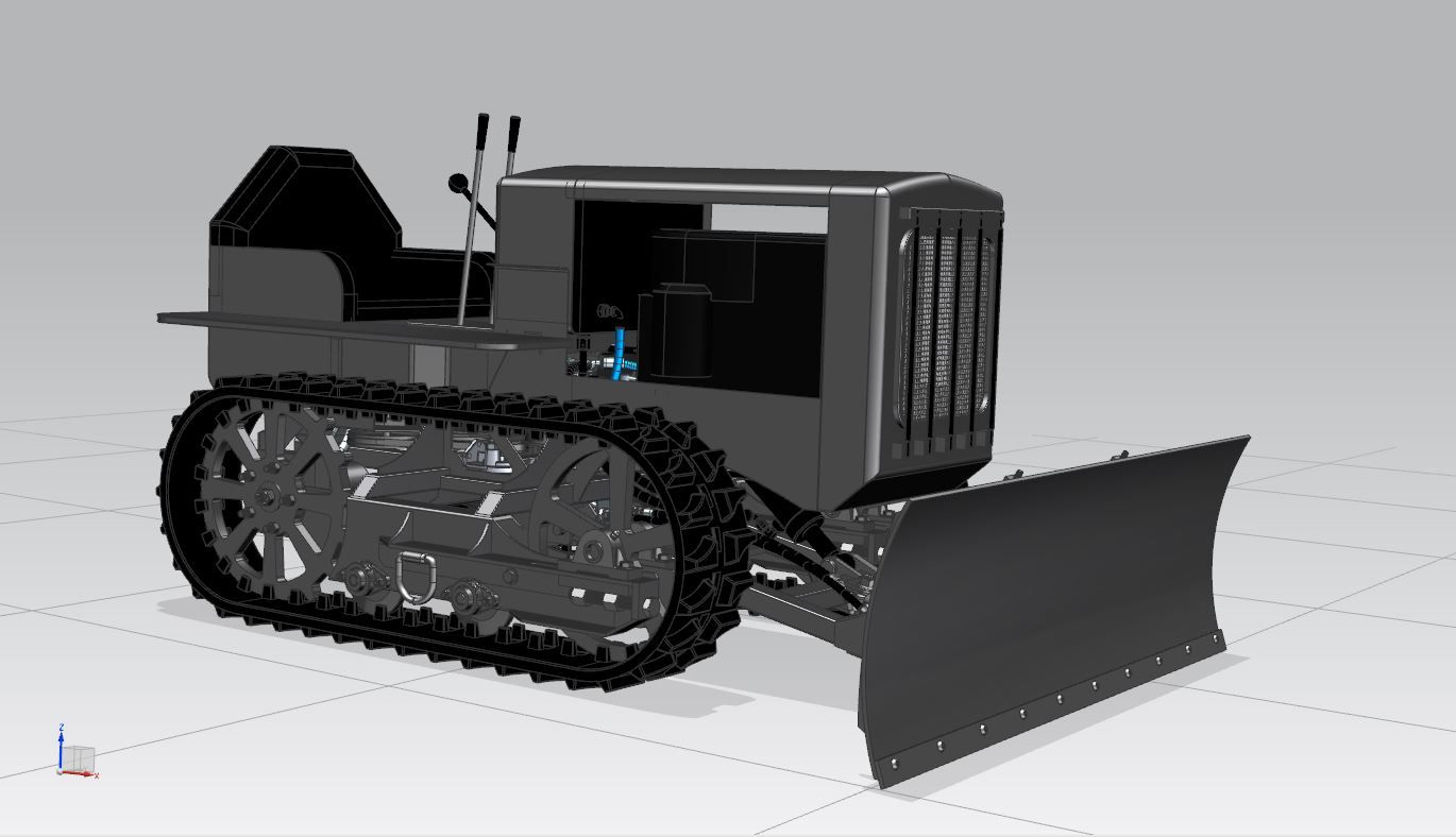

Sorry it's been so long since the last update. Still working on the plow design. Still struggling to make things fit but it's getting better. The hoses have been the hardest part actually.
I'm still not done but here is where I'm at as well as a few stats.
48" wide blade (dozer is 35" wide).
50 degrees of total swivel.
8.5" of blade lift.
Spring loaded for plowing snow in the winter but will lock for the summer.
Hydraulic lift and swivel.
There have been multiple changes but I think this is what I'm going to stick with. I've struggled to figure out what this thing is supposed to be. It started off in my head as a much smaller, lighter, possibly battery powered dozer. Just a toy. It's gone way overboard. Obviously. But it still isn't because I need it. I still don't own any property and if I really did need to do actual work, my brother has more powerful equipment. The only useful work this thing will actually do is plow snow. Other than that, it will be for fun letting my son push around loose piles of dirt at my brothers house and taking it to shows. I've had a lot of fun designing it and building it. If I made it easy, it just wouldn't be any fun.
So here it is.
I have and will continue to see things that I don't like anymore or want to change but there is going to come a point real soon where I'm going to have to live with the design and move forward. I hope to wrap up the design by end of next month.
Thanks for looking.

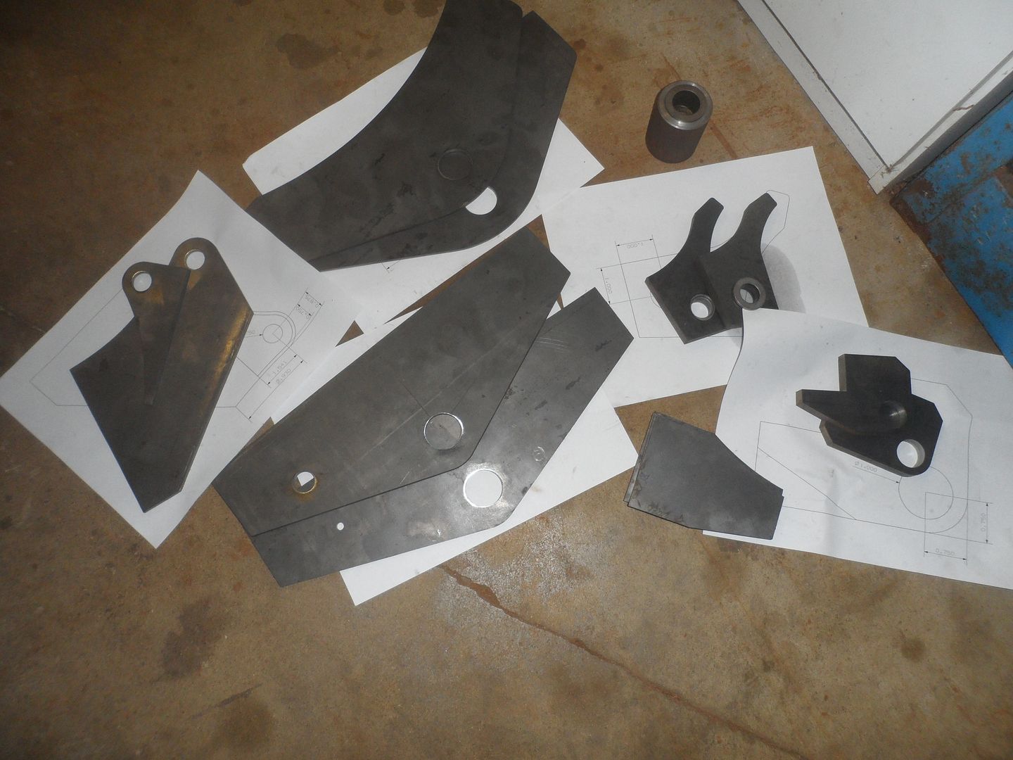

In an effort to save some time, I made a visit to the waterjet table.
I finished drilled all the holes though.
Then I started putting some things together.
Been turning a lot of pieces on the lathe as well. I've been making some decent progress just haven't been taking a lot of pictures. After I got it running, I feel that going back to posting pictures of pieces of steel is a little boring.
My brother in law is working on rolling my plow and cutting out a few more pieces. I also need to get moving on my hydraulic parts order.
Also, now that the end is getting somewhat near, I need to start thinking about paint. The real dozers have metal tracks and the whole thing is painted yellow. Being that I have black rubber tracks I wasn't sure how it's going to look.
I've done a couple of different colors schemes. I'm between #2 and #3.
I did a grey one like the Model Twenty I saw at the Caterpillar visitor center. (And a darker grey just for the **** of it). Just to see what it would look like.
