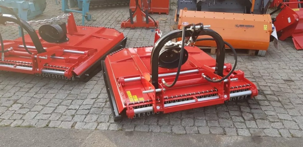

We don't have bat wing mowers here as we need compact stuff to move around in tight corners. This style of mower go as wide as 2.50 meters ( around 8ft). The wider ones will have two spindles side by side which reduces the length of the mower by a lot, thus making it more maneuverable. Some manufacturers will go as wide as 13 ft but at a much higher cost.

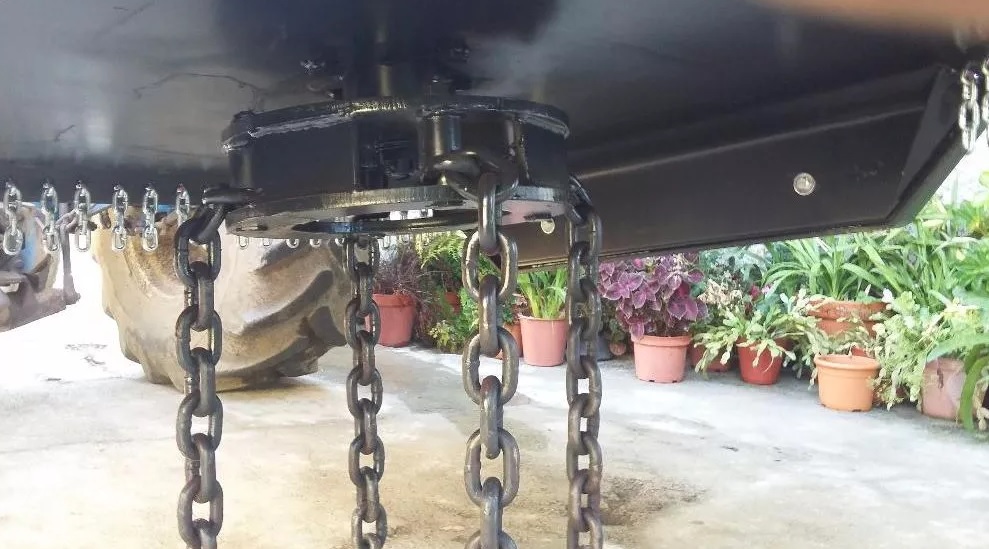

I can't quite remember how the spindle/rotor is set up on your style mower, but I don't think it would be too difficult to retrofit the chains, as long it's used some nice quality and high strength hardware. The thing with mowers and chains is that once you flip the switch to the On position with electric over hydraulic PTOs, the chains slam hard on the top sheet metal making a huge bang. But not a big deal.

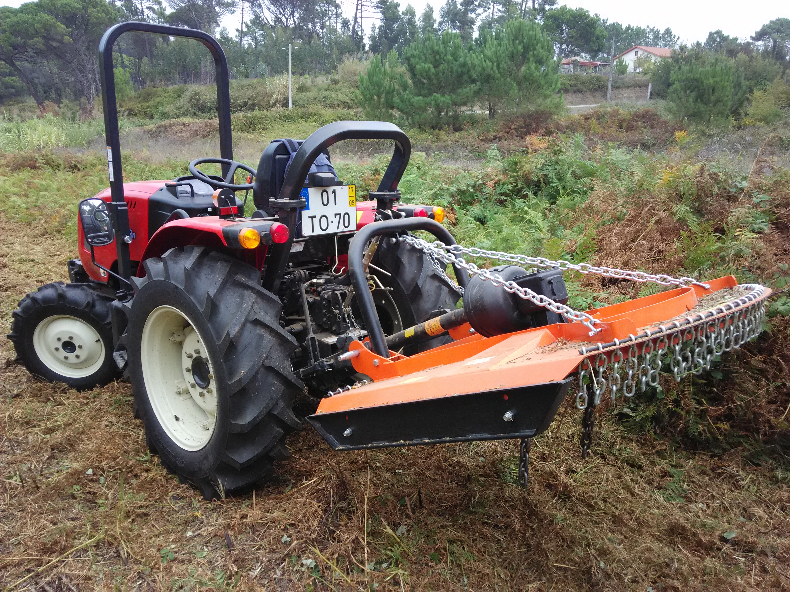

First, let me clarify that those mowers are never intended to use as finish mowers. They are mowers built for land clearing. They will eat everything in their way.
The reasons we use high strength chains, instead of blades are that chains can handle rocks easier than blades and chains will also shred the brush to pieces. But then again, it's not a finish mower and won't leave a nice finish. The small chain we use is 3/4" high strength chain. It will get bigger size chain with bigger mowers.
We run our brush mowers hard. We use them as true brush mowers instead of a finish mower. Having a tail wheel, would mean that it would be destroyed in a matter of a couple hours. We back these things up close to walls, trees and some hidden stuff that we can't even see. These mowers are built simpler and strong.

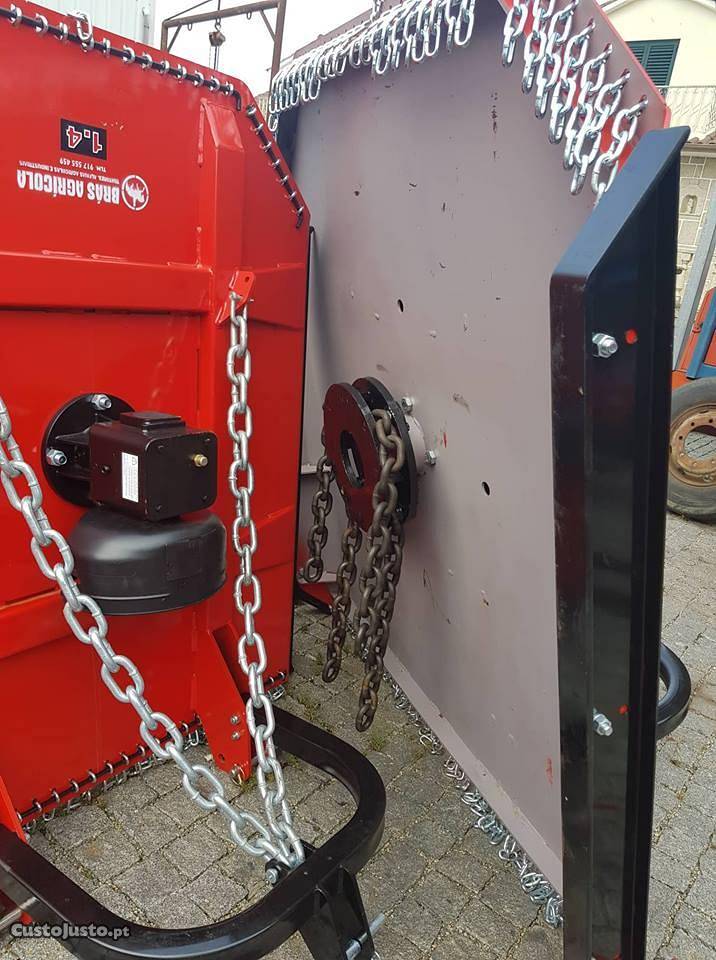

Most models come with 2 chains, but we can also add another 2 chains making a total of 4. Usually used with higher HP tractors. There are also some manufacturers that make a spindle for 3 chains but it limits you to always use 3 chains. Others also have side shift ability.

Chains will eat lots of HP, so we just get the mowers either the width of the tractor or about a foot smaller, depending on the tractor's HP.
