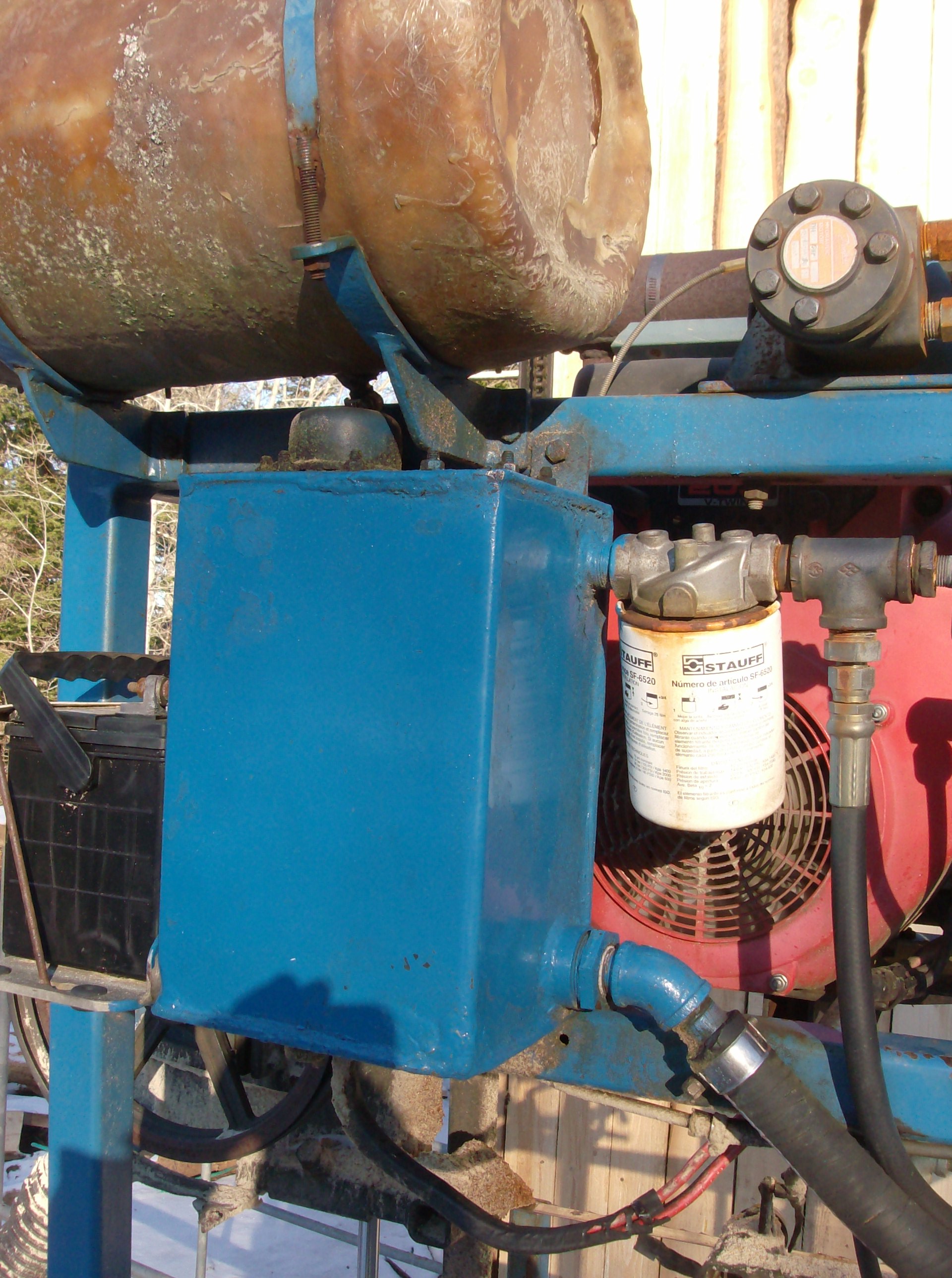

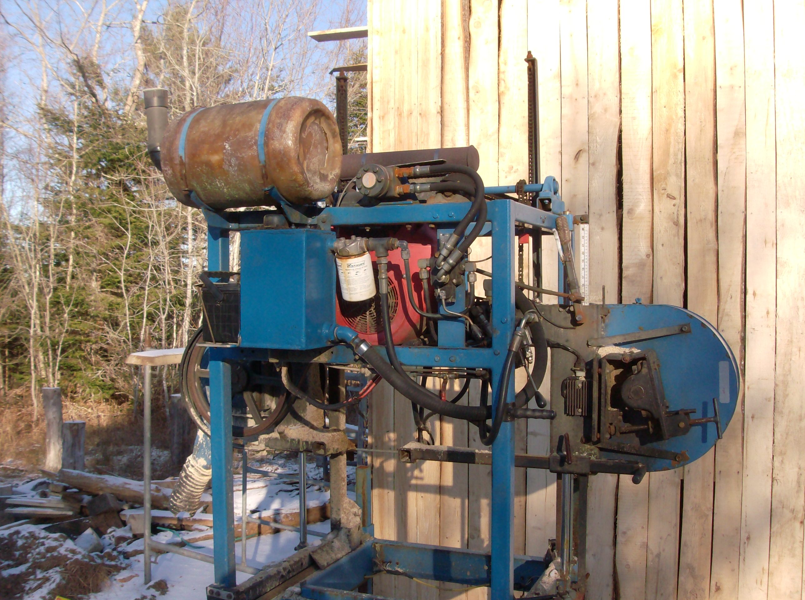

Ya.. the snow plow hydraulics froze this morning.. had the Pepto look. had to drain fluid and refill.. oh well at least it won't have heart burn.... i don't think Cantire will have the filters, may have to get them from Halifax or Moncton, try Parts for Trucks to see if they can cross it with a Baldwin filter
/ saw mill hydraulics #23
You might have to flush with something like this.
1 quart atf ( type f or dex/merc 3 ) to 1g diesel, to 1 pint 90-91% rubbing alcohol.
#27
Fluids all changed new water absorption filter installed.
Now I am having motor issues . Guess I was just not meant to saw some timber this winter.
