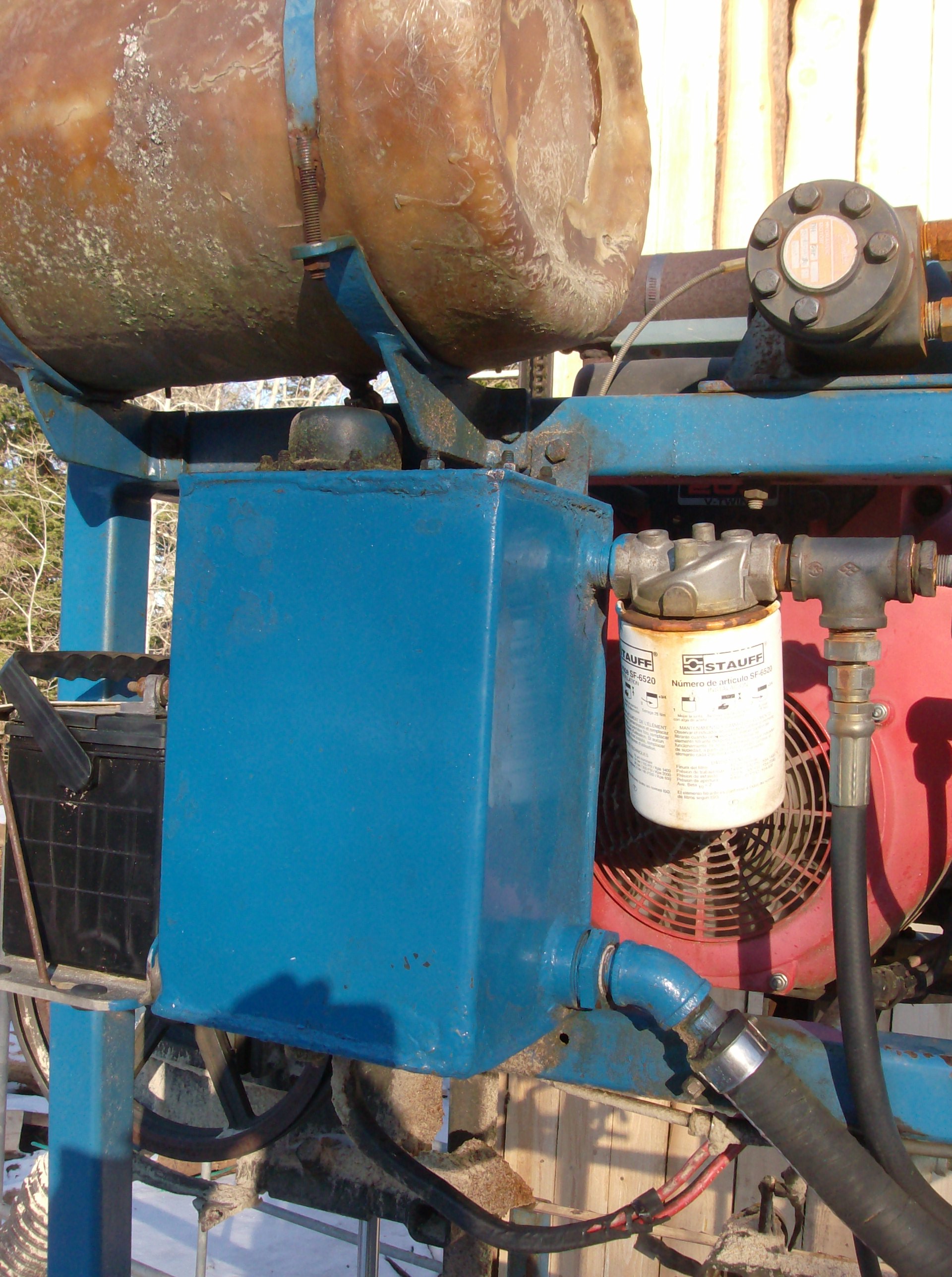

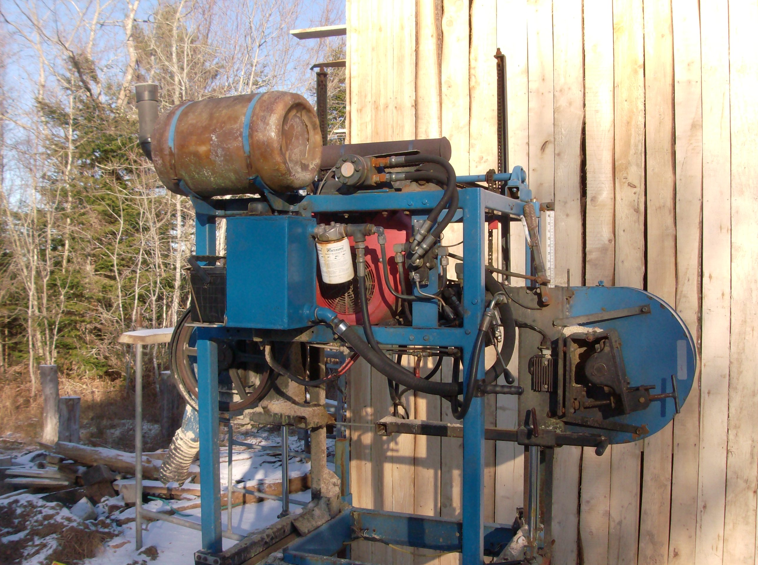

I am a pretty smart guy but when it comes to hydraulics I really know zero.
I have a home made saw mill that I bought . It has hydraulic cut as well blade lift. So this week it was cold out below zero . Saw has sat unused for a month or 2 . Took a boost to get the saw going and then the hydraulics didn't work. The 20 hp honda belt turns a pump which has 2 ccts . One lift and one for run. Neither worked so I thought it was frozen someplace. I popped the tank cap to see the ATF (pink stuff thought the last owner told me that's what he had in there) was pink and all foamy looking. Would have thought the ATF would look like it was pink and clear . I am thinking that It maybe got water in or condensation from the last couple years . Calling for 8 deg C tomorrow and will see if it all works again. If it does I will need to replace the fluid . Any thought ??

I think I would replace the ATF and look for a suction leak, which would make the fluid foamy or entrained air bubbles.
Put a heat gun on the valve and hoses to help the fluid flow until you change it out.

ATF is a very good low temp oil to use. if you have water in the fluid it will turn it light pink and freeze up the hydraulics. this is more than likely your problem. This weekend should be warm enough to get it turning... 20 below is no fun... if it works then drain the oil and replace it, it will take several tries to get all the water out. if you can get some of the oil out of the tank you can do a crackle test for water. Monitor Water-In-Oil with the Visual Crackle Test
for a suction side air leak , this will cause the oil to foam after you use the machine for some time. check all the fillings from the tank to the suction side of the pump, check around the shut off valve on the tank (if you have one) and around the suction filter/screen (if you have one)

So did the crackle test today Failed badly. The water in the ATF just about jumped out of the spoon Blew out all lines . Is there a certain filter that I need to install . Will any filter work?? as long as it will screw on?

There are hyd filters that will remove a little water.
Best thing is to drain and refill.

You should have a drain at the lowest part of the hyd system, and if any water gets in, and not emulsified, you can turn a small valve and drain off the water.
Ones the fluid has been emulsified, you need to replace it, and clean the system. All of the surfaces will be covered.
Also, once the fluid has been emulsified, the mix will develop new compounds, not good for the hyd system.
Looking st your system, it looks like the lowest point of the hyd system is the suction hose, and that is where any free water will collect or freeze.
/ saw mill hydraulics #18
Rasor.. like Jj said, it's best to dump all the oil out you can, replace it with new, then add a water sorb filter, you can get a Stauff sf-6520W filter or any other with water sorb, run it for several hours then replace the filter again with another one. you can use water sorbs all the time if you want.. i think Thursday will be a GREAT day to work on it outside... should be a nice balmy 22 below.... jim
