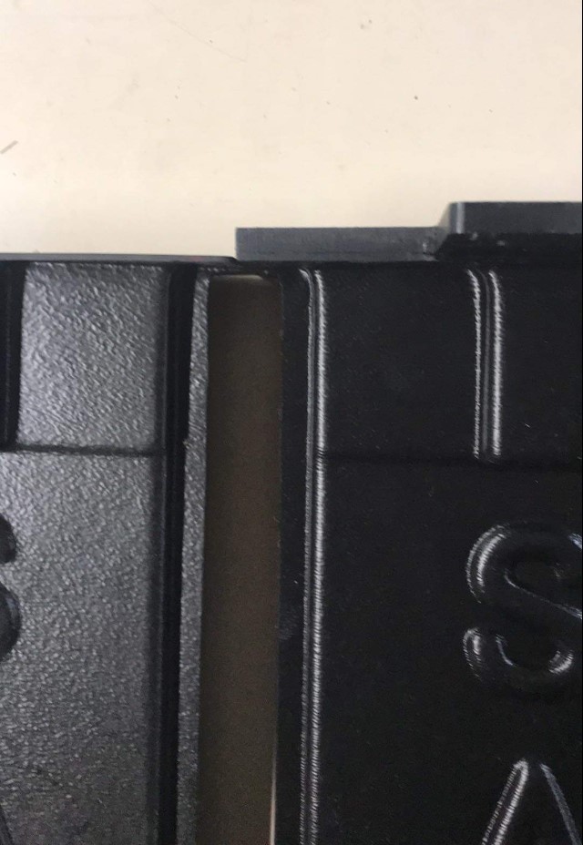

I have a couple SawHauls and the one you have looks like an early version which I also have but another I got recently is the newest version which has a considerably thicker top edge. Like any product, it's constantly evolving and improving. At least they aren't just flooding the market with china crap. They actually listen to their customers and make improvements as needed.
Here's a pic comparing the early version scabbard with the newer one.

The lip on the one in your photo does look a WHOLE lot thicker.....like about 6-8 times the little thin flange on mine, so maybe that will cure the problem. For them to have changed it means they found out exactly what happened to the thin flange like mine. Guess I bought one too early, huh ?

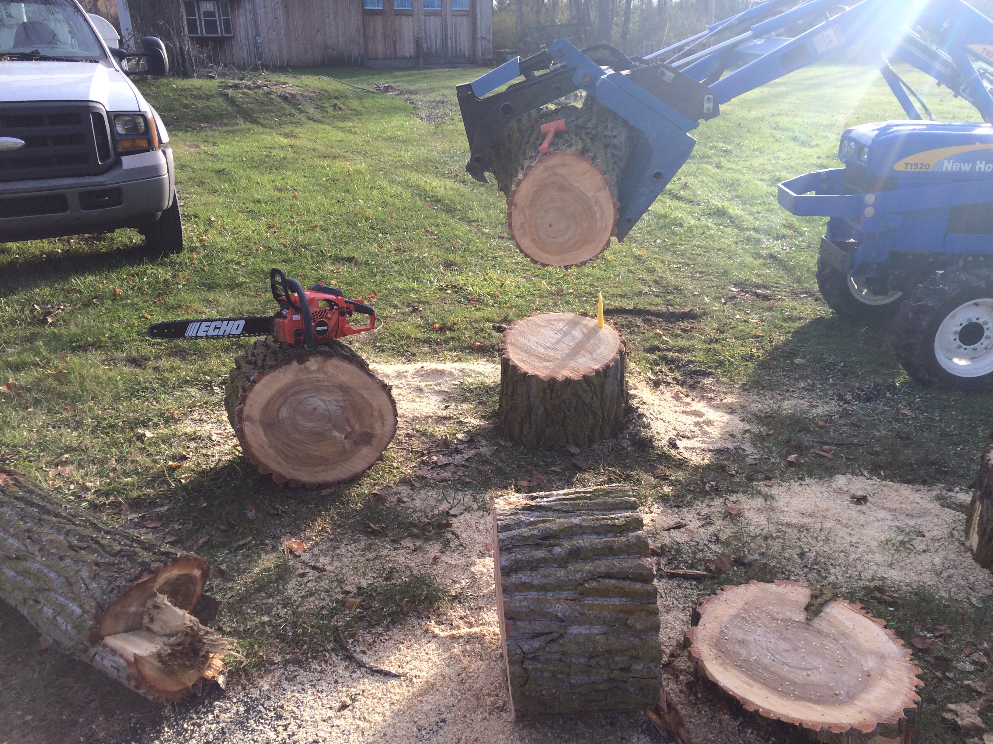

I see right away that handy 18" Poulan Wild Thing And Echo CS400 might be beneath my routine needs.
btw, trying to get straight cuts with chains I sharpen myself ('grind', lol) can be a challenge.
IMG_0335[1].JPG IMG_0338[1].JPG IMG_1174[1].JPG IMG_1175[1].JPG IMG_1419[1].JPG
I wish my 'homeowner' CUTs had room for rake/shovel rack much less for a saw too. They all fit OK in the big Ford as is. :p
