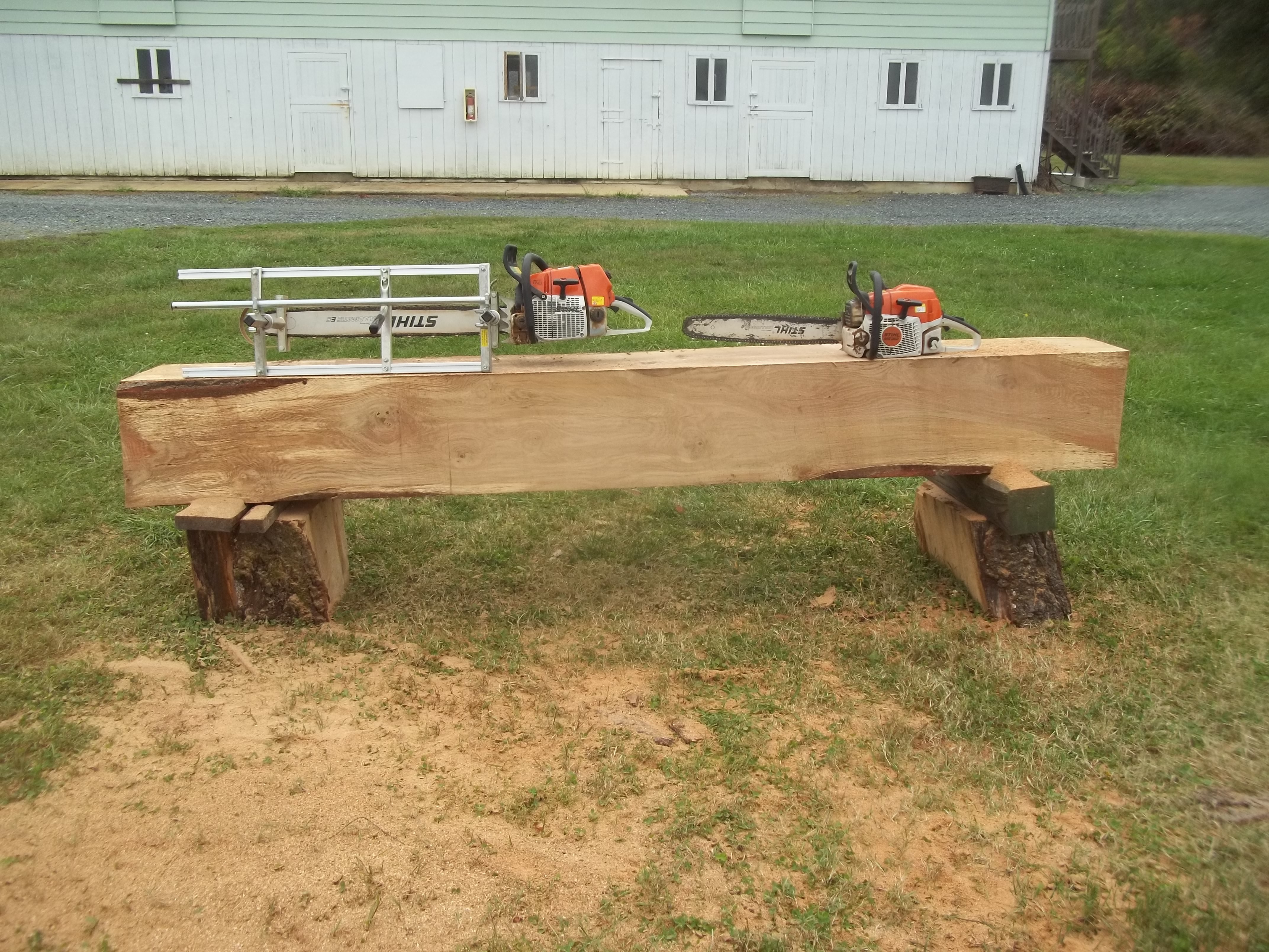

OR, could those picts be older picts??? lol
Here it is today, well not today, as I didn't go out and take a pict. of it today... lol
SR

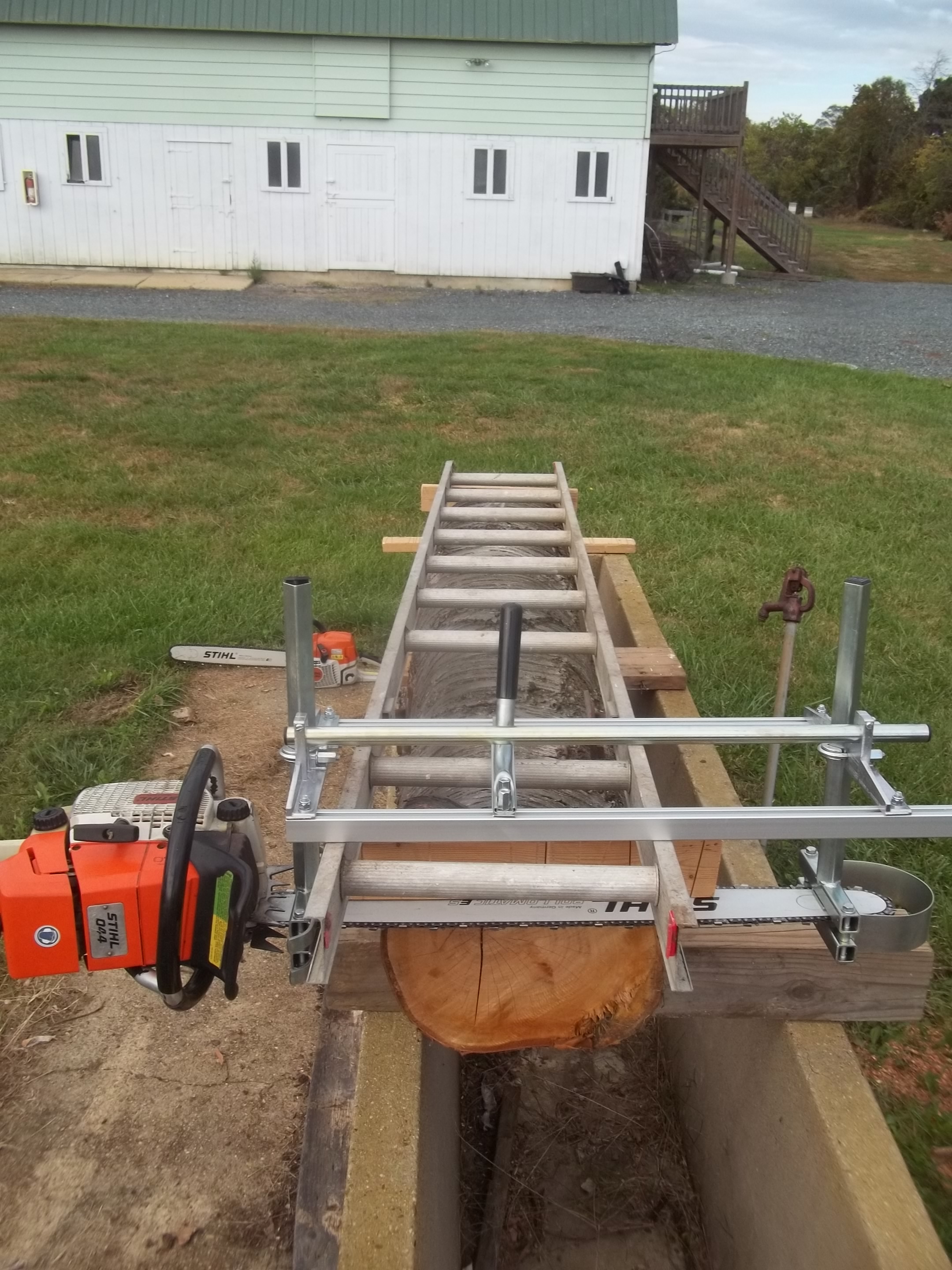

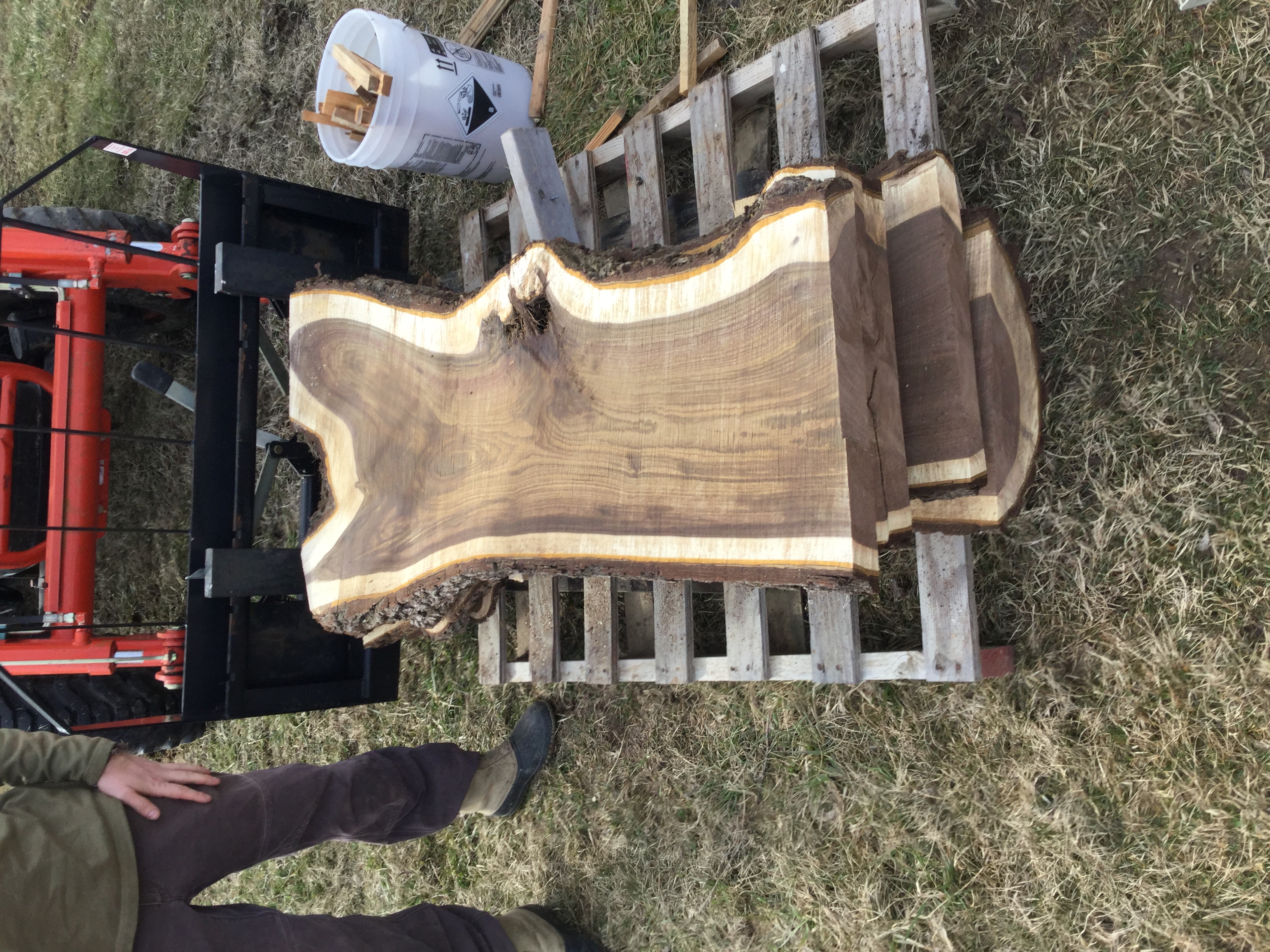

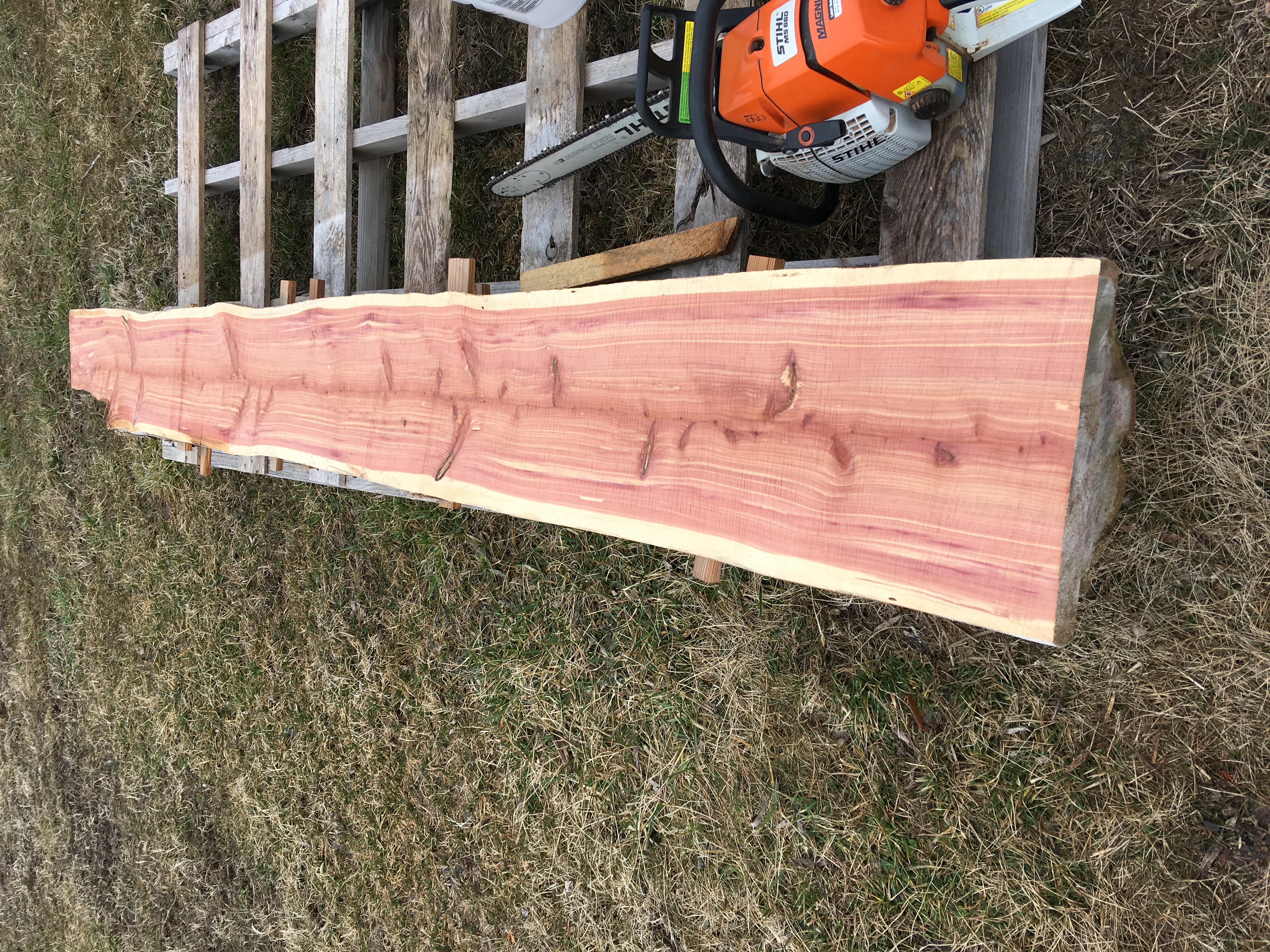

I am late to this party.... This may not be helpful anymore
I have never used a band saw mill. I have done quite a bit of chainsaw milling. When I started I was using a ported Stihl 044 with a 32" bar and ripping chain. ripping chain is no different than any other chain except the top plate is filed to 5* instead of the normal 30* or so. I spent roughly $400 on a 32" Alaskan mill set up and 3 chains. I didn't take me long to upgrade to a Stihl 660 and a 36" bar. The oiler on it has not let me down milling. I also bought 3 more chains and the 36" rails for the Alaskan mill. With the 36" setup i can mill 32-33". I had no trouble selling the 32" setup to someone else who wanted to go bigger on his mill from a 24" set up. As long as the chains are sharp and you don't hit any metal it is not particularly difficult running a mill, granted some woods cedar and pine slab easier than walnut or oak. I use a ladder to do the first cut and then the top of the log from there.
I am not interested in making lumber, I do not often use the slabs I mill. I use the 660 for firewood and the occasional tree job, so I would own it anyway. I enjoy running chainsaws, I am 35 and do not find it heavy or hard to move around. I like that I can throw a drill, some 2x4s a ladder, the mill and saw in the bed of my truck and go just about anywhere and slab wood. I have sold a couple thousand dollars worth of slabs, that has more than paid for the equipment and gas. I also enjoy the work
Here are some pictures for your enjoyment
