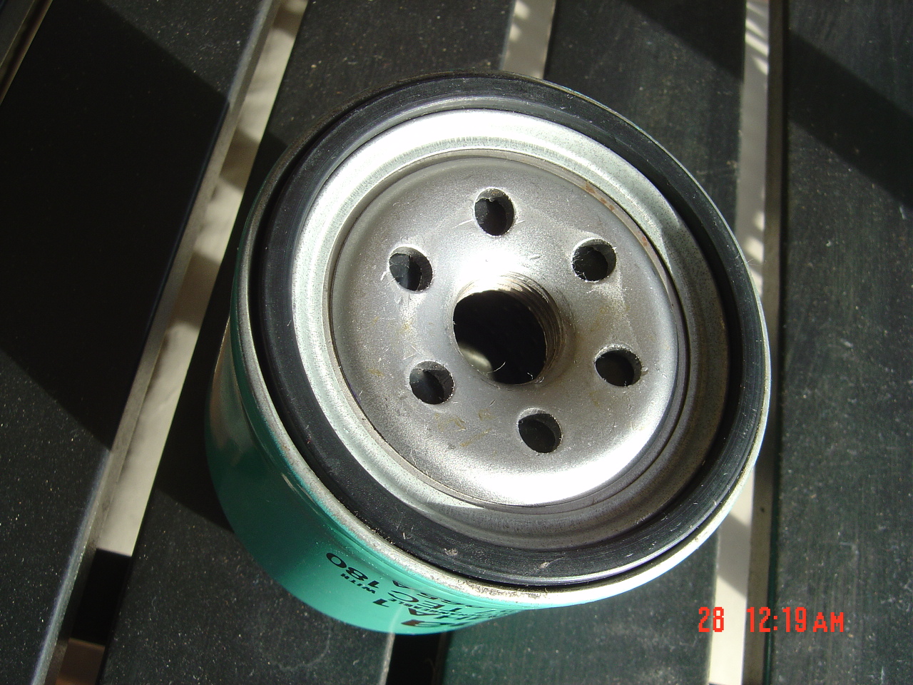

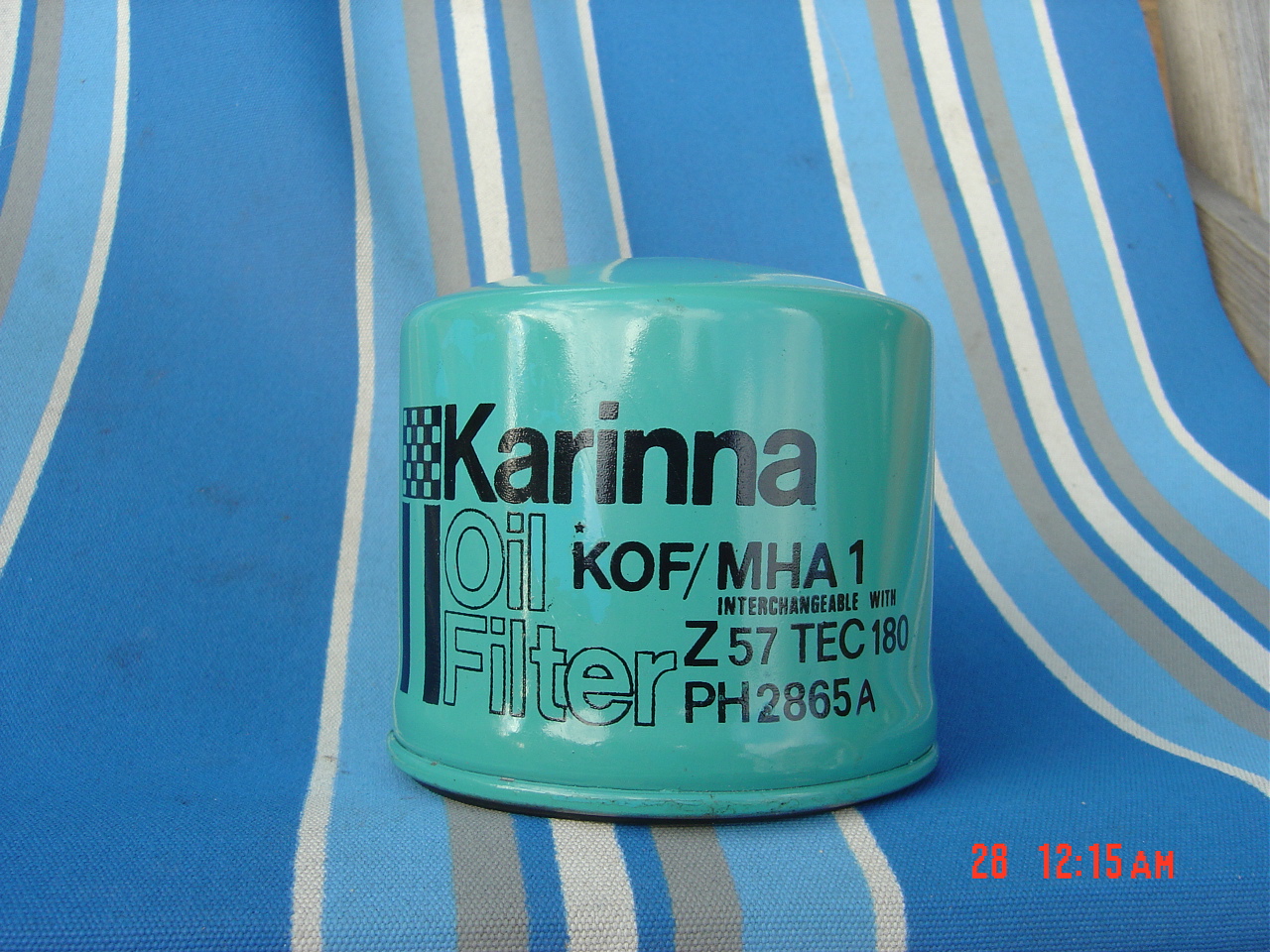

Hi all, and a special thanks to the Moderator/Webmaster who created this site;)
I joined this site to also let WWW know that I have Spin-on OIL FILTERS (EQUAL TO FRAM PH2865A) surplus to my needs to
suit SATOH TRACTOR S550G, S650G with 25hp gas engine .......have been using these filters for over 35 years without 1 issue so know they're "bullet-proof"
I'm located in Melbourne Australia, but happy to send filters worldwide if I can make a dollar profit. Postage Aust-wide is $10; guessing $20 for O/s ?
These filters are $40 from our Repco parts store, but I'm happy to take whatever you reckon's a fair offer:)........up to you.
my email is agrademechanic@hotmail.com
My Westwood Garden Tractor has a single cylinder LOMBARDINI DIESEL for which I'd be happy to trade any parts that suit this 6LD360V (VERTICAL SHAFT) in trade for these filters
For the Technical-minded, these superb "Karinna" Filters have an Anti-Drainback Valve and also a By-Pass Safety Valve(20psi) and its Sealing pad has an OD of 85mm, a Screw thread of M20x1.5, a body-height of 83mm and OD of 91mm
