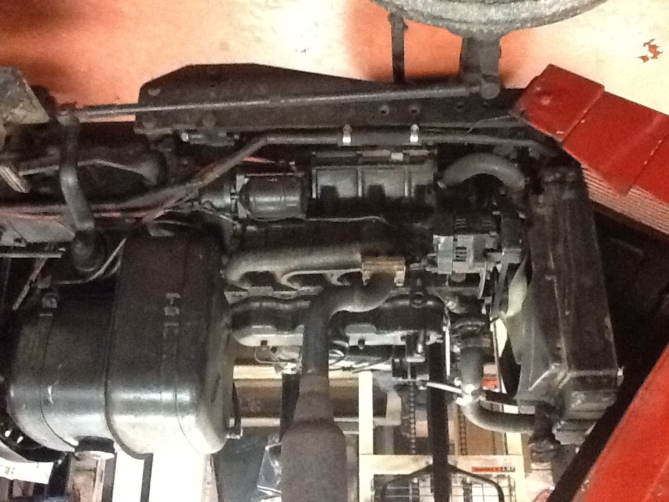

Hey I also have a 650g. I never had much luck with the original engine so I looked for a diesel alternative and found that with a few simple mods and an adaptor plate a kubota v2203 would be perfect. It is 46 hp and runs my 5 foot blower and 6 foot finish mower awesome.a little overkill but when is too much horsepower ever a problem! If you are interested in seeing some pics let me know. I also have a template of the adaptor plate I made.the complete refit took me about 40 hrs.

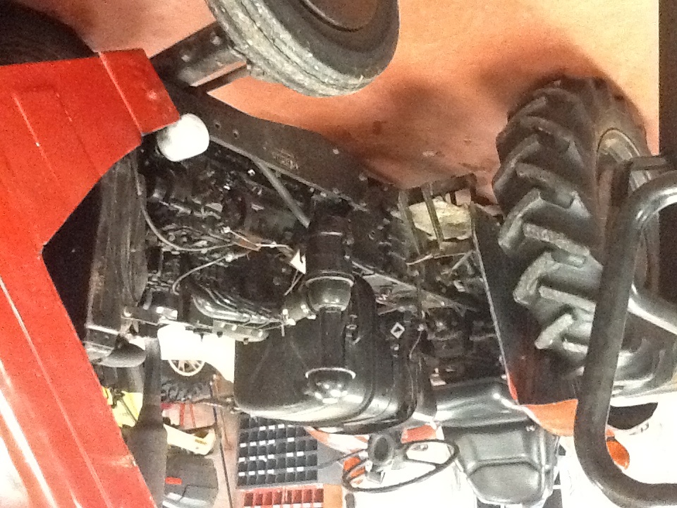

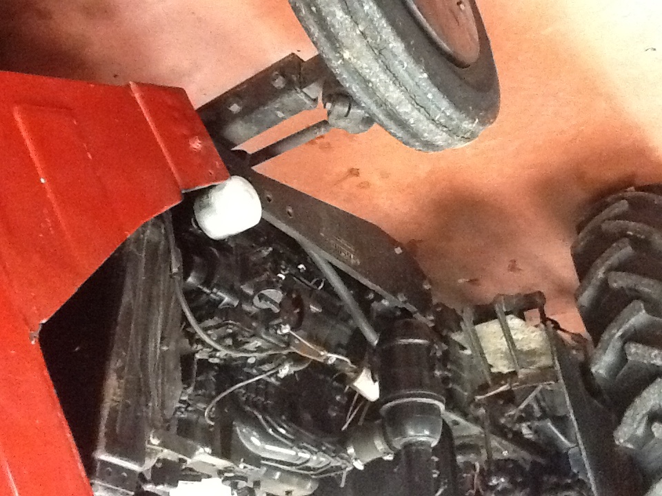

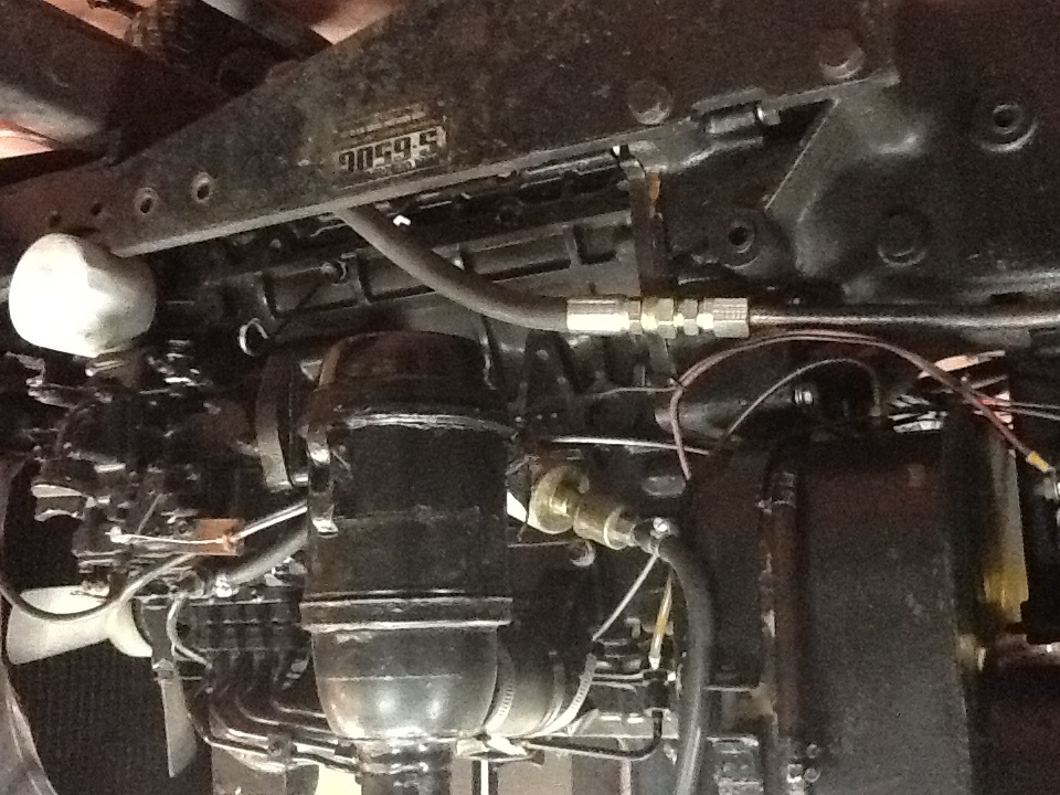

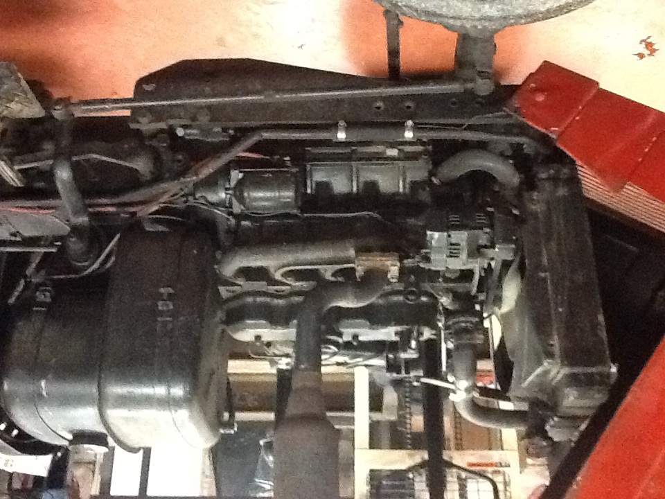

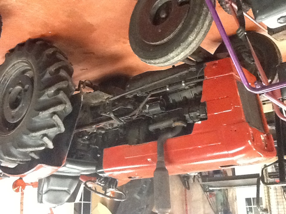

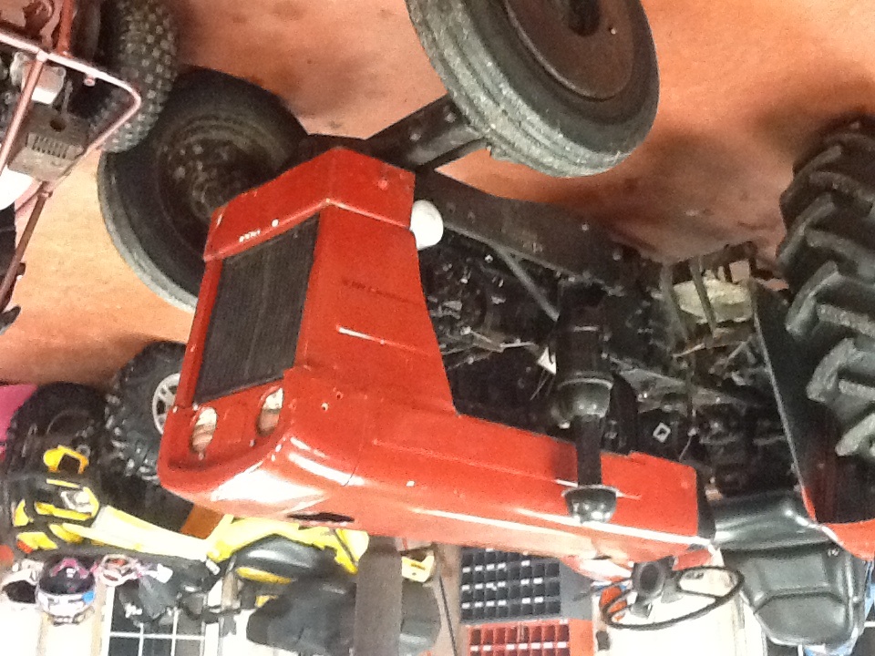

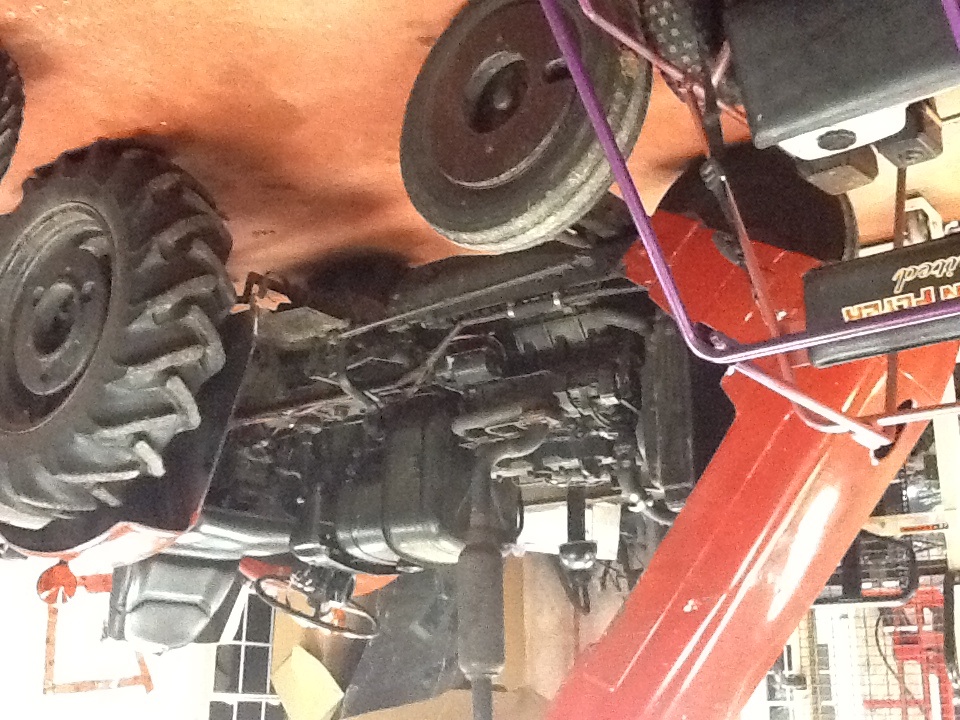

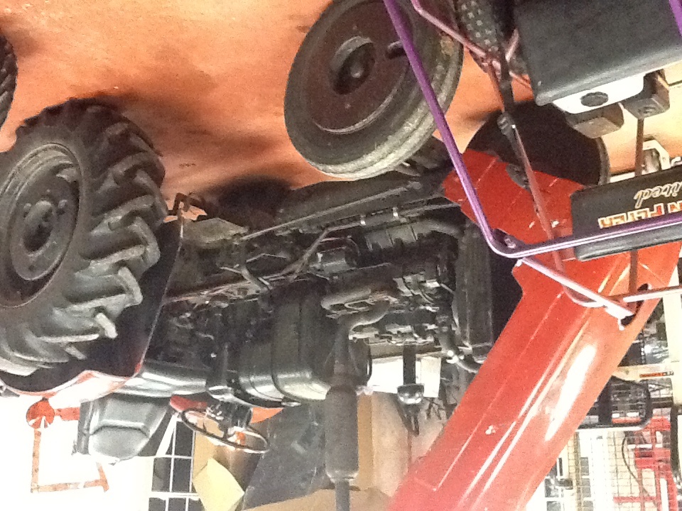

Hey guys sorry about the late response.here are some pics. Engine has been in for two years now and not one problem so far! I can cut a 2 acre lawn all summer on one tank of fuel! This mod really made this little tractor a great workhorse.

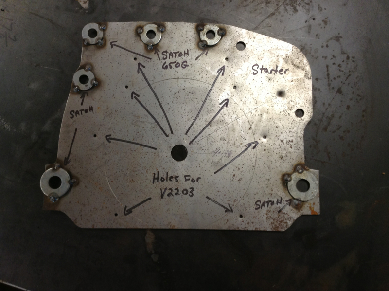

I have begun my Satoh S650G tractor V2203 DI Kubota engine swap the adapter plate is made from 1/2" steel plate.

Back story from Andy W, the adapter plate is confirmed at 1/2", the Satoh S650G flywheel is re-drilled to fit the V2203, radiator gets moved forward, the hydraulic lines extended, a love joy coupling replaces the OEM hydraulic pump coupling.
The holes in the adapter plate drilled behind the Kubota flywheel must be countersunk in order for the bolt heads to clear the flywheel.
The Bendix gear from the Satoh is removed then welded somehow onto the Kubota starter bendix.
From my own observations the Satoh flywheel measures 9 3/4" while the Kubota is a whole inch larger and will not fit inside the bell housing.
You have to split the tractor in order to remove the engine.

I destroyed the engine block as I was only after the rear portion having the bolt pattern, using transfer punches to mark the hole locations onto my half inch thick steel plate.
A metal plug gets turned on the metal lathe to fit where the crankshaft used to reside, a half inch hole drilled dead center will help locate the crank center on my steel plate.

The original fellow ground some of the ribs from the Kubota engine to make room for the starter, I'm going to instead cant the engine a few degrees to the right to allow for the necessary clearance.

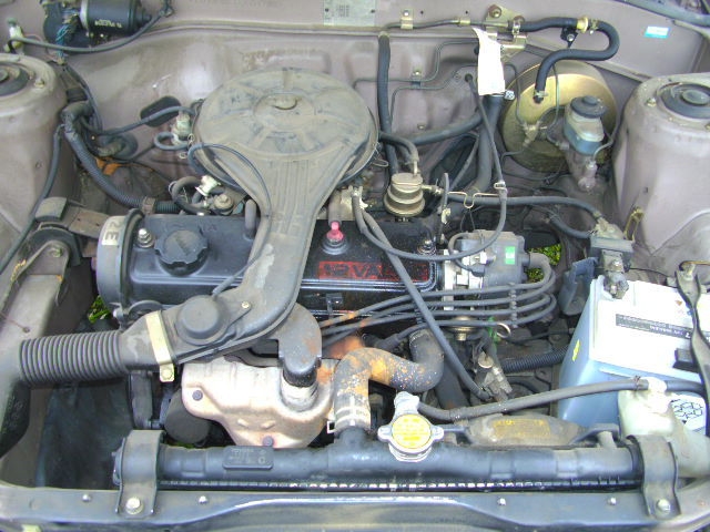

I am seriously considering swapping the engine and I would like to gather some opinion on adapting a carburated 18 L Toyota 7A Engine as that is all we can find here...
RustyDollar, I truly appreciate the pictures and details you provided, and I was wondering if you could provide more picture of the tractor gearbox/clutch and on how you will attach the new engine to the old gearbox.
Much appreciated. Thanks
/ satoh S650G engine changeablility ? #20
Pictures of the 1.6 litres Toyota 4A engine and the 1.3 litres Toyota 4E engine, they both have a 200m flywheel, so they should fit, but I wonder how the satoh clutch would work with this... thanks in advance for your responses. 4AE Carubator Engine.jpgToyota_2E_engine.jpg4AE Carubator Engine.jpgToyota_2E_engine.jpg
