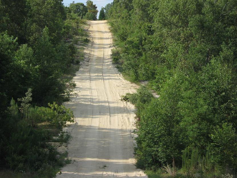

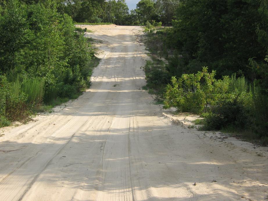

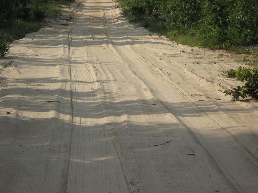

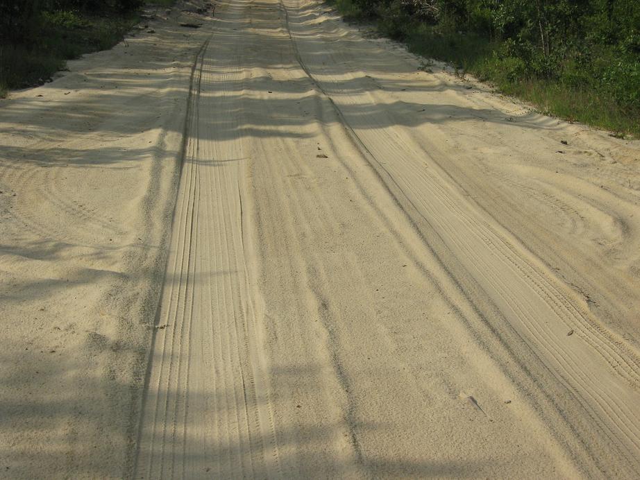

I could use a little help with my driveway/private road.
I have purchased a 5 ac. flag lot and own the road to which 2 neighbors have an easement. The road is what I can only describe as a beach. My road consists of the same type of sand like you would find on a beach. The road works great for a few days after it rains, but turns to fluff afterward.
My father may possibly be able to get a hold of some Sakrete from his previous employer. I found a .pdf file online that gives an equation to show how much portland cement to add to sand for strengthening my road. I know its not portland but if I add enough I would think it would hold up better than whats there. The bags hold 3000 lbs of Sakrete, a piece.
1. Has anyone ever used Sakrete or cement to ad structure to a very sandy road/drive or make a patio using this concept.
2. How do you think it would hold up under normal auto/pickup traffic?
3. How/What would be the best way to mix the mixture into the sand at say a 5-6" depth?
4. The potential bags my father would be able to get are in 3000 lbs. bags, what would be the easiest way to move /spread the concrete mix onto the road?
5. How would I be able to tamp/compact around 1000 ft of sandy road?
As usual, money is a concern, I have a Kubota b8200 with a 5ft scrape blade. My neighbor has a Mitsubishi 18hp tractor with a small FEL. I have access to a set of harrows and my neighbor has access to a 3pt. rototiller. The road is about a 1/4 mile but the main part is around 900-1000 ft of sand. If I can get enough Sakrete, I proposed to my neighbor that we can do my road first, then do his road. Labor is of no concern, but need some ideas on how to get this done and if you think it is feasible(will it work)?
I attached some pics of the drive. It doesn't look too bad now because it rained last night, but give a day or so and it will be like driving on a beach.
If you need more information, please let me know I will gladly take any and all advise.
Thanks in advance for any ideas,
Tread

When you say Sakrete, I think of concrete mix, not cement, but is it cement? And is it really in 3000 lb bags? What does that look like? How do they move them?
Any way, what I might try is to do is spread it as evenly as possible. If they bags are really large and on a big flatbed , you can slit them and drive back and forth to until empty and then finish up spreading with your two tractors as best you can.
I would then roto till the cement into the sand. If it as soft as you say it is a walk behind tiller would work, but obviously the pto one would be better. Make sure you clean up the tiller good after.
I would then grade the road to what you want and then put a sprinkler on it for a bit and then roll it with a big roller. Renting a plate compactor or even a small "steam" roller probably won't be too bad.
Obviously you want to stay off the driveway for a few days after because you don't want permanent ruts.

Unless they are giving you the concrete at an awesome price you might be better off buying straight cement as you already have the sand. I suppose a load of gravel gate spread wouldn't hurt, but it sounds like you have stuck issues so the your FEL's will get a workout. These 3000 lb bags sound crazy. You will have to break them apart at the entrance and spread them too I suppose.

Well if it is free and you can get it to your place easy enough and it isn't going to rain for a few days, go for it. Even if it breaks up and ruts it will still give you a better base than what you have now.
/ Sandy Drive project #7
3,000 punds of concrete isn't very much. Off the top of my head, I'd guess that a yard of concrete is going to weigh about that much, give or take a few hundered pounds. A yard will give you a 4 inch pad, 9 feet wide and 27 feet long. You can do the math and figure out how wide you want the road, but 4 inches is going to be the minimum for automotive traffic. You will also need rebar at least every two feet in a grid to hold it all together.
How far do you want to go?
Just mixing in the sacrete with the sand will do something, but I doubt it will be worth the expense or effort. If it isn't mixed properly and reinforced with rebar, it will crack, crumble and just fall apart on you.

May have to do a section at a time. Spread the mix out evenly over the road, then run a disc over it to mix it with the top few inches of sand. Hopefully vehicle travel will compact it into a hard surface, but it will take some time for that to happen. The best thing to do would be tons of rock but I can't afford that for my road either.
I filled a couple large mud holes in my drive with crushed concrete (set up cement that had been crushed back into small cement rocks and sand.) then bladed what was left over a short section of the road. For the first couple rains I did not think it was going to work, but when it dried out it got very hard, just from the compaction of normal vehicle travel. Water does not penetrate the surface very deep anymore. The worst part of it was the grime that got on our vehicles had to be hand washed off until it was packed in.

if you mix the cement with the sand be sure to do it in a dry period. If it rains the cement will flow down leaving an almost non cemented top layer.
So in any case this is a dry period project.
If you are going the pour-on-top-then-till way i would soak the sand with water before putting the mix on top and then right away till it and leave it alone to dry. Add water to get a semi-wet mix, not a dry-mix and not as liquid as concrete.
Another possibility, but much more work, and what i would do:
take off a top layer, flatten the remaining path as you did in the pictures and then mix the taken off top layer material with your cement mix in a semi-wet mix using a concrete mixer and spread that one out and level it.
you'll need one **** of a mixer for that surface and basically a tractor with tiller can be seen as a mobile mixer driving over the ingredients.

I don't know jack about road building, other than a couple of interesting conversations that I had with a guy who built roads for living. As he said, it is all about the base. I wonder if what you have is even firm enough to consider laying concrete over. The road may have to be built up to last.
Also, you said it is just for street vehicles. Well, that won't happen... It may be as simple as a bed delivery, or as complex as a Dozer or a steel building, but a heavy truck will go on your driveway and if the bed is not deep enough, I would think you would have problems...
I mean you could put the concrete down, and see how it does. I just would not want to be around if it fails and you have to pull it up.

I believe that I would do a small test strip first before committing to the larger project.
Not to deviate to much, but.
Another idea, but cost money. Two strips of cement with wire or rebar, 6 in deep, 2 ft wide, 1000 ft long, separated by the avg width of car tires.
One yard of cement at 6 in deep two ft wide, will give a cement strip of 27 ft , times the price of cement. Plus the cost of wire/rebar.
Cost per 1000 ft strip around $5000, for a total of $10,000.
Maybe have a road that last 20 or thirty years.
This could be done in small strips, as money and time permits.

Our road isn't as bad as yours, but that's pretty normal out here. Your idea of mixing in the sacrete (as I understand it, not to make a slab, but to "stiffen" will work). We use clay soil to do the same - its cheaper if you don't have access like you do, but I don't see why the sacrete won't work, we've done cement mixed with sand for potholes. And it adds some gravel which is nice.
You can spread e3verything with the FELs, though it might take a while. Landscape rake would help too.
But its a doable project - you are in pretty much the same situation as half the roads up here like I said.
Oh, one other thought though I've not seen it done is geotextiles

Like was said... you need a base to place the surface on... do you not have limestone or any other cheap base rock in your area?
What dose the county or state use for their road work?
I use to build and maintain my road way around my business and all the neighbor hood for 20 years .. you must have a solid base to support any traffic, a thousand feet is not that much road way to build.
Trying to get the top layer to stick together with nothing under it is going to cause a lot of work correcting things in the future... that blow sand you have is only good for getting stuck in ...
Do you have access to blacktop millings or crushed concrete? Anything to place larger chunks under your roadway...KennyV.
