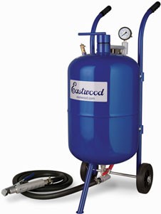

I bought a new sand blaster today. What an improvement. Its the style that has a 15 gallon tank that is pressurized. The old one I had was a Craftsman that had a container about the size of a briefcase where the sand was siphoned from it and it never did work very well.
I noticed it said with the new blaster not to use sand. I had some sand laying around and went ahead and used it, but I used a dust mask, and then a respirator because the dust mask kept fogging up the lense of the sand blast hood.
What are people using for blasting media? It says something about iron oxide, where can you buy that at? Does it work as well as sand? Are people still using sand and just being carefull?

I have never used sand. I think the primary concern is the threat of silicosis. I use Black Beauty, a slag product which comes in different grades. I have also used walnut shells when blasting softer materials where I didn't want to create a rough, pitted surface. I think sand may also be more susceptible to clumping from moisture.

I spent a few years sand blasting for an industrial precast concrete company. Silicosis is a danger but only if you inhale the dust. With the proper PPE the problem is eliminated. However any abrasive high velocity particle will wear out your nozzle in time. Sand is by far the cheapest material to use but as mentioned above it will wear nozzles out faster because it's the most effective.

I bought it at a local farm supply store called Farm King. It was a little less than 200 bucks. This is a picture of it, its a different color and has a different name on it but it is the identical unit. It works well.

silica sand also will leave a residue the will not take paint as well as a regular sand blasted surface. the silica lets the paint flake off after a while. black beauty is great stuff also available is glass beads many different types of materials work though.

That does seem too expensive. Haven't picked any up in a while but it's a waste by-product from the steel making process, ground slag. Used to get it for $6 for 50 lbs. couple of years ago. Shop around...

Was $8 now more like $20 now. I used to be able to buy from 3 different suppliers. Nobody is handling the "black slag" now. The company has gone to selling full semi loads to the people I had been using. To much inventory and dollars tied up.
/ Sand blasting #16
The Black Diamond brand blasting material is $8 for 50 lbs at TSC or NT.
