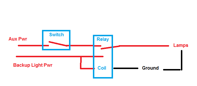

For better visibility and safety at night, I'm going to add two LED flood lights to the top of the rear of our horse trailer, powered from the trailer battery and with a nearby switch. It would be nice if these lights also came on when backing up. So the lights would have to be wired to both the auxiliary and the backup circuits. So far so good, but I'm thinking I would want to add a couple of diodes, just before the wires from the two circuits come together. Would this work?
/ Same lights for backup and flood? #2
Diode would be needed to keep from back feeding the reverse lights. You could wire switch from trailer battery then use a heavier diode current wise than light draw coming from reverse light trigger which I would use a relay. Of course, put a fuse in there just in case. Great project!

/ Same lights for backup and flood? #7
Wire the lamps to the wiper of an SPDT relay. Wire a switch to the NC contact of the relay. Wire the backup light circuit to the coil and NO contact of the relay.
Normal Operation (NOT In reverse).
Relay de-energized. Switch turned on, power flows through switch and NC relay contact to lamp.
BackUp Operation (in Reverse)
Relay energized by the backup circuit, pulling the wiper to close the NO contact, allowing power to flow to the lamps.

/ Same lights for backup and flood? #8
post 7 will not work for you, you want "extra" reverse lights - reason for relay. You want manual on/off control of "extra" lights.
hope this video and my comments help.
Relay Wiring Diagram - Bing video
terminal 86 is wired to backup light.
run extra wires from 30 and 87 for your toggle switch
